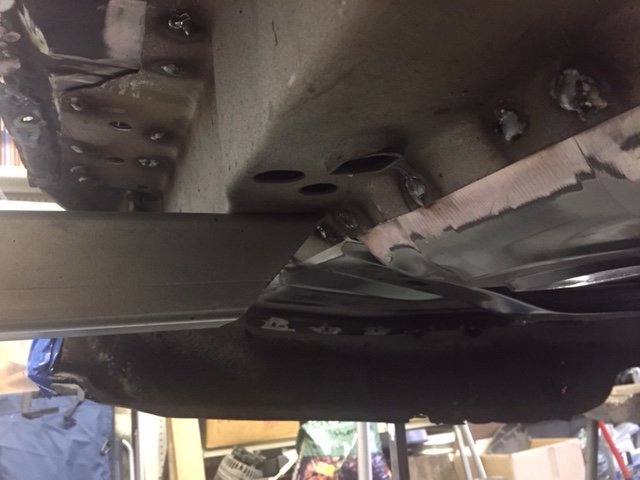

Those are plug welds done in the same spots as the factory spot welds, the cross rail bracket and the kick up from the trunk floor to the tail light panel came from an Arizona car (had rust issues). I used the drilled out spot weld holes to help with the alignment. Once its up on the rotisserie I would like to put some stitch welds on the seam, but it's strong in that respect. I made some extra supports today that are under the tail light panel, bolted thru the bumper mounts and welded to the rotisserie arms, seems to make a big difference, no flexing. Of course as I went to mount the front I found the passenger's side firewall mount had a good bit of rust on the bottom of the inside mount hole so as it's this far apart I can't see not fixing it properly.… as the saying goes "are we having fun yet??" -

Got my rear floor and trunk floor in and now going to put it up on the rotisserie. When I bolted up the rear supports to the rear body to frame mount bolt I felt their was not enough support and as I pulled up on the support arm it started to flex the rear brace that runs between the trunk floor extensions and welds to the floor and tail light panel. I see this done all the time on chevelles and their seems to be no problem....what did you guys do?? Bumper mount holes??
might be too late to help you on the trunk floor, but I'm just finishing up mine. Buying it in pieces cost a lot more in time and money because you also have to buy all the braces, and there are 5 of them, L/R floor braces, L/R tank mounts and the front cross brace that goes between the wheel wells. The complete floor comes with all the braces already installed. They don't make a complete trunk floor for a Monte, you have to use a chevelle piece. What I did was buy the chevelle floor, which goes from the top of the under rear seat floor all the way to the base of the tail light panel. The problem is that where the rear of the floor kicks up tp meet the tail light panel the shape is different....all A body floors are the same until you get to that area, they are all different because of the different shape of the tail light panels. I bought the part that goes from the bottom of the trunk Floor up to the tail light panel from a parts yard out west. they sold me that part and the rear floor brace for $175 shipped. Took the body off the frame, blocked it up, cut out the main sections of the floor and then spent a lot of time drilling out spot welds. I got a GoodMark piece and it fit very well...It's a big job but not complicated, I had never done one before, did it by myself and it came out very good.
