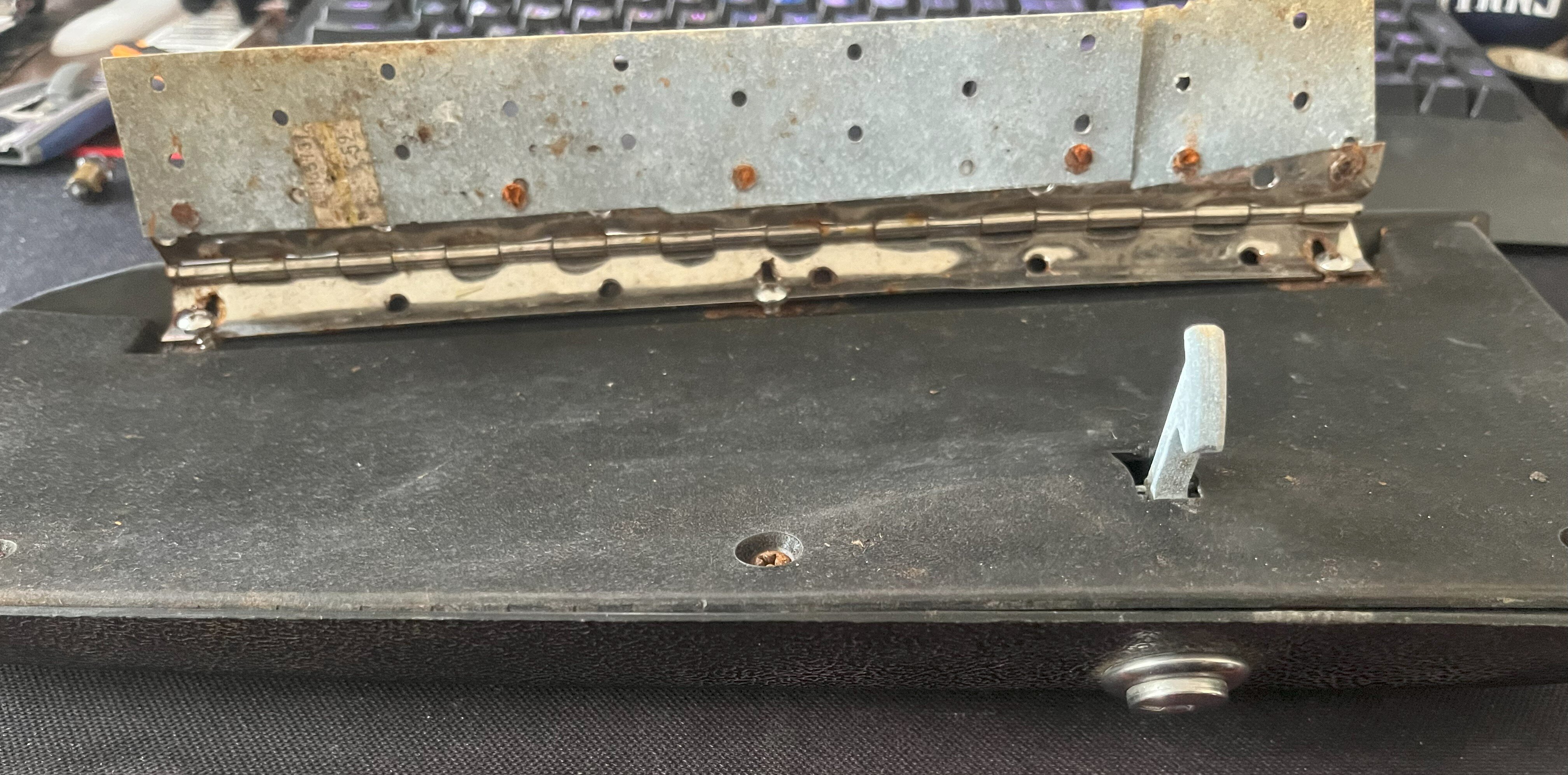

959 profile views

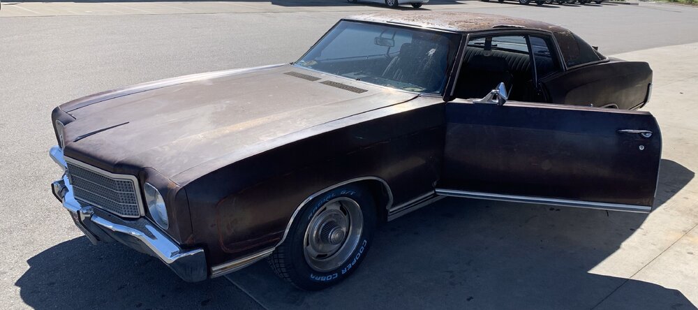

  2. This is my '70 Black Cherry in progress. It's has the patina, that's for sure, but it's now running and it's an original Black Cherry (code 78) with a Black vinyl (early '70 halo) top, Buckets, Console and Power Windows. Second place is the '72 Mohave Gold (code 63), just beautiful with it's shading and glow.

  14. I would, after removing the old one, place the new one on and check for fit and alignment, tape it in place really tight, flip it over and get a soldering iron with an old tip and then carefully touch the protruding tips to melt them, creating a mushroom of plastic that should not only hold but look close to original. Of course you won't see it once you re-install the internal cover but the satisfaction is high !
