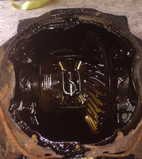

  19. This is a 8.5 gm 10 bolt. It has bolt in axles. I do not know what it came out of. Look closely at the lower shock mount studs. They are faced forward. They are also on the inside edge of the lower trailing bars. As opposed to the otter side nearer to the tire. Does anyone know what it may have come out off?
  20. Dave Thanks It's not that I don't like the rear. I do prefer bolt in axle want to change the rear gears even if that means changing the carrier. I just can't be sure what to order. Everything I read says a 8.2 carrier and ring gear but there's the rack it has a 1 1/4 inch pinion nut it also has left hand threads on the ring gear. And the housing has the lugs on the bottom at the 5 and 7 o'clock position My rear is the bolt in axles. The1971-'72 Buick GS/Skylark and Olds Cutlass A-body 8.5 10 bolt did not have C-clip axles. The non C-clip 8.5" 10 bolt, type "C" rearend was used in some 1969-'72 Pontiac GP and 1970-'72 Monte Carlo. There have been non C-clip rearends found in Chevelle wagons, and some El Caminos through at least 1974.
  21. Please see photos This rear has a pinion nut size 1.25 It also has left hand thread ring gear bolts Although I don't have a picture of the rear cover it does have the scallops at the 3amd 9 position
  22. Yes it does have the half moons on the rear cover. As I have been reading all I see is the 8.2 ring gear. But mine has all the identification of a 8.5 ring gear size. Do you know if they came with a 8.5 ring gear?
  23. Do the casting numbers on carrier indicate anything
  24. It is a BOP rear with 28 spline axles 1 1/4 pinion nut Left hand thread ring gear bolts Edge of tooth to edge of tooth ring gear measure 8.5 Can't find info anywhere that there was a 8.5 BOP rear
