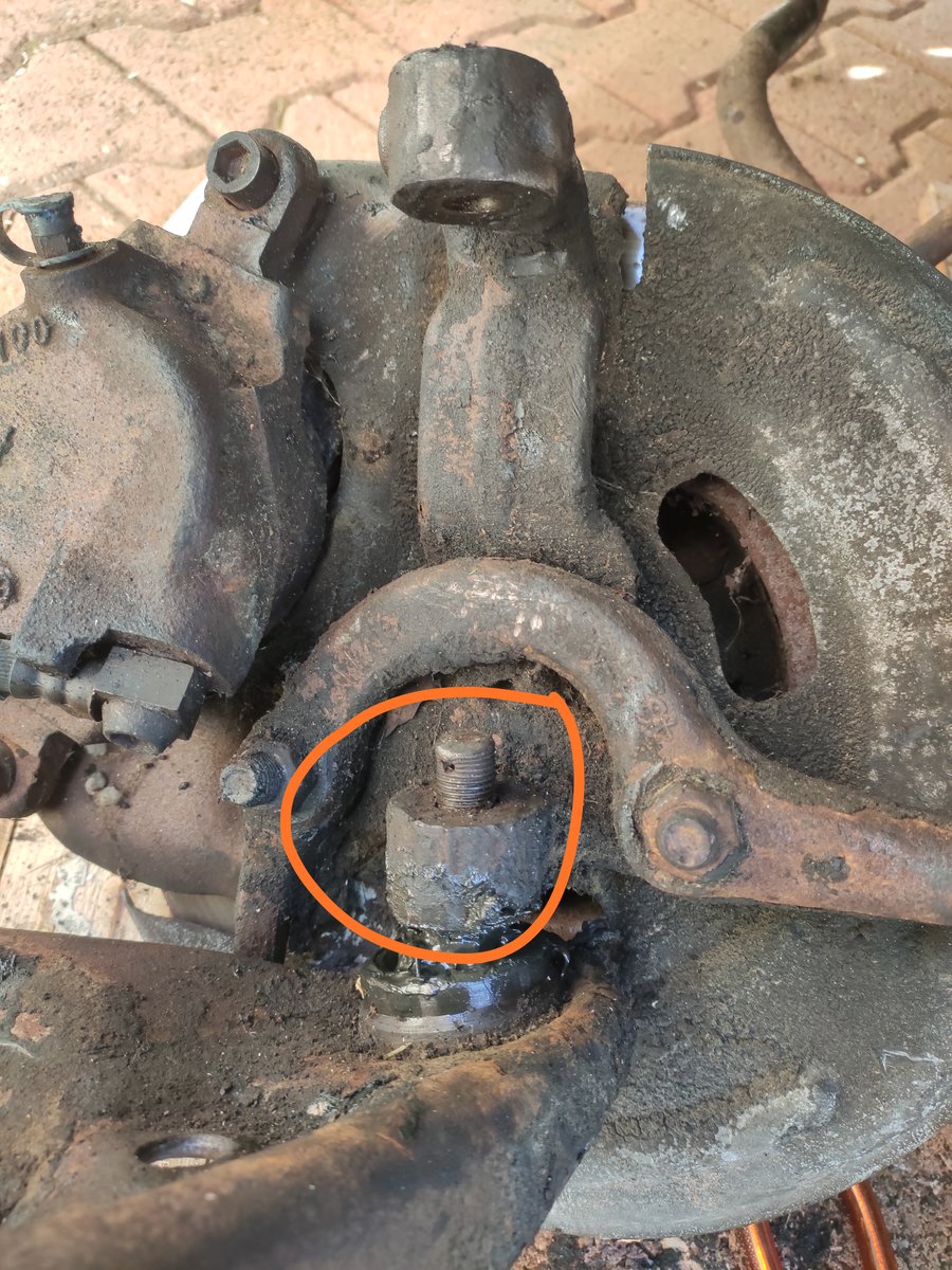

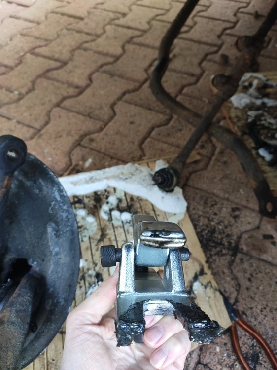

  3. Thank you for your advices! Victory! I sprayed penetrating oil on the top of the ball joint, and then pressed it out with success. My chinese tool didn't like it very much... Now it's bushing time!
  4. Unfortunately I don't have a fork and because of confinement, everything is closed out there. I'm just afraid to wrap or bend the knuckle if I hit it too hard. What are your thought?
  5. Actually I used that tool without success Here is the stuck ball joint. I'll try to soak it with penetrating oil. Also I can try to heat it up as I have removed the boot and most of the grease.
  6. I'm in the process of replacing all bushings and ball joints on the front control arms. Lower ball joint is stuck in the spindle. I tried hammering it, and then I bought a ball joint removal tool and it did not move at all. I have a 12tons shop press, but I'm afraid to break or bend the spindle if I use the press. Any advice on how to remove it? Thank you
