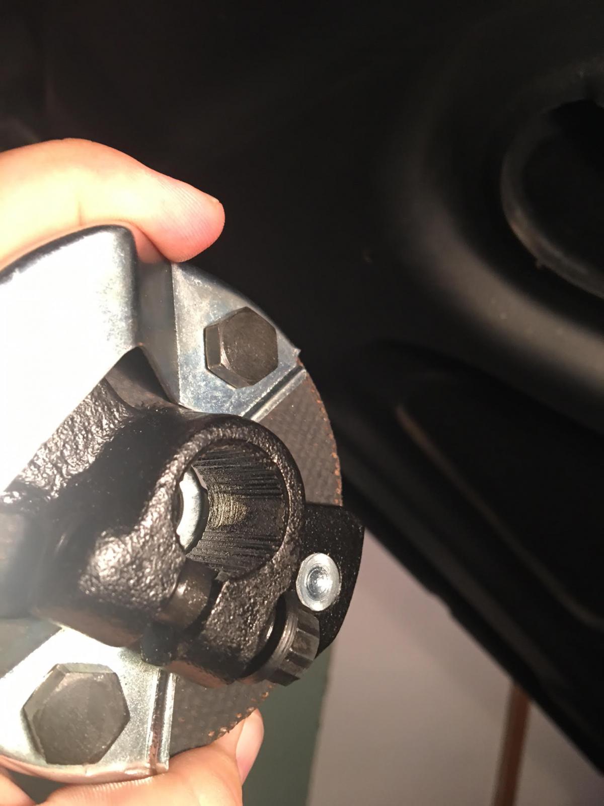

  3. Good Idea Larry. I ordered it through Don's East Coast Restoration. Phone number is 631-226-7982. Their part number was 16-051CA The box that it came in though had "Coupler 202" on it and looked very much like the box I got from Advanced Auto the first time around which was a Lares product. I looked it up and Lares does have a 202 Coupler. It was cheaper to order though Don's anyway, so I would go that route. I am attaching a picture of the coupler I received.

  5. The rag joint came as promised and it is EXACTLY what I needed! Hopefully this post might help someone in the future who may come across this same issue.

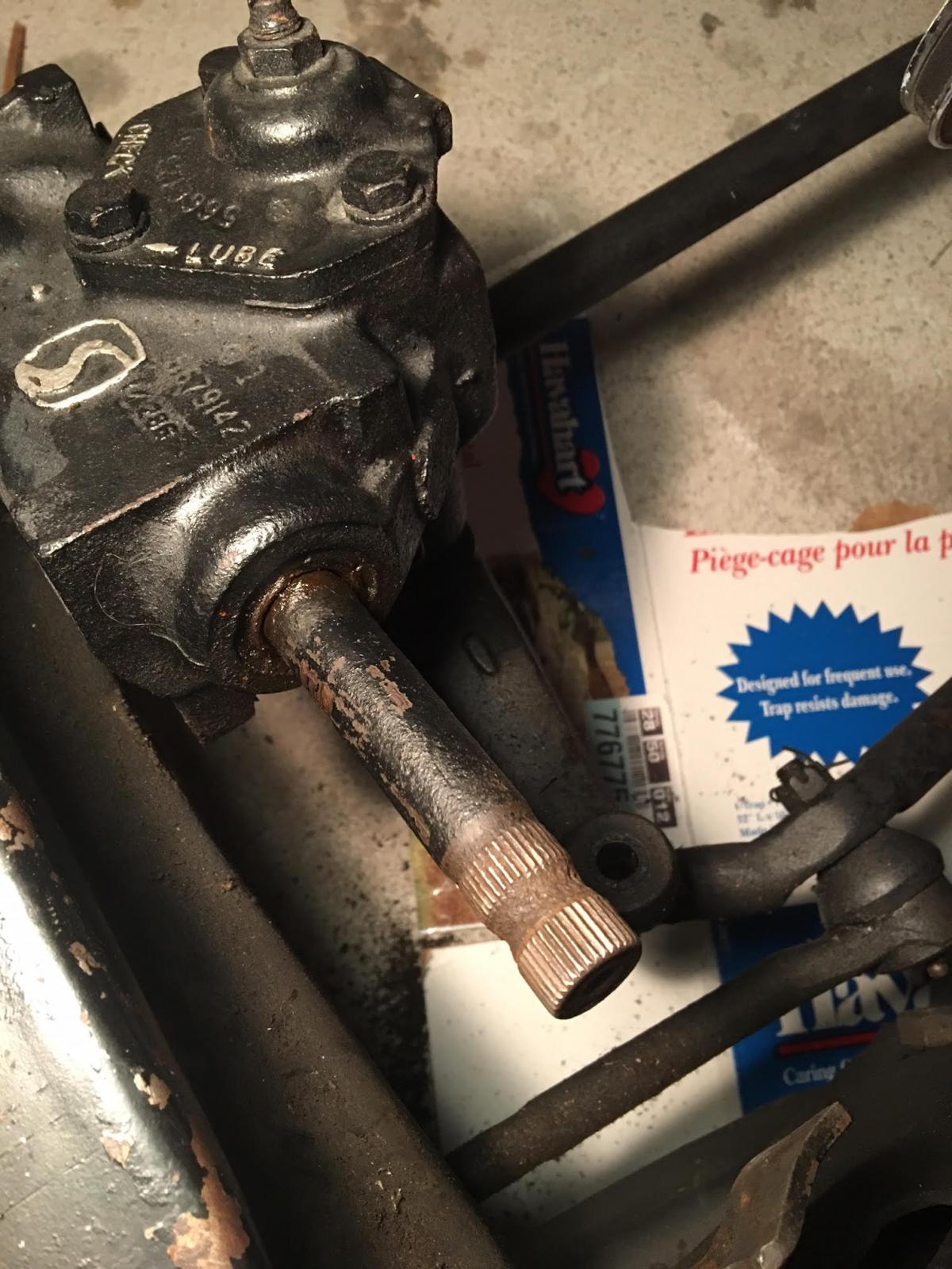

  9. Hey guys, The rubber rag joint finally gave up the ghost a few weeks ago. I counted the splines on my input shaft and measured the diameter. Its a 3/4" 36 Spline input shaft. The box is a manual steering box. Car was originally power steering. I dont think it matters that much because when I switched it out 15 years ago, the manual box came with the rag joint that fits it (I purchased the box and joint used). I ordered several replacements and so far all of the rag joints have had flat spot ground into them for alignment purposes. My input shaft is splined completely around the diameter of the input shaft with no flat spot ground in. I got another one in the mail from JEGS today and still, this one has a flat spot ground into the splines which will not allow it to slip onto my input shaft. I am attaching pictures. I would reuse my original rag joint pieces and just get a rebuild kit for the bushing but the splines are worn out on the original rag joint piece. If anyone can help me in this, I would be grateful! The car has been torn apart too long! (In the third picture, I found this on another website. My input shaft is the one that says "fully splined") Thanks! Steve
