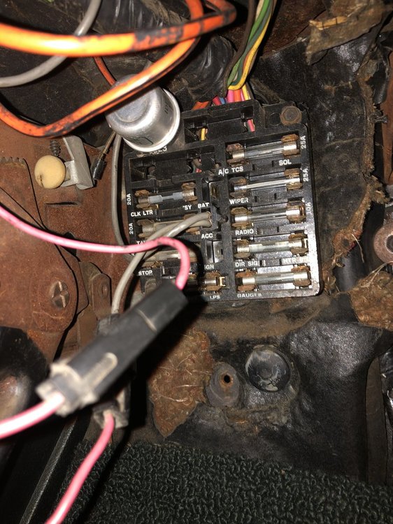

  13. Yup! It was for the clock. Although the clock doesn’t work but at least that mystery is solved. Sorry to keep asking questions but not sure what this is either. Only gray wire in the wiring diagram is for the panel lamps and I don’t see it splitting. In the pic two gray wires come from the Acc slot in the panel and then one goes up perhaps to the dash lights. The second goes into a weird connector extension/converter where it turns to a red wire.
  14. Red you beat me to it. Any idea about the singe orange wire? If you need a better picture let me know. It is not an easy spot to get to. I traced it up into the main wiring harness where it heads back towards to driver's side and then dips back towards the fuse block (I believe).
