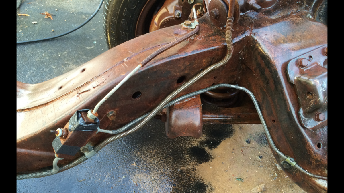

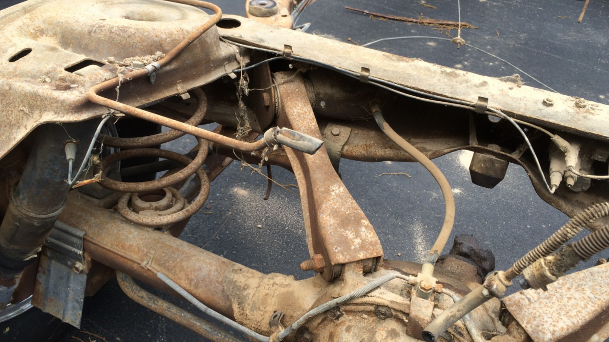

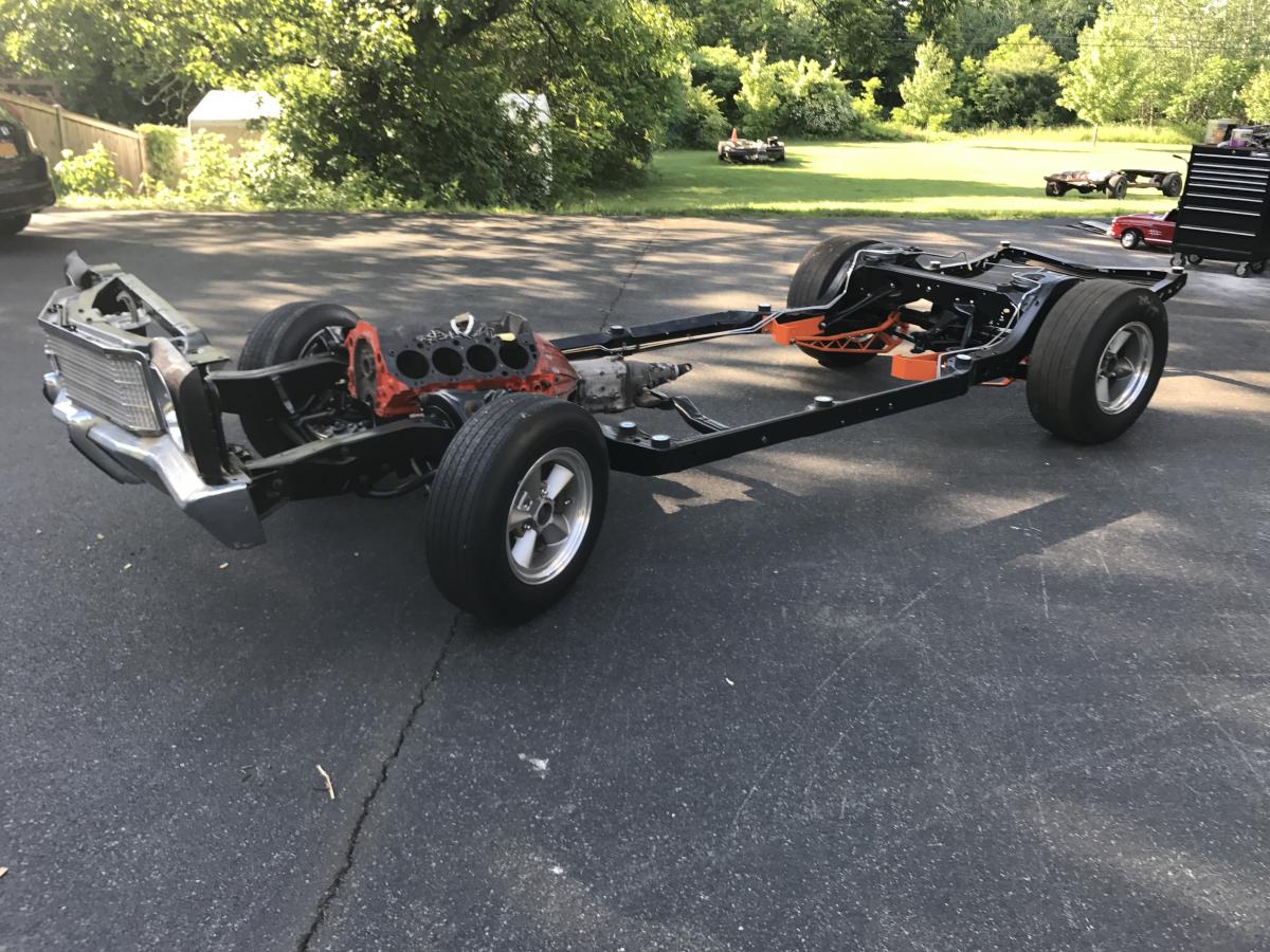

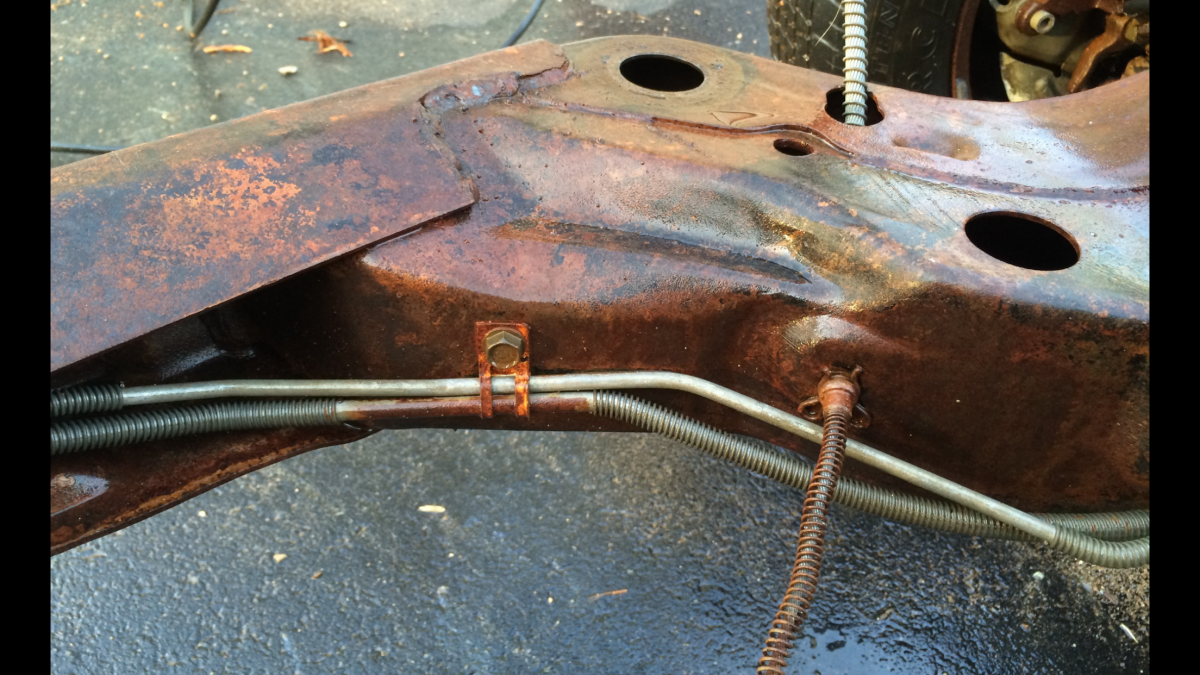

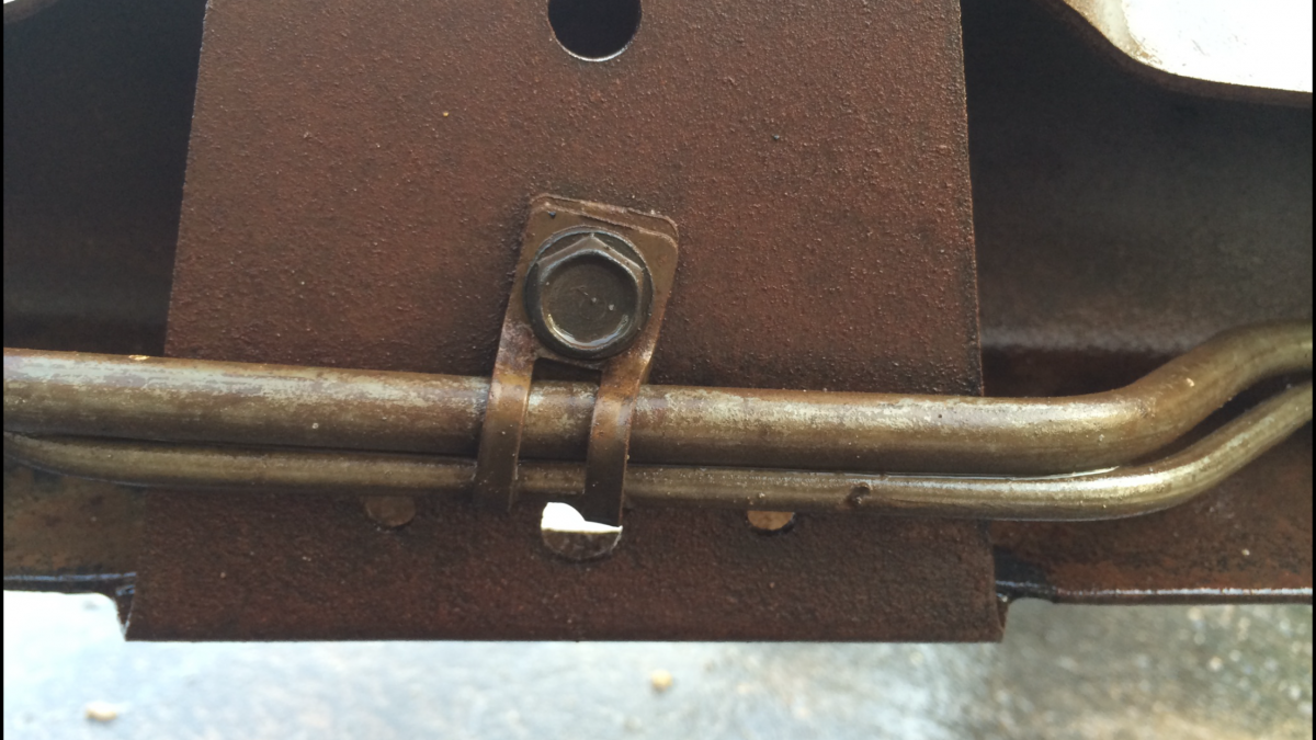

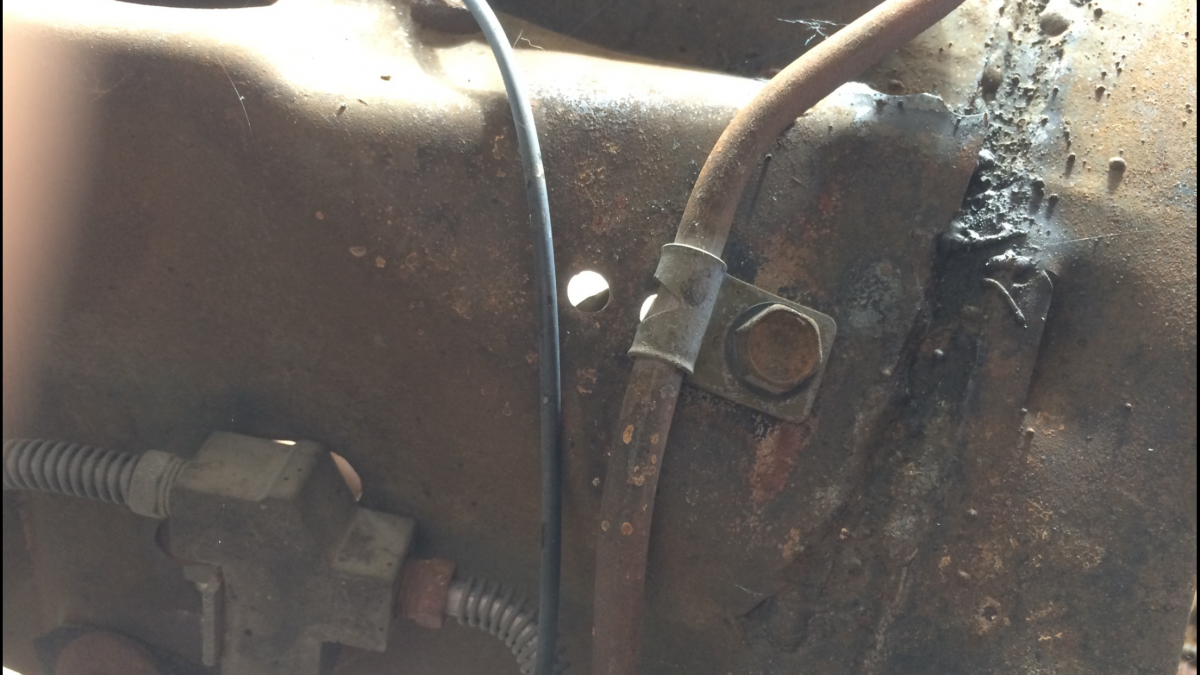

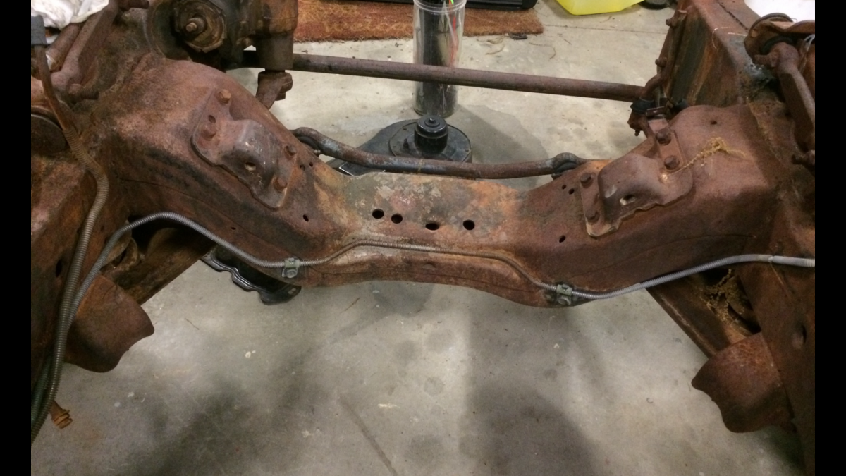

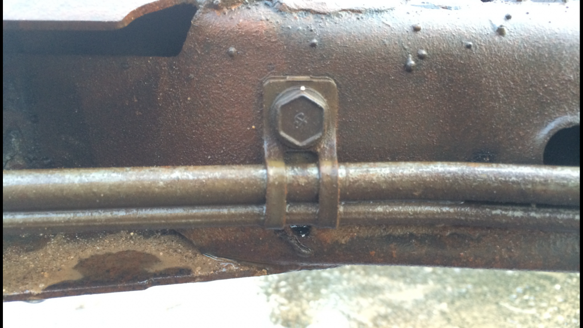

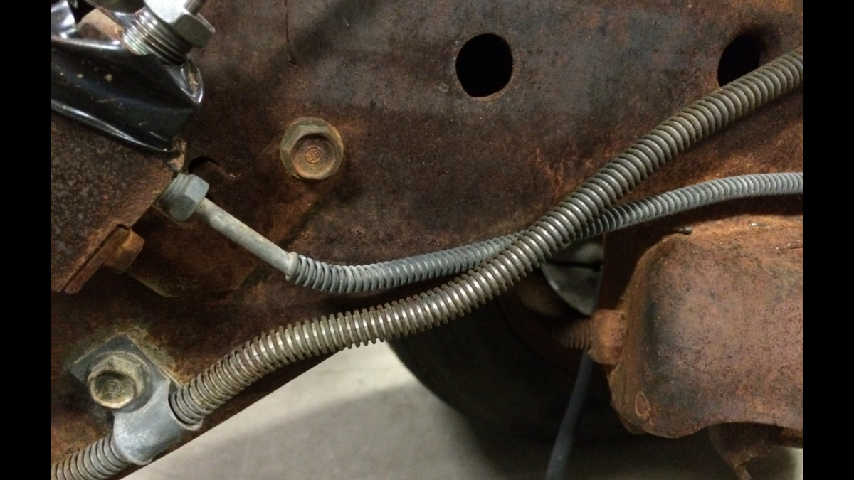

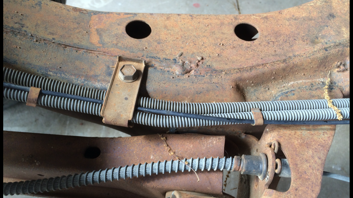

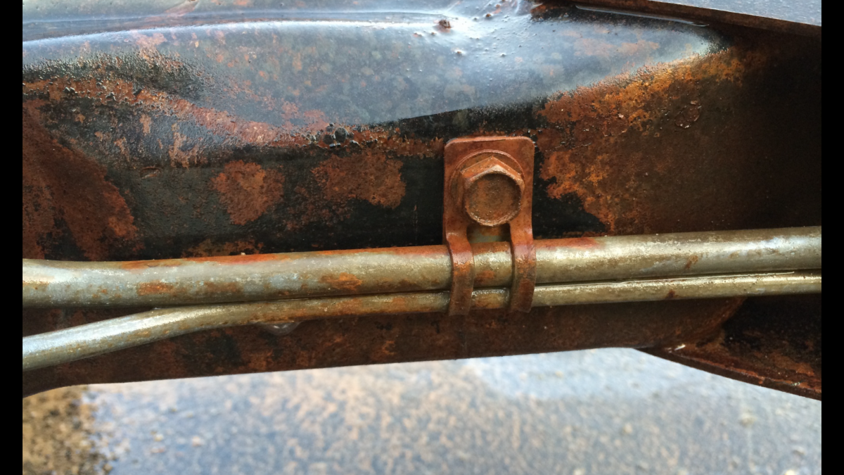

  3. Here are the photos from the chassis as I disassembled.

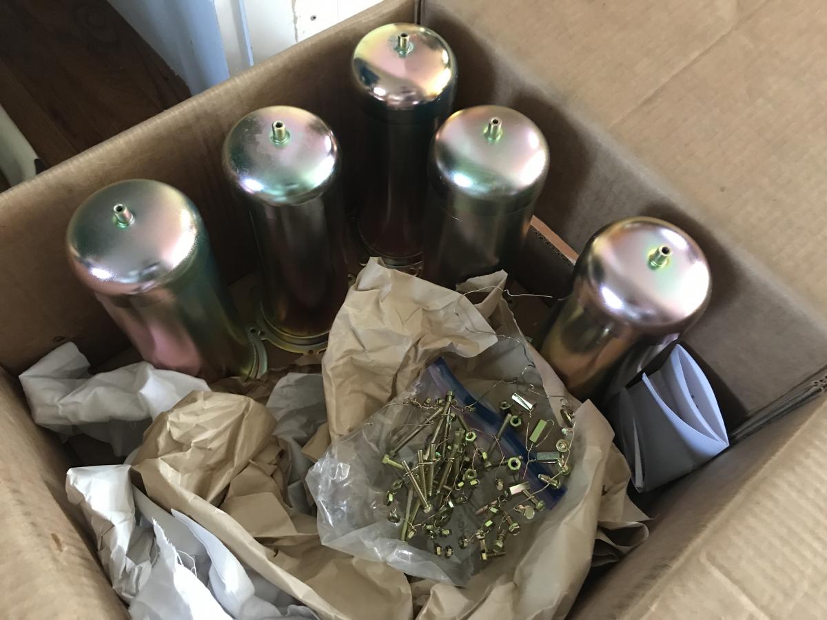

  4. Been collecting tanks for years. I think there is like 8 or 9 on the shelf and figured I'd have some plated while I was having other parts done. Plan to use one on this project since the tank was missing and give one to my brother for his '71 I sold him. The rest will be sold to help fund this project. I'm getting to the point where I want to sell off the parts I've collected over the years to free up space and the extra project money is nice too.

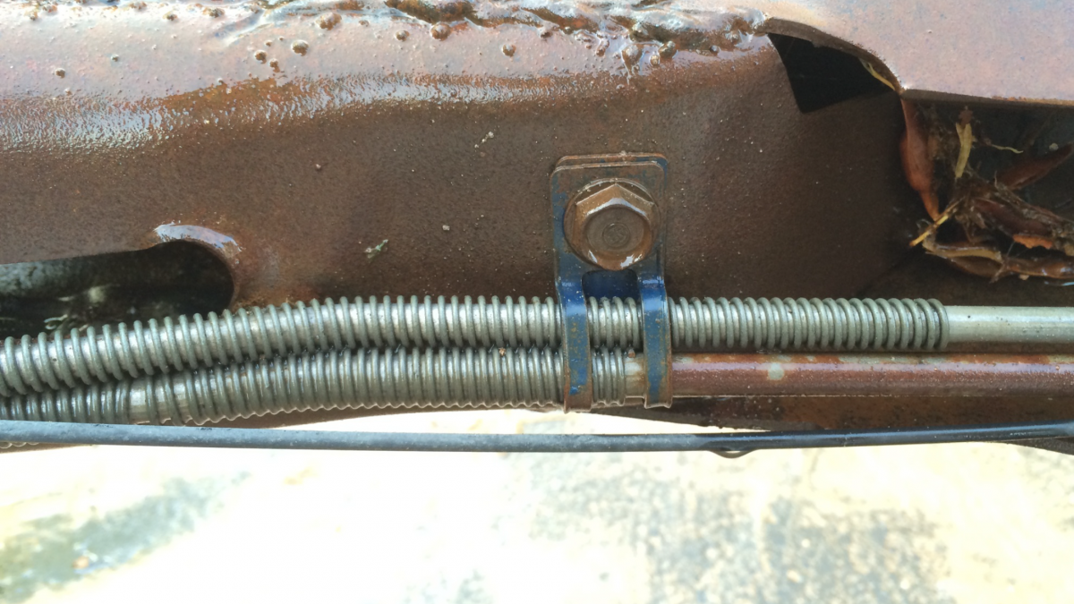

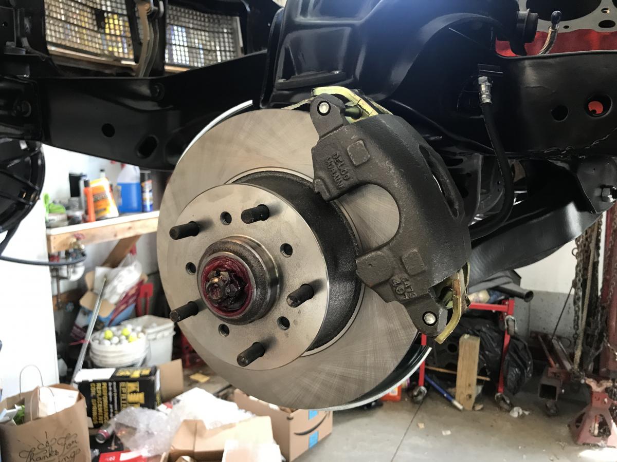

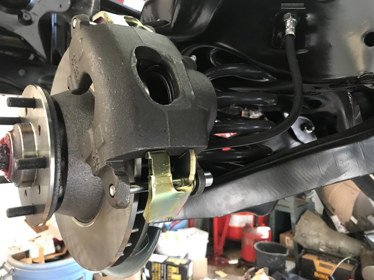

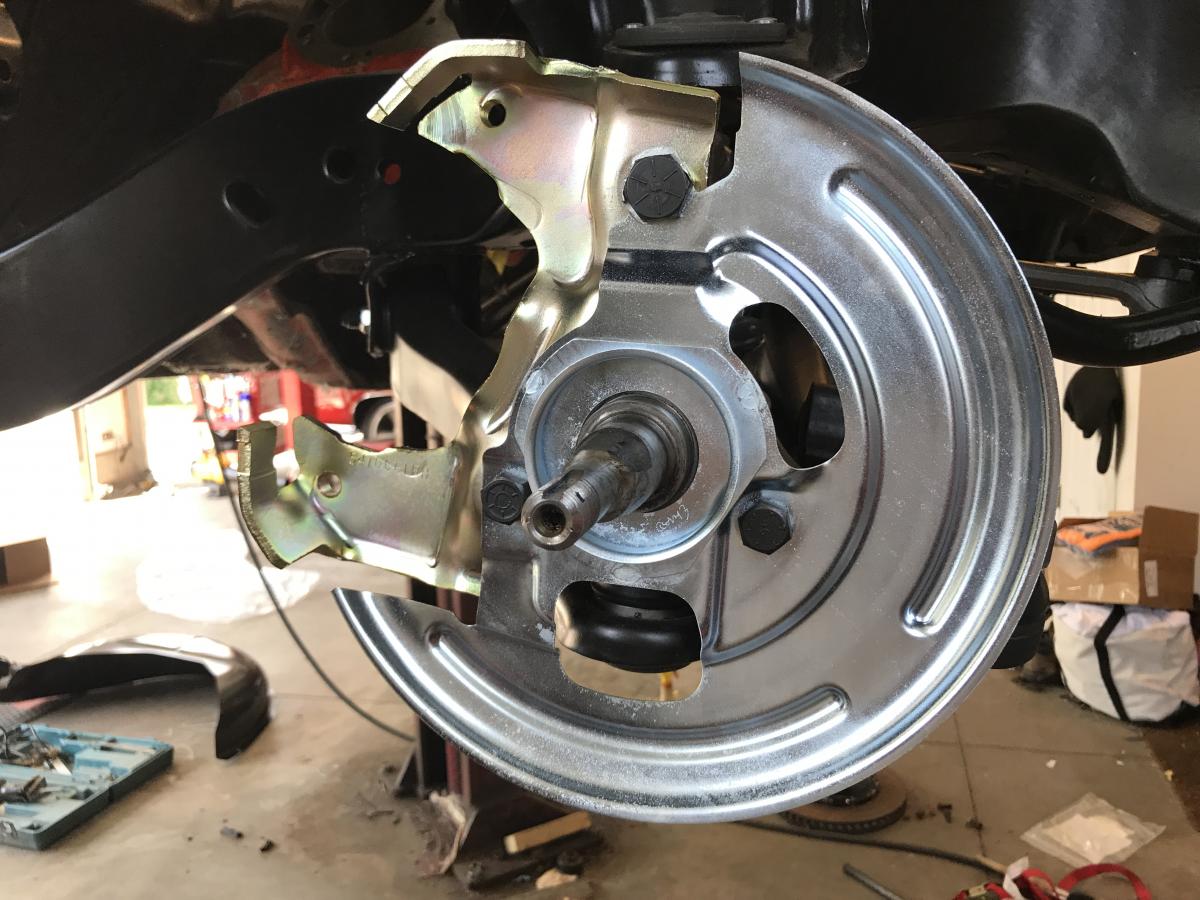

  5. Had some time to assemble the front brake assembly.

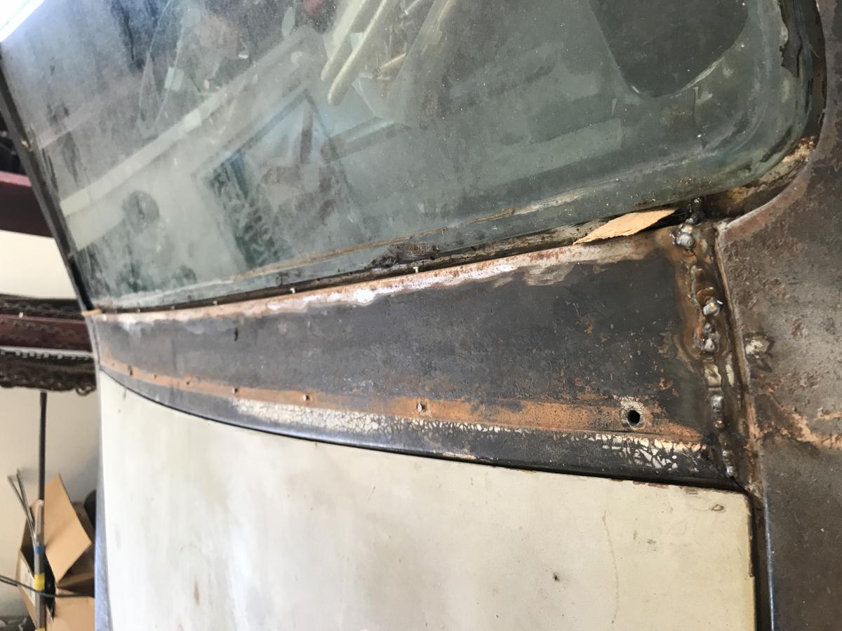

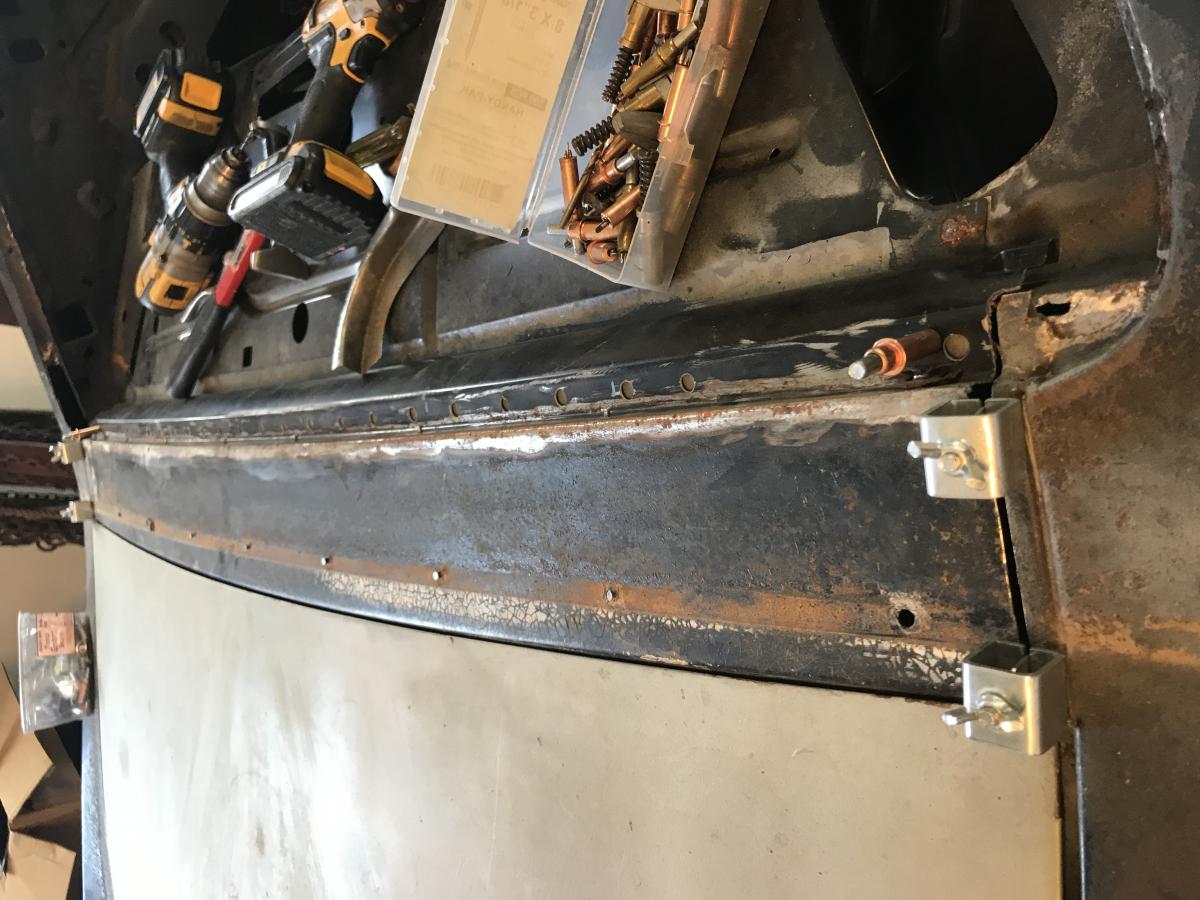

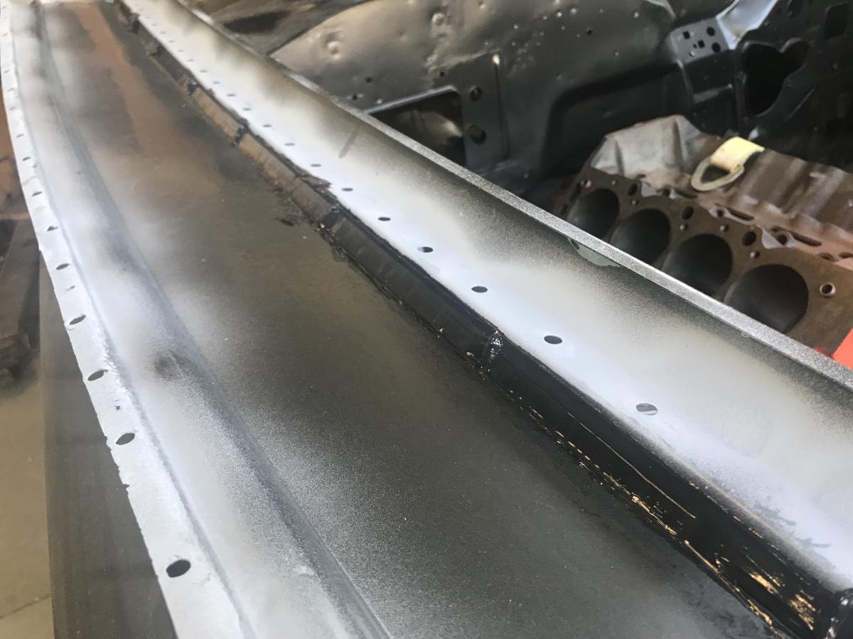

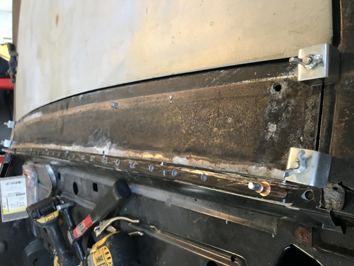

  8. Also been working on the rear package tray and deck panel. I'm happy I was able to save the original deck panel. It's coming along nicely.

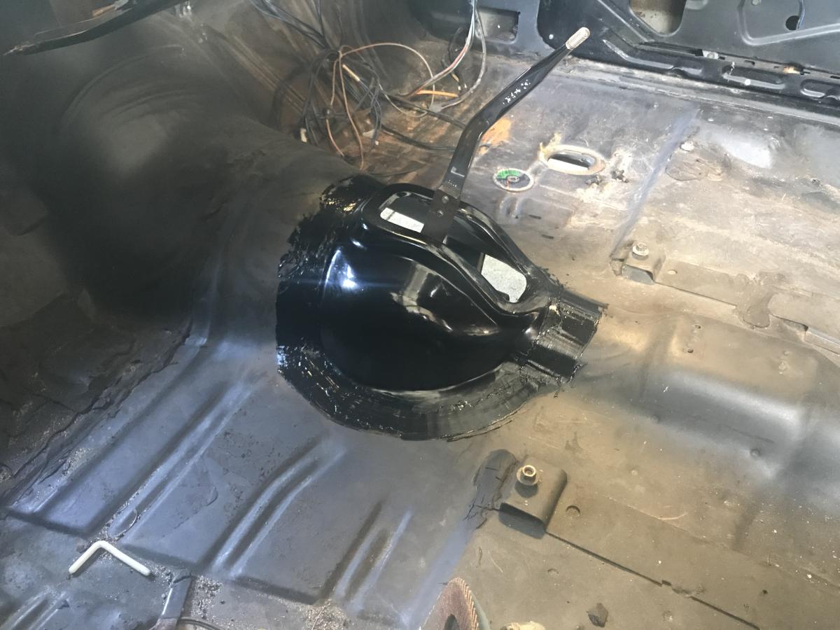

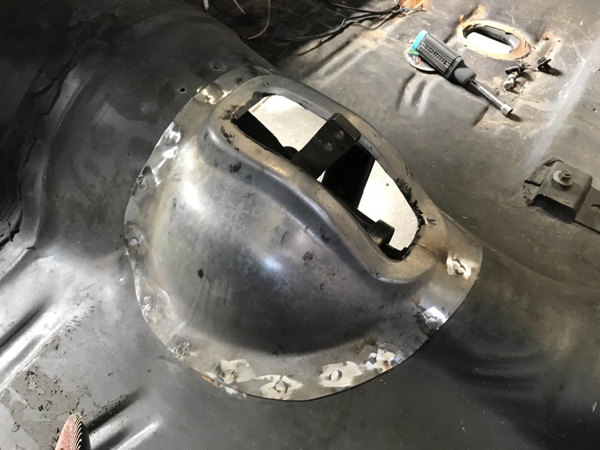

  9. Been a bit distracted with the '17 M6 SS sedan but back at it again. Dropped the body back on the chassis to install the shifter hump. Made sure to make a clean cut in the tunnel and save the cutout just incase the original M40 goes back in.

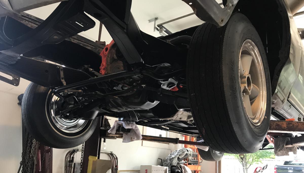

  12. I plan to run a set of ladder bars for that vintage street look. Was going to run Lakewood but you can't run the rear sway bar with them. I found this set of bars that will allow for the rear sway bar. They may be NMW brand but not sure. They were a bright orange color originally. I fit them to the chassis before paint to prevent chips but I'm sure I will ding them up being as heavy and awkward to fit. It took some fiddling but finally got them to line up.
