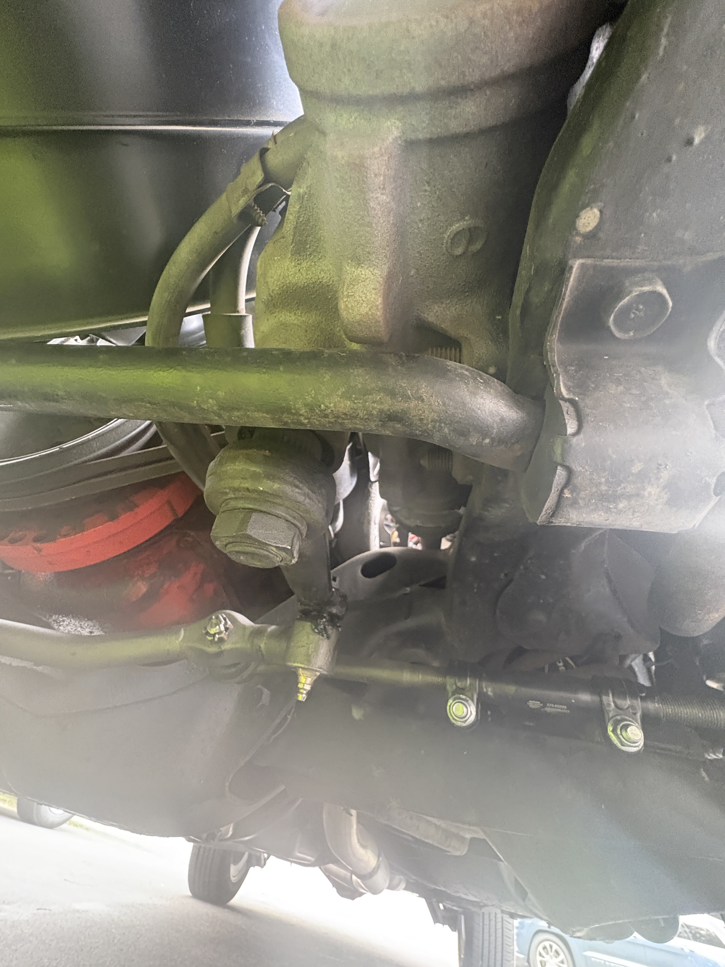

  1. Thank you. When I get home tomorrow I am going to have it inspected by a different shop then who installed suspension

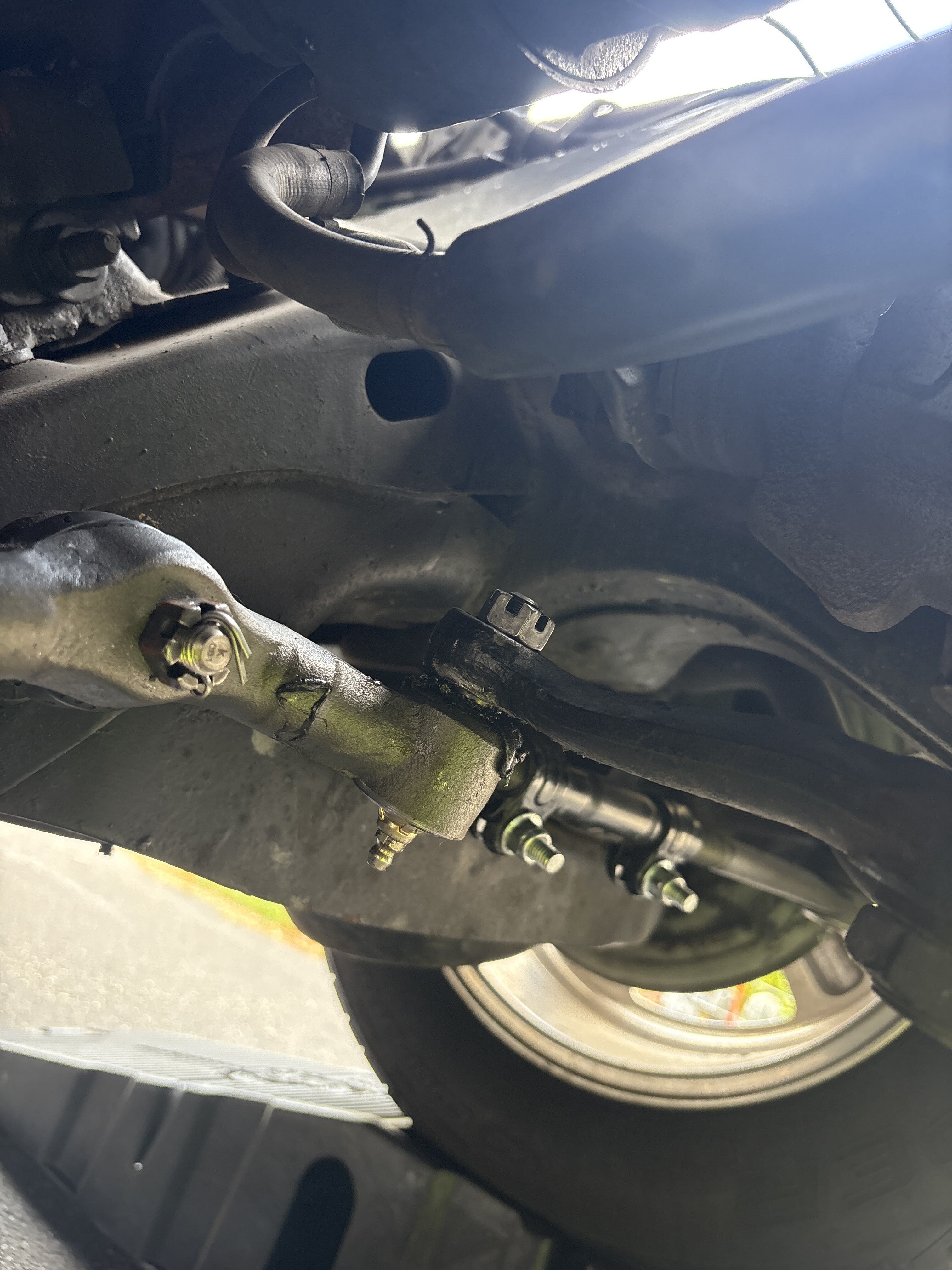

  2. All castle nuts and cotter pins are in place. Might have another shop inspect it to be safe.

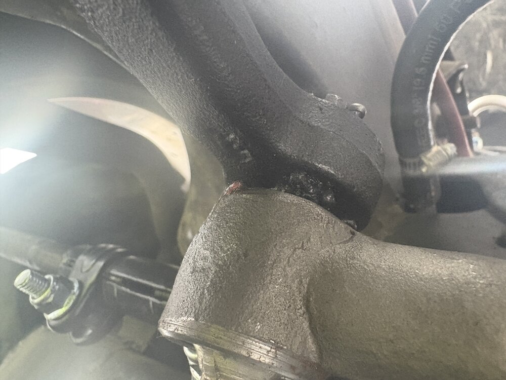

  3. In June I had a local shop replace my front suspension. Tie rods , ball joints , pitman arm etc. on Saturday my steering seemed all over the board and scary to drive. Noticed there was no cotter pin going through the pitman arm and the castle nut was on its last thread. Here are a couple photos. Does the pitman arm look right. There is no rubber boot like the other moving parts have.
