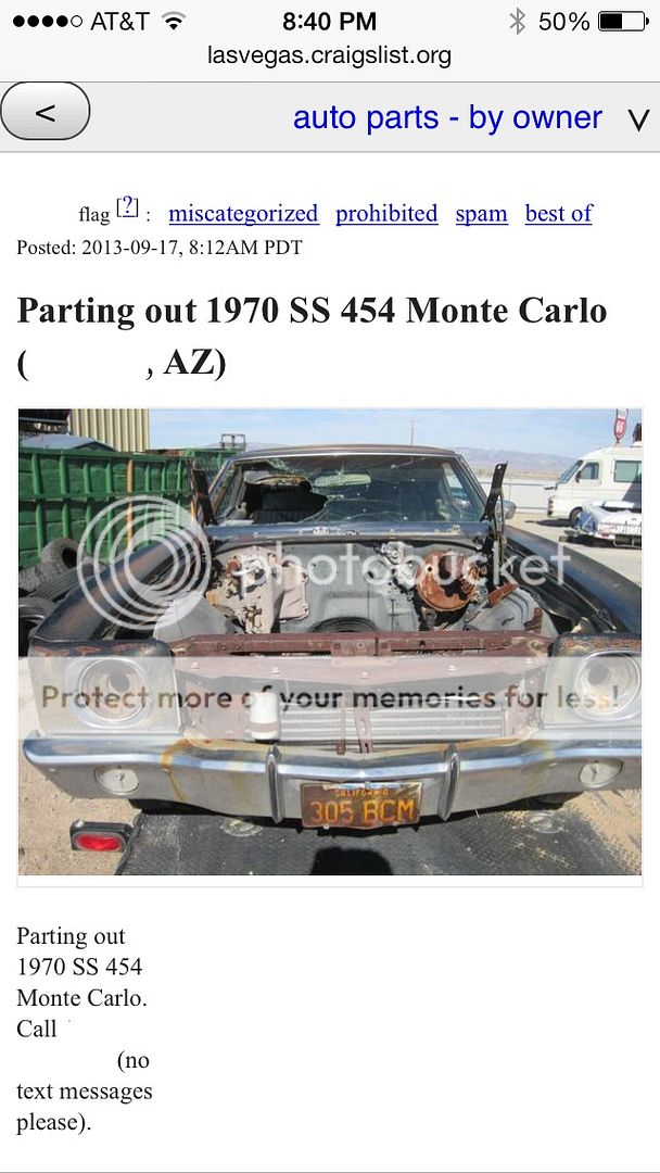

Recently while searching craigslist I came across an ad that was out of Arizona for a listing that stated "Parting out 1970 SS 454". In the one photo there was no motor in the engine bay but the load leveler compressor brackets were still on the inner fender. The ad was about a month old at the time so I figured the brackets were gone along with most of the other hard to find big block components so I just bookmarked it.

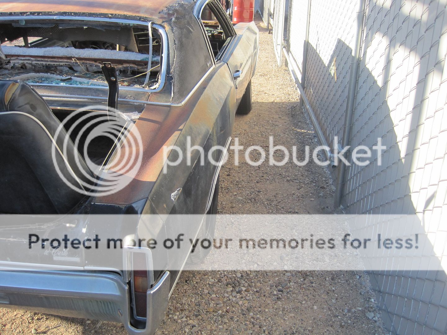

He told me he bought the car from the original family member who currently owned the car. It was originally purchased in Bakersfield California by the sister of the guy who he bought it from but it had been sitting in an alleyway dismantled for over 20 years.

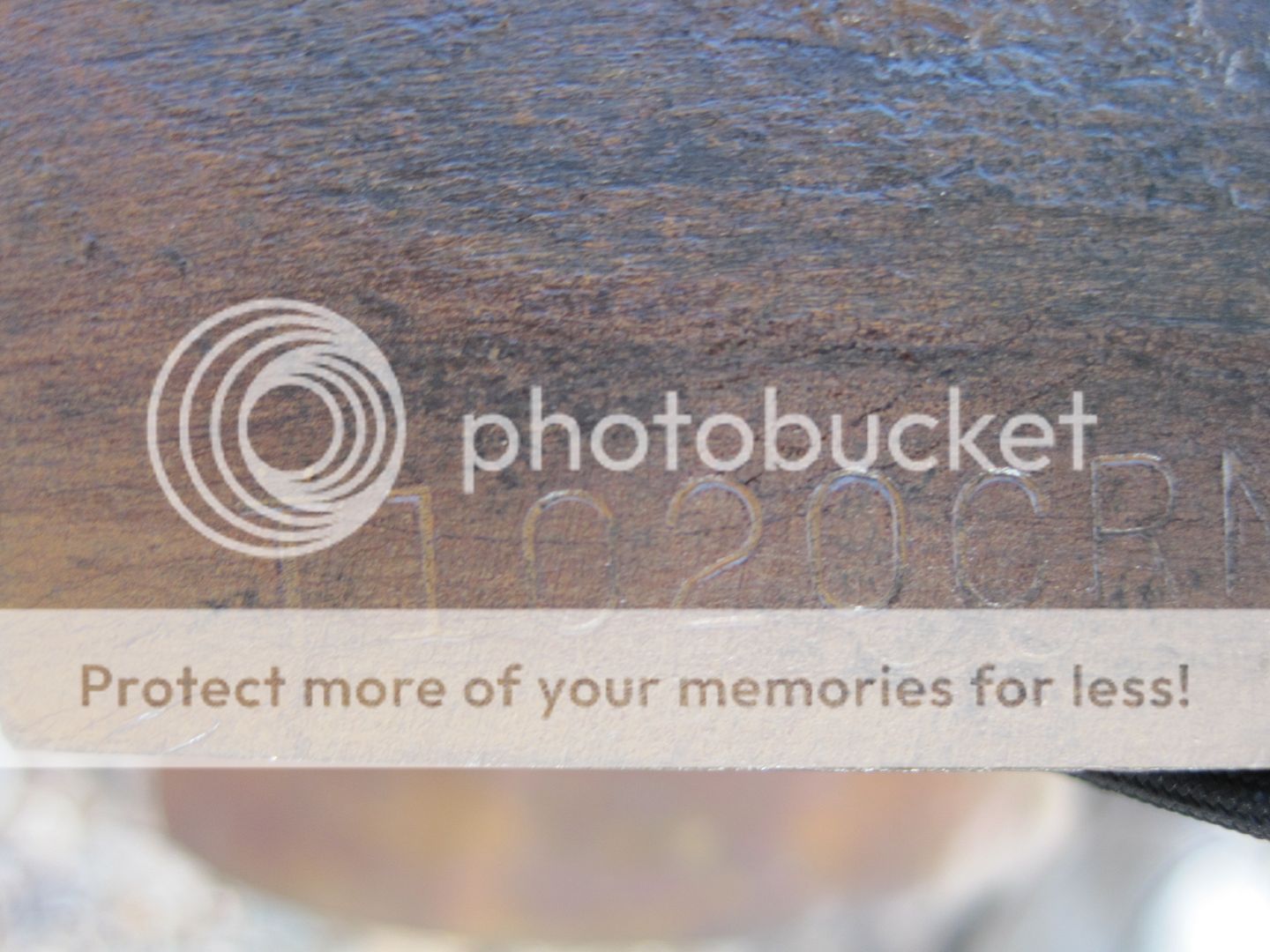

That next week while in so-cal I gave the guy a call and it was still available. Unfortunately, I didn't have the time to drive the 6 hours (one way) while out west and asked him to send me photos. After seeing the photos I knew it was a solid well optioned car. The #s on the engine (CRN) and tranny were correct for a 1970 SS454 too. All the correct chassis components that go into a SS454 were there like the boxed rear trailing arms, air ride system (minus the compressor), drive shaft with the balancer, both fuel lines, 12 bolt rear end, dual exhaust hangers, splined steering shaft, sway bars, F41 braces......... At that point I was confident it was a true SS. He wasn't able to locate a build sheet but being a Van Nuys car I was hopeful that it had one above the gas tank as I have found them there on my other two 1971 Van Nuys SS454 cars I've owned. I didn't want him to remove it if it was there because they are so brittle and I didn't press the issue.

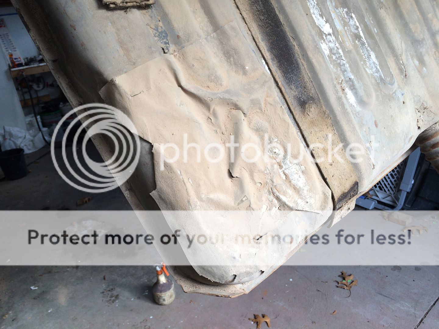

As you could imaging the first thing I did when the car rolled into town was put it up on the lift and drop the tank to see if a build sheet was there. It was and to my surprise it was in decent shape and nearly complete confirming the Z20 and a host of other options. It's crazy that a piece of paper 44 years old is intact and legible!

Here are some shots of the tank build sheet as it was removed from the car.

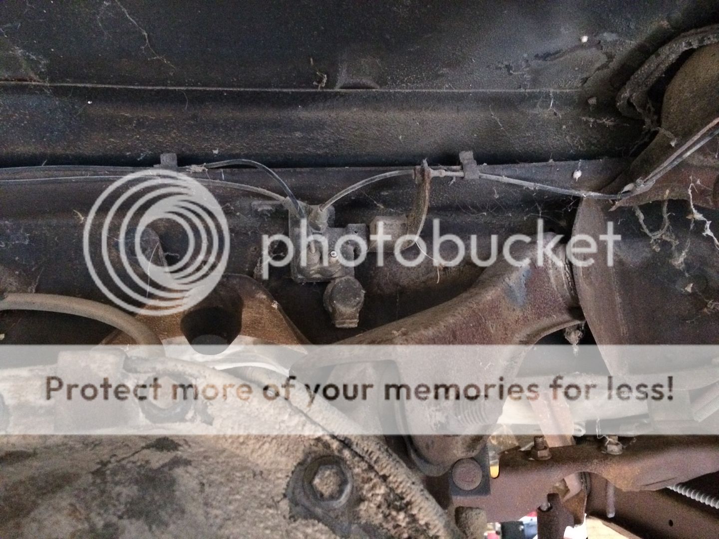

Here are a few shots of the original rear air shocks and valve. It's cool that the factory shocks are still intact. They have no dampening left in them but are a great reference for the restoration. Notice the tags on the springs.

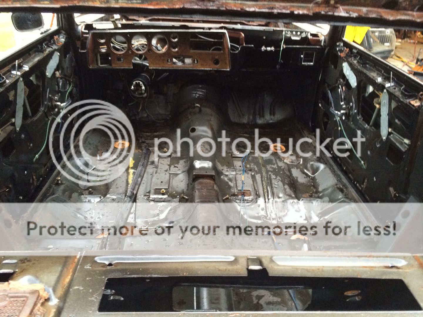

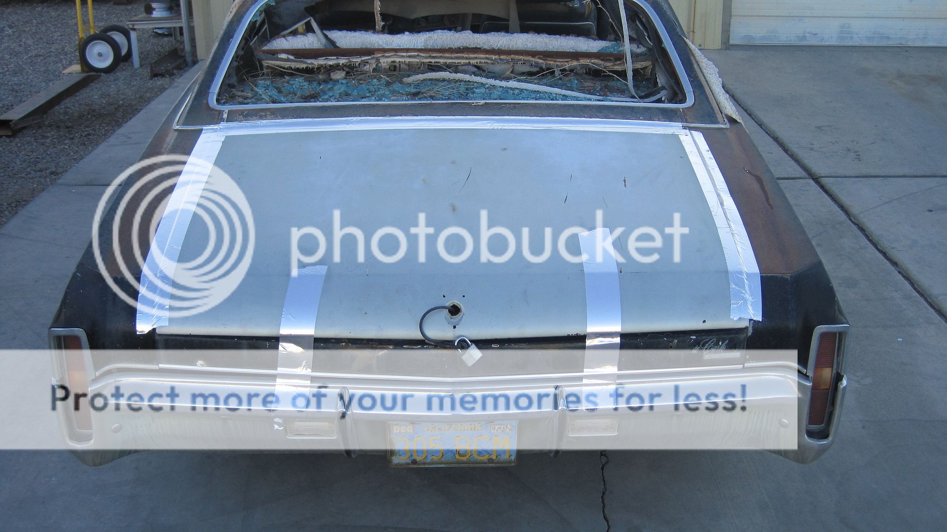

Being in the desert for most of its life and without windows or trunk lid for 1/2 of its life the car is caked with dust and sand. Check out the state of the interior. It's time to clean it out to the floor boards.

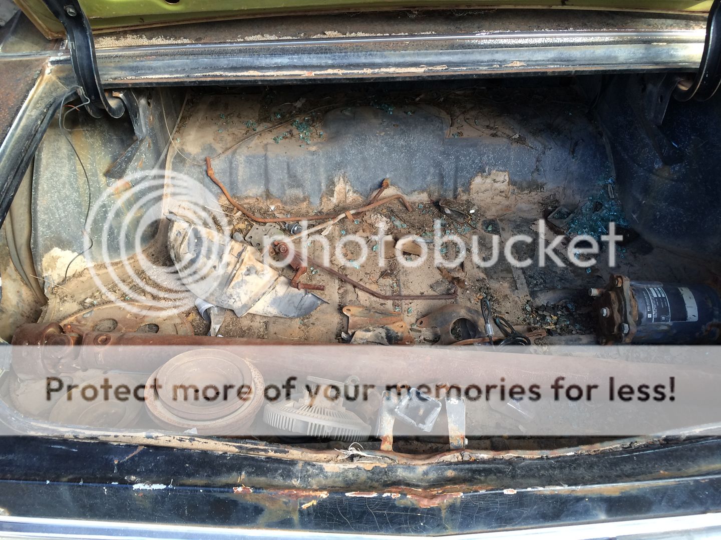

Check out how solid the floor and the trunk is after a pressure wash. Try leaving a car exposed to the elements like this one was in the north east and you will have Flintstone floors.

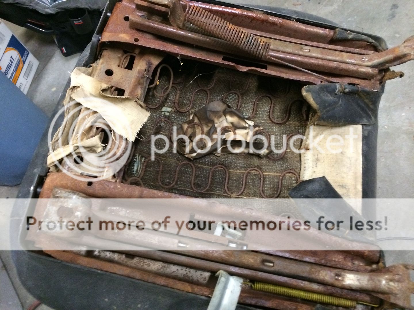

While dismantling the interior I found a second build sheet under the passenger bucket seat. It's in tough shape but shows the all important Z20 option. I'm grateful for the tank build sheet and finding this build sheet is icing on the cake.

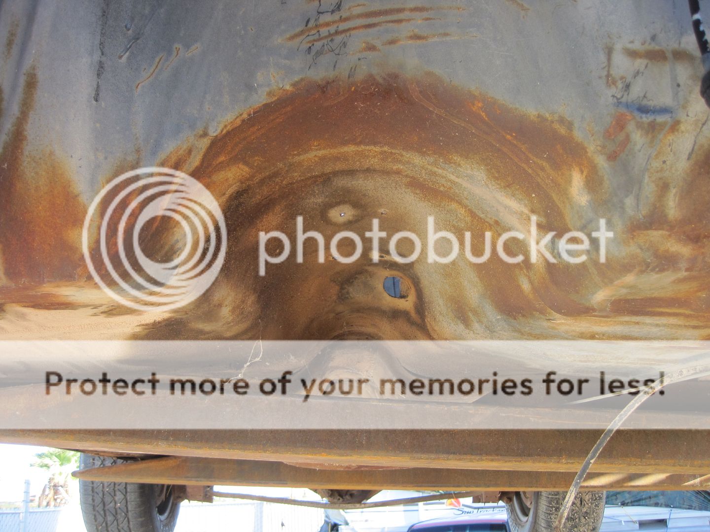

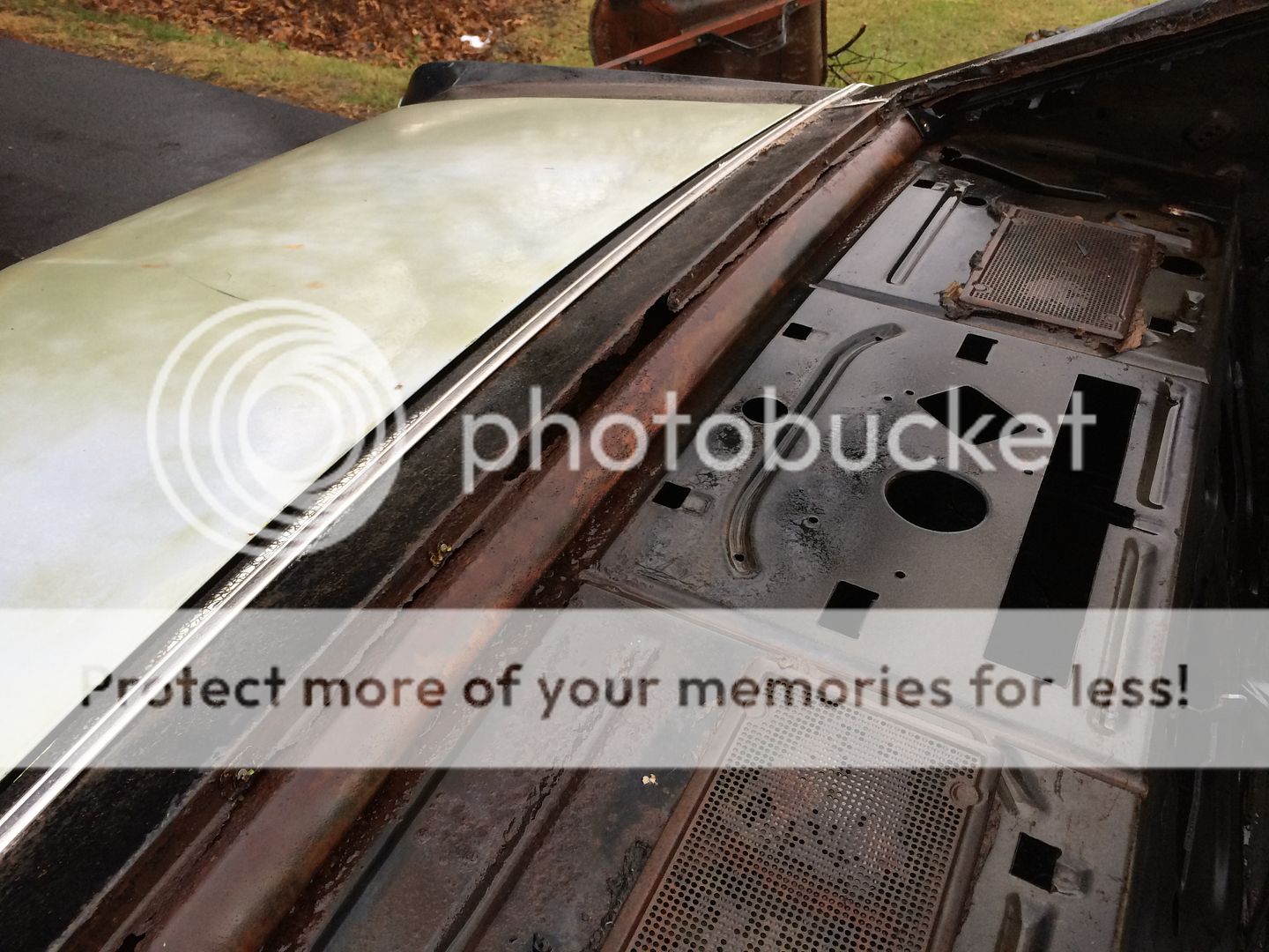

Here is the worst of the rust I've found in the car around the rear window. Typical for a vynal top car. Should be a relatively easy repair. I wish I kept the rear deck I cut out for the convertible project. It would have made a good patch.
Bless you for giving this old girl a new lease on life, Jeff ... she's already looking much better!! Glad the rust issue is minimal.
