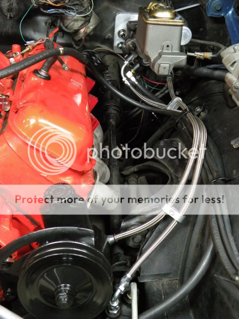

Ever think about converting to a hydro boost? Install is not that bad. Its a good trade for better brakes, takes up less room and doesn't rely on vacum for operation. You can run as big as a cam as you want. Check this article out.
Car Craft Hydro Swap
As you can see the booster is just a little bigger than the master cylinder. Here is another members Monte with a hydro boost.
Hydroboost works great, but is kinda costly. Well worth it IMO.
Here's a photo of mine as it was going in:
