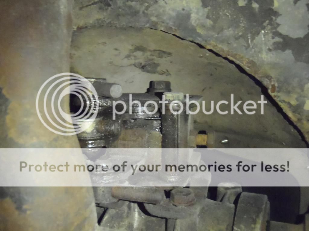

V8Freak Posted January 29, 2014 Author Posted January 29, 2014 Got some pictures! Let me know if you see why I may be having an issue, hump doesn't even wanna sit on the tunnel due too the base of the shifter sticking up so high Quote
Murphy Posted January 29, 2014 Posted January 29, 2014 Just curious....what cross member are you using for trans support and what's the height of the trans mount? I think, the stock mount is 1.9" ???? Quote
V8Freak Posted January 29, 2014 Author Posted January 29, 2014 I'd say it's about 1.9 give or take Quote
Sam (Bones) Posted January 29, 2014 Posted January 29, 2014 that OPGI link shows a bench seat handle, which is what I have Quote
MCfan Posted January 29, 2014 Posted January 29, 2014 Your mount is the same height as stock. As you suspected, your shifter is not compatible with your replica transmission hump. Of course, there are other shifters that will fit under the "stock" hump, including Muncie and at least some Hurst models like the one shown below. Sorry I don't know the exact model of Hurst it is but my records show it was installed in 1974 so it may not even be available today. Quote
