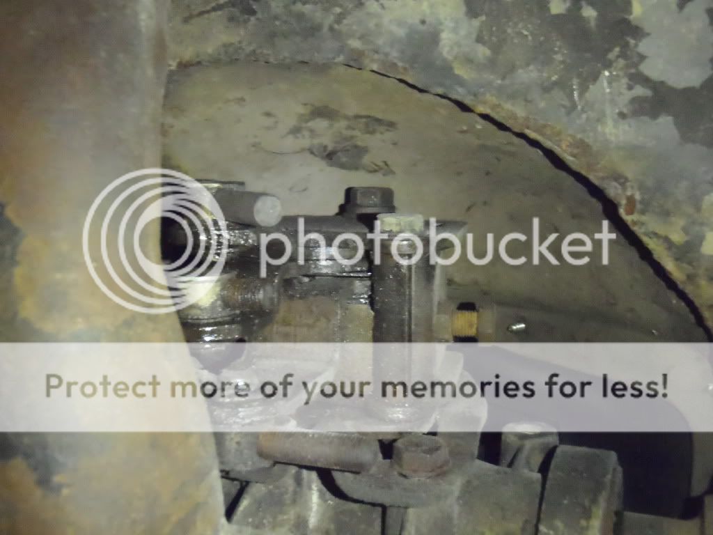

V8Freak Posted January 30, 2014 Author Posted January 30, 2014 I'll have too call hurst by the picture it looks lime it will give me the same issues definately want too verify that it will work Quote

LS5 Posted February 6, 2014 Posted February 6, 2014 Hey Sam-Dennis, have you guys noticed what I think I have noticed ?? Thats Not a Muncie 4spd with a Hurst set up…….. unless my eyes deceive me on the lack of bolt applications where the shifter bolts up to….Thats a Saginaw Tranny and the Hurst shifter not only won't work but the tranny won't either That Tail shaft looks rather long… when I did my 4 spd conversion on the 70 chevelle which you and I walked through Sam mine was a piece of cake and didn't look like this and the 4spds I have worked on for Vaughn's 2 4spd Montes one being a Hurst shift and the other a muncie didn't look like this set up either………. unless its the cheap Meds I am still on this is my 2 cents worth… Darren. Last two pics are Muncie the first is Saginaw….. The set up thats in there now looks like its a 1966 or 67 Saginaw that would work perfect in a 66-67 chevelle which you remember that goofy console had that J hook in the console to accommodate That Hurst Shifter….. Quote
MCfan Posted February 6, 2014 Posted February 6, 2014 Hey, Darren, great to hear from you!! Hope those "cheap" meds you're on are controlling your pain ... they sure haven't affected your eyes! Good catch on the Saginaw transmission! I guess when Matt originally posted that he was converting his Monte from an auto to a 4-speed we all assumed it was a Muncie M20/M21 and went from there. Shows why it is always dangerous to assume! Matt's photo of his transmission and shifter base (below) clearly shows the single threaded boss on the top of the tailshaft that the shifter is bolted to as being a Saginaw (or at least NOT a Muncie) transmission. On the other hand (although the photo is taken from under the car looking up), you can clearly see the rear, unused, threaded boss on the tailshaft of the M20 in my Monte (lower right corner of photo). Just comparing the mounting locations on the transmission images shown in your post, it is clear that the same shifter base would sit about 1 inch higher on the Saginaw than the Muncie. That is probably the explanation of the interference Matt was experiencing with the "standard" transmission hump he bought. I don't know (and I haven't done any research) if any Saginaws were installed by the factory in '70 or '71 Montes. If there were even a few, there should be some combination of shifter and hump that allowed installation with a standard console. If not, it would appear that Matt is in need of a "non-standard" solution for his conversion. Thanks for sharing your insight on this, Darren. As usual, you're the best! Hope you are feeling better soon. Quote
