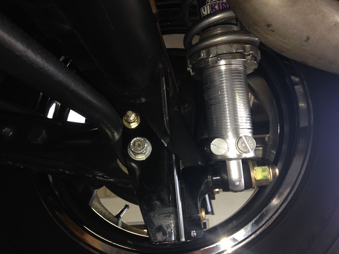

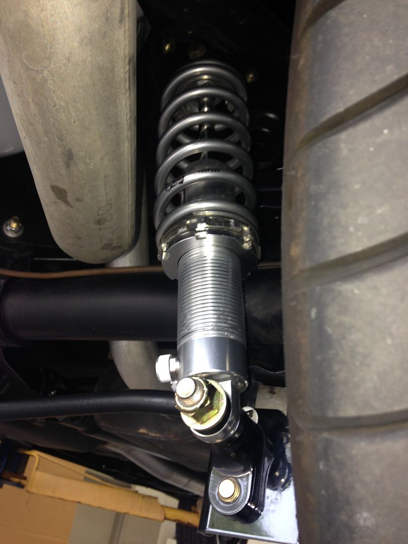

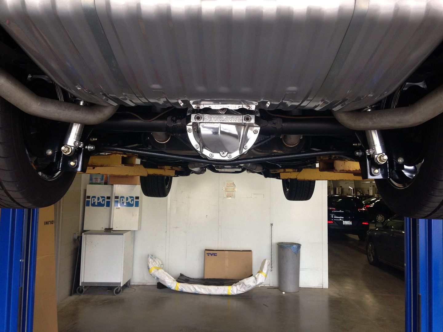

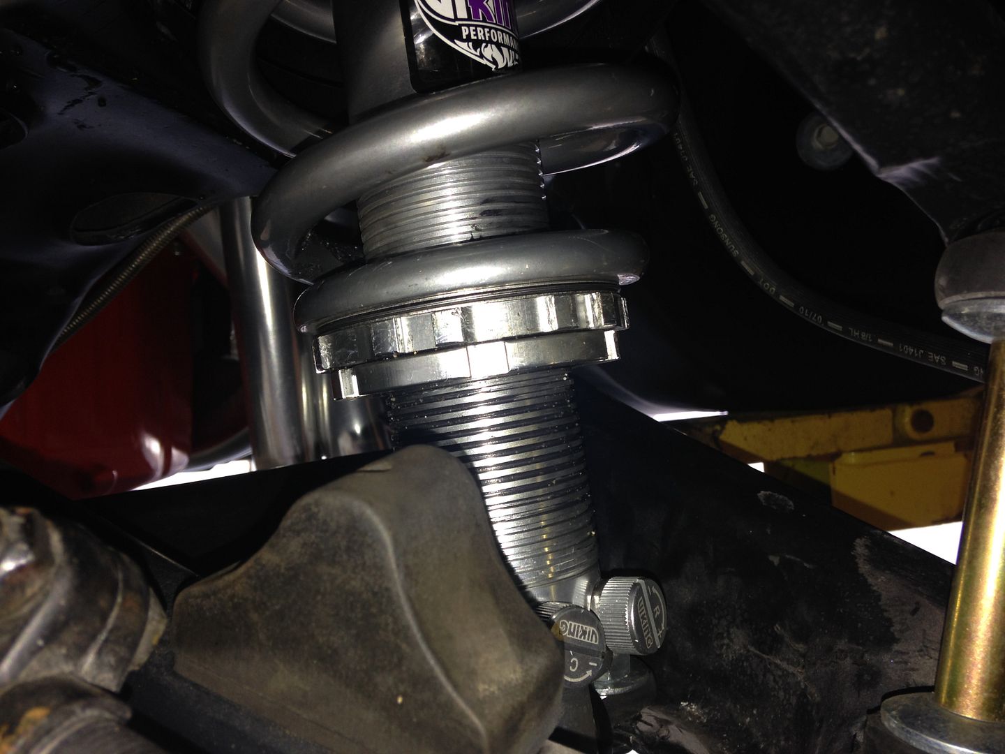

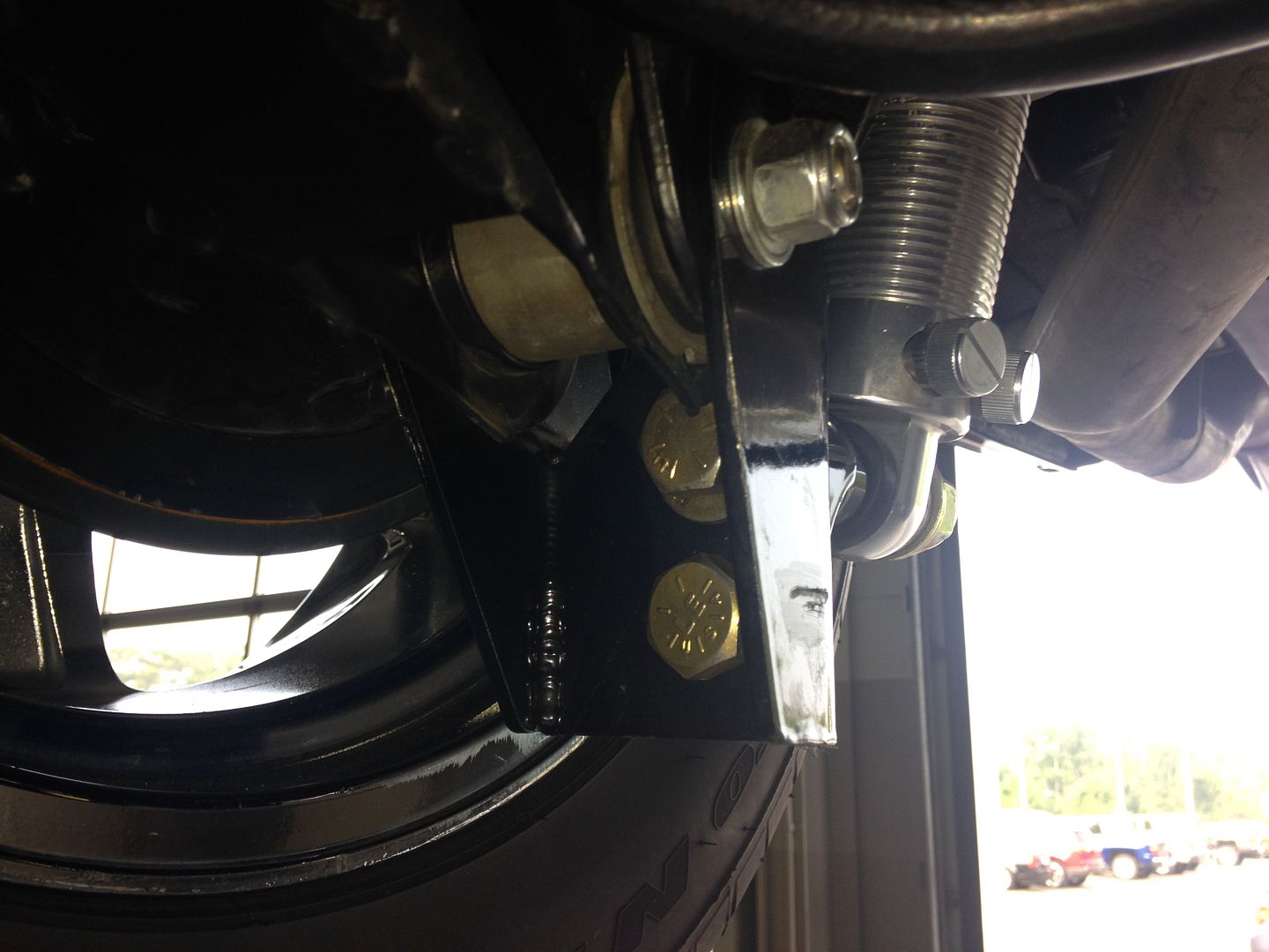

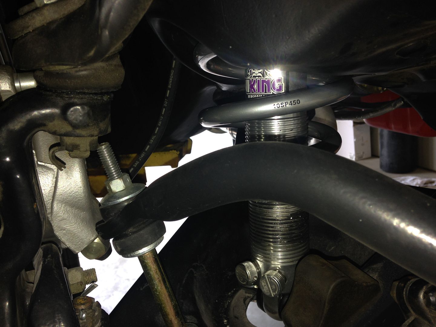

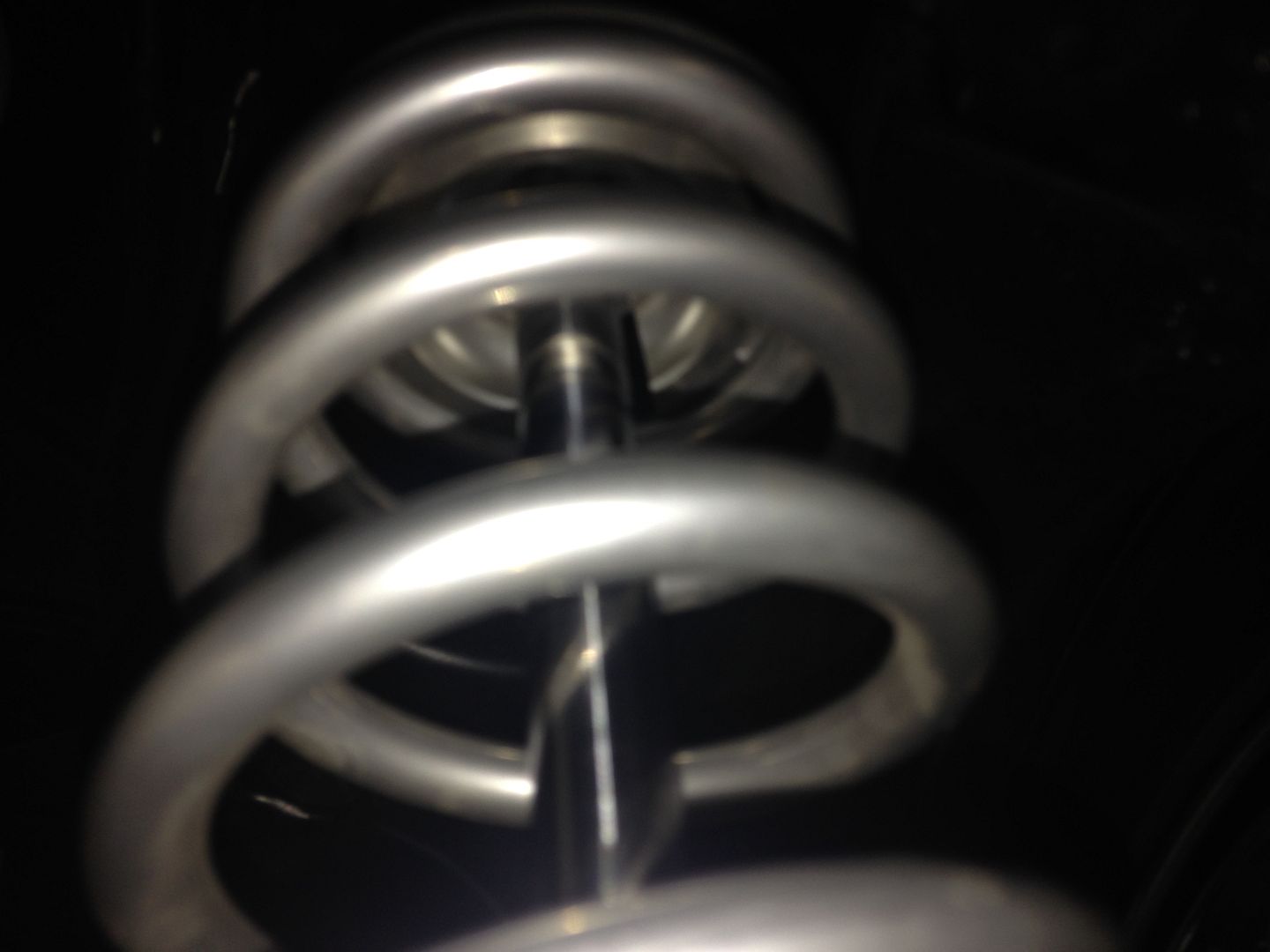

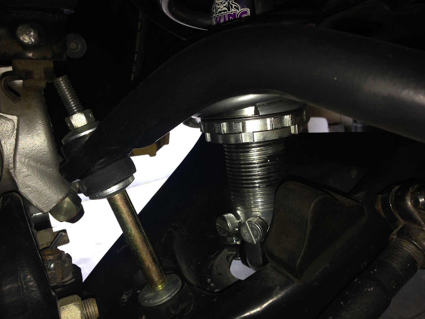

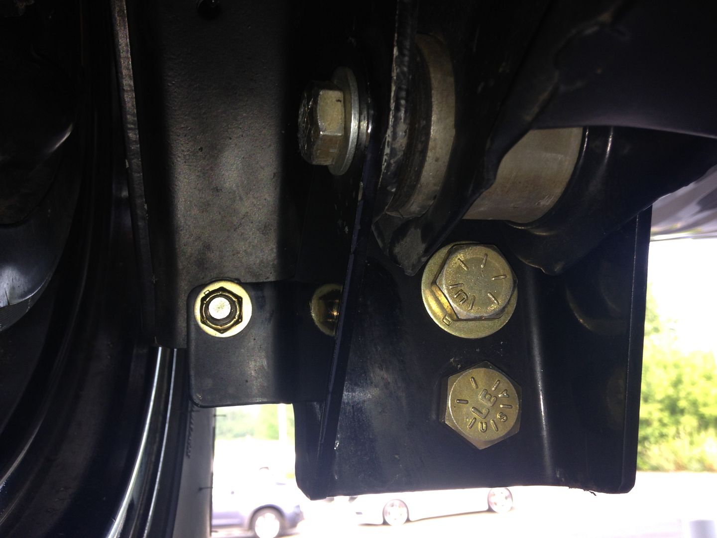

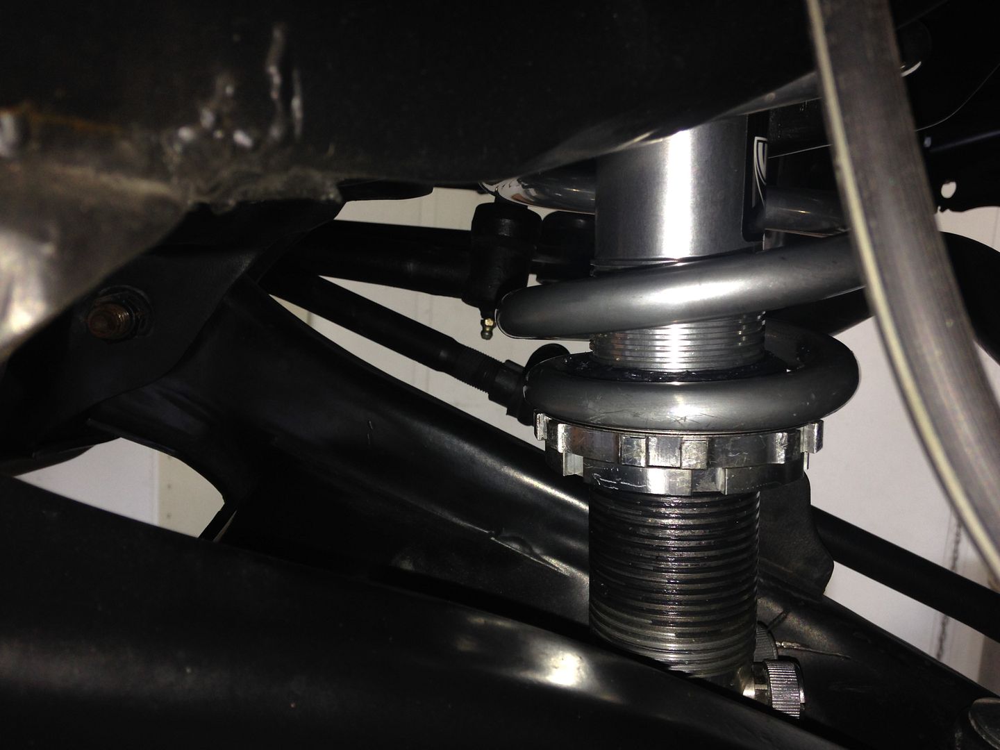

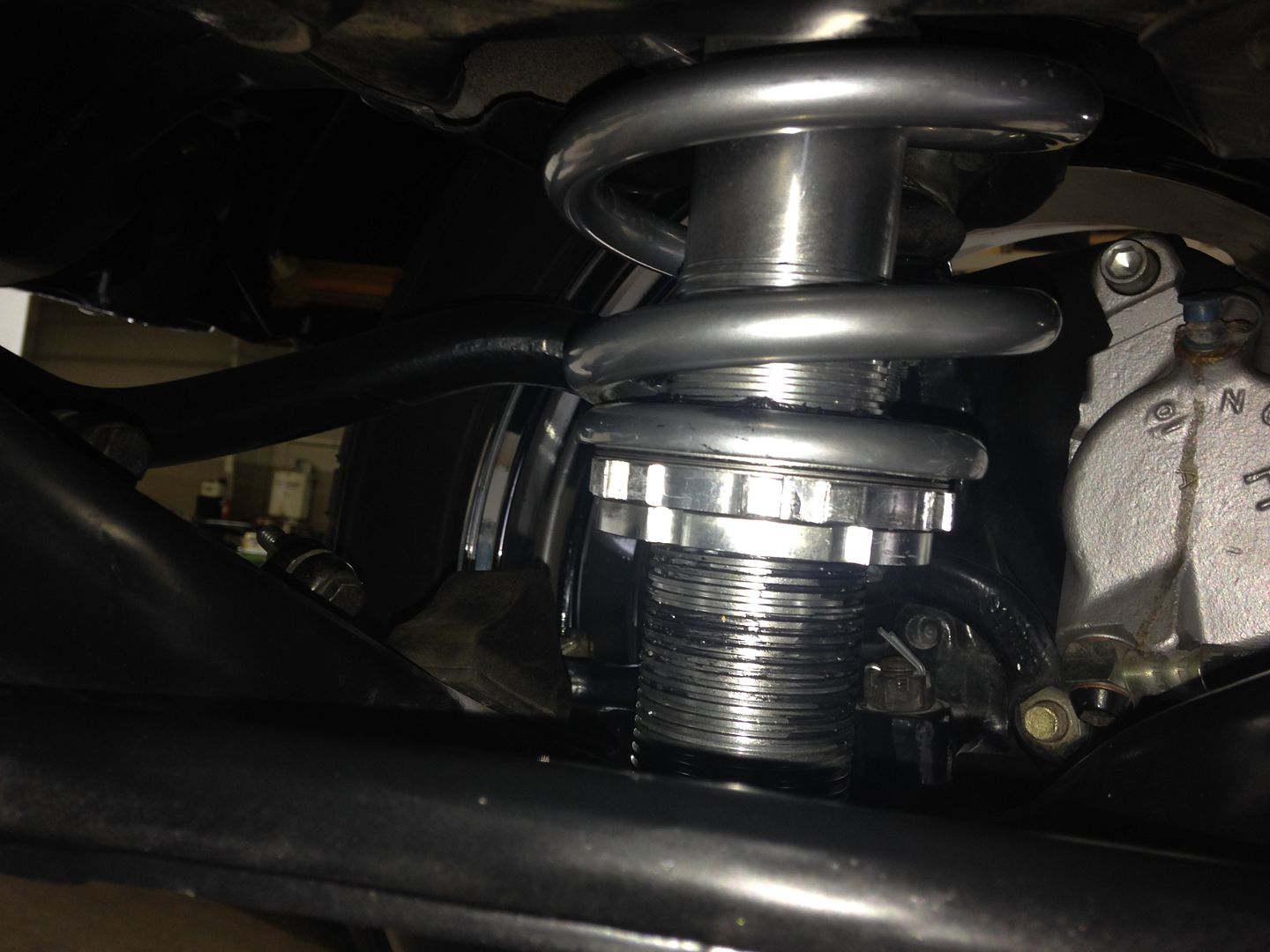

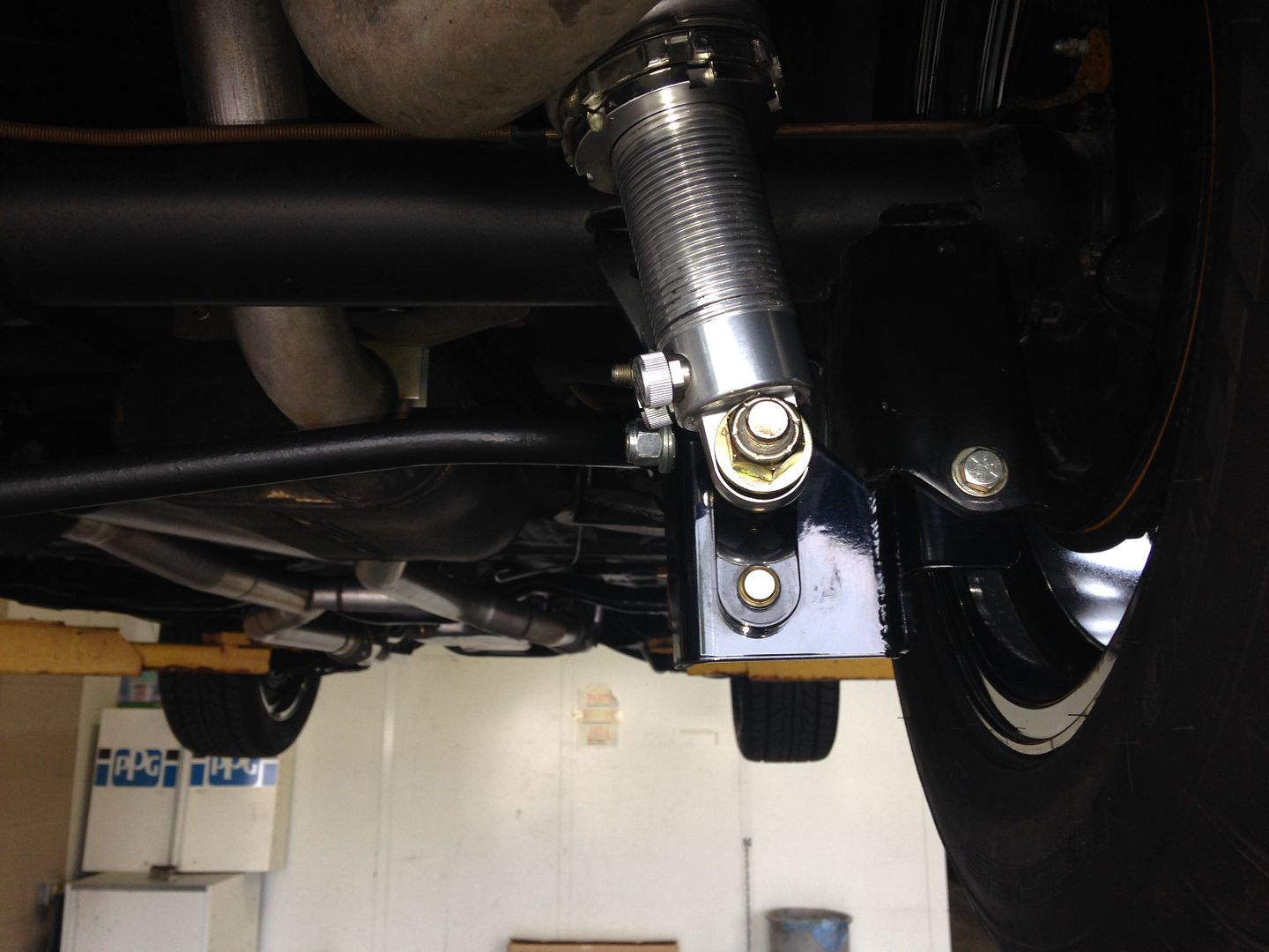

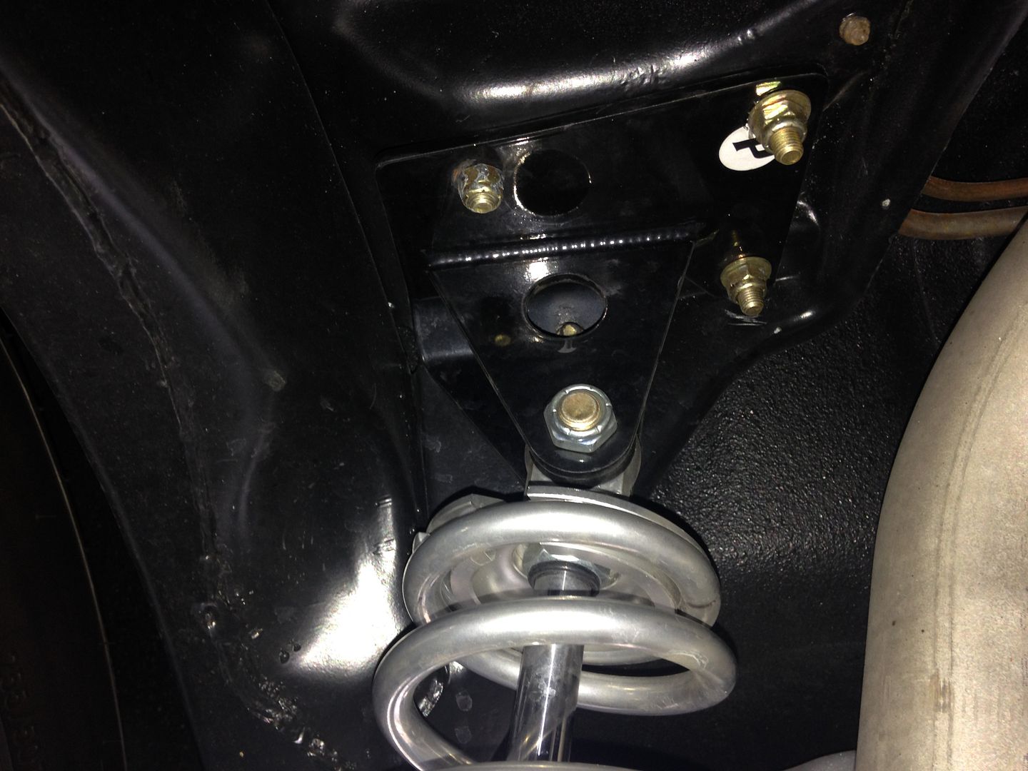

Here's a few pics front & rear

That all looks great, Cory. What support changes had to be made? I see the bottom rear bracket support, what about the front bottom?

Great rear install shots Cory. - Dave
Hey Murray, there are no modifications to the front as far as additional braces/mounts, they are mounted in the factory positions. However the front lower are mounted on top of lower control arm instead of sliding up thru the bottom like the factory shock. This way the T-bar part of lower shock puts all the weight and stress on top of lower control arm for a much stronger mounting than just the bolts & U clips holding it in place. The rears are an easy install too with brackets top and bottom that require some drilling. The brackets are very stout and doubt there will ever be any issues with the mounting points. I tried to get good pics of the rear brackets/mounting points as I could. My pics are actually better than the ones included in the instructions. Hope these may help the next guy on install. So far I'm completely satisfied and got way more out of this conversion than I expected. grin
