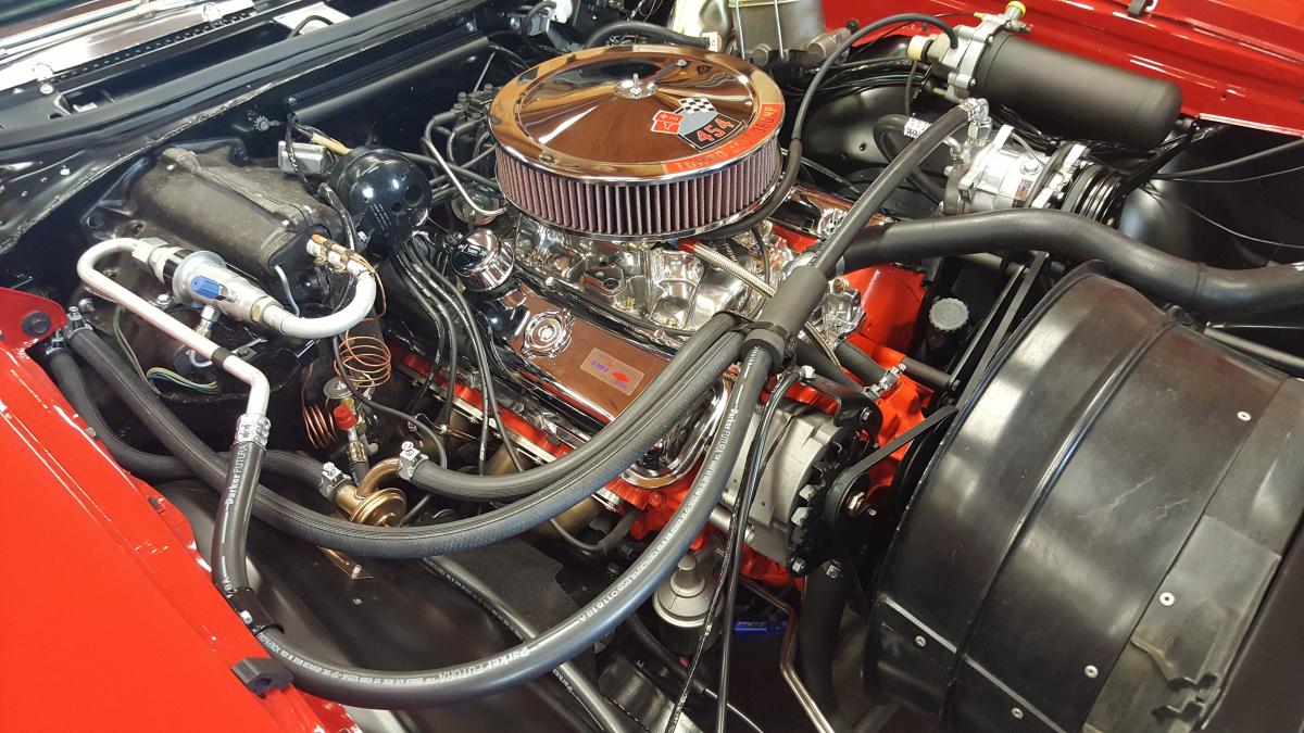

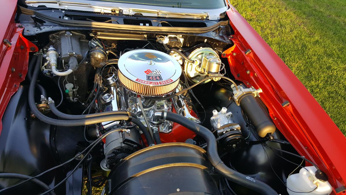

I blasted and painted the new AC compressor brackets and got the compressor mounted. Getting the correct length belt was a pain. Installed the new condenser, the filter/drier, the expansion valve, and I've cut the hoses to length, ready to have the ends crimped.

Thanks! Finished the installation of the AC system parts and got the system charged and leak tested this morning. One step closer to being on the road.

Dan, very nice clean build, Masterful in every sense of the word. The kit from Classic air dresses it up pretty nice, was the kit minded in that fashion? With the compressor in the existing location and can you still use the existing evaporator?
Thank you, guys. The Classic Auto Air Stage 2 kit is for those that want to keep their original controls, evaporator and housing, and mount the compressor in the original location. Everything forward of the POA valve is in the kit, including the brackets for the compressor, and all of the mounting brackets and hardware for the included condenser, and new filter/drier. The compressor brackets and spacers come bare. I chose to paint the brackets satin black and I blasted the bolts, washers, nuts, and spacers before coating them with the black oxide kit. The 2 longest hoses come with one end finished, and I cut the other end to length and had the guy that charged the system install the ends on the hoses a couple of weeks ago. I used R134A. When you order from them, they'll ask you what refrigerant you'll be using and which compressor you want. They were very helpful and knowledgeable.
