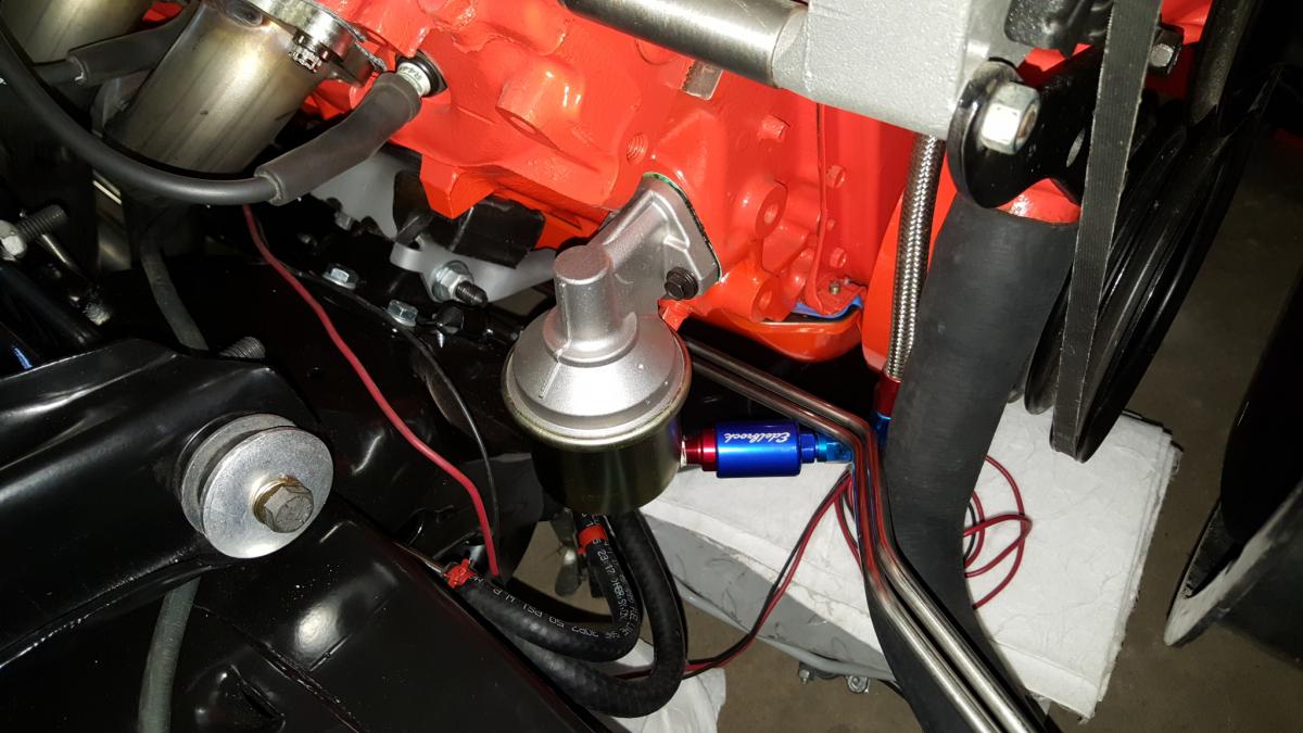

overdrive Posted June 19, 2016 Author Posted June 19, 2016 Yes, I'm pretty happy with the headers. Got to spend some time on the car today. I have some of the exhaust mocked up and ready to weld some joints. Did some work in front of the motor. I put the core support on and the fan and shroud. Also put some more stainless tubing on. I need a better fitting upper radiator hose. Dan Quote

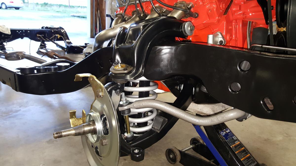

overdrive Posted June 24, 2016 Author Posted June 24, 2016 I changed the front springs color from black to gray last night. I made a special tool to use with my floor jack and installed one of the front springs today. It worked good. Bolted the spindle in place, put the spring in position and jacked it up. With a little help from my wife, I was able to line up the lower control arm bolt holes and she got the bolts started. Dan 1 Quote
orbit Posted June 24, 2016 Posted June 24, 2016 Dan I think the spring look better in grey then black. Car looks awesome. Gotta get back on mine as well. Joe Quote
