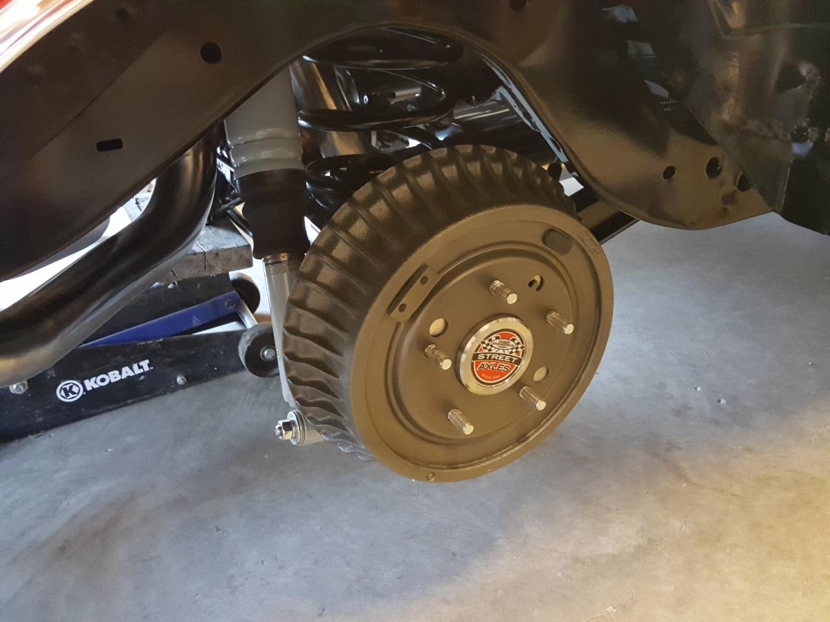

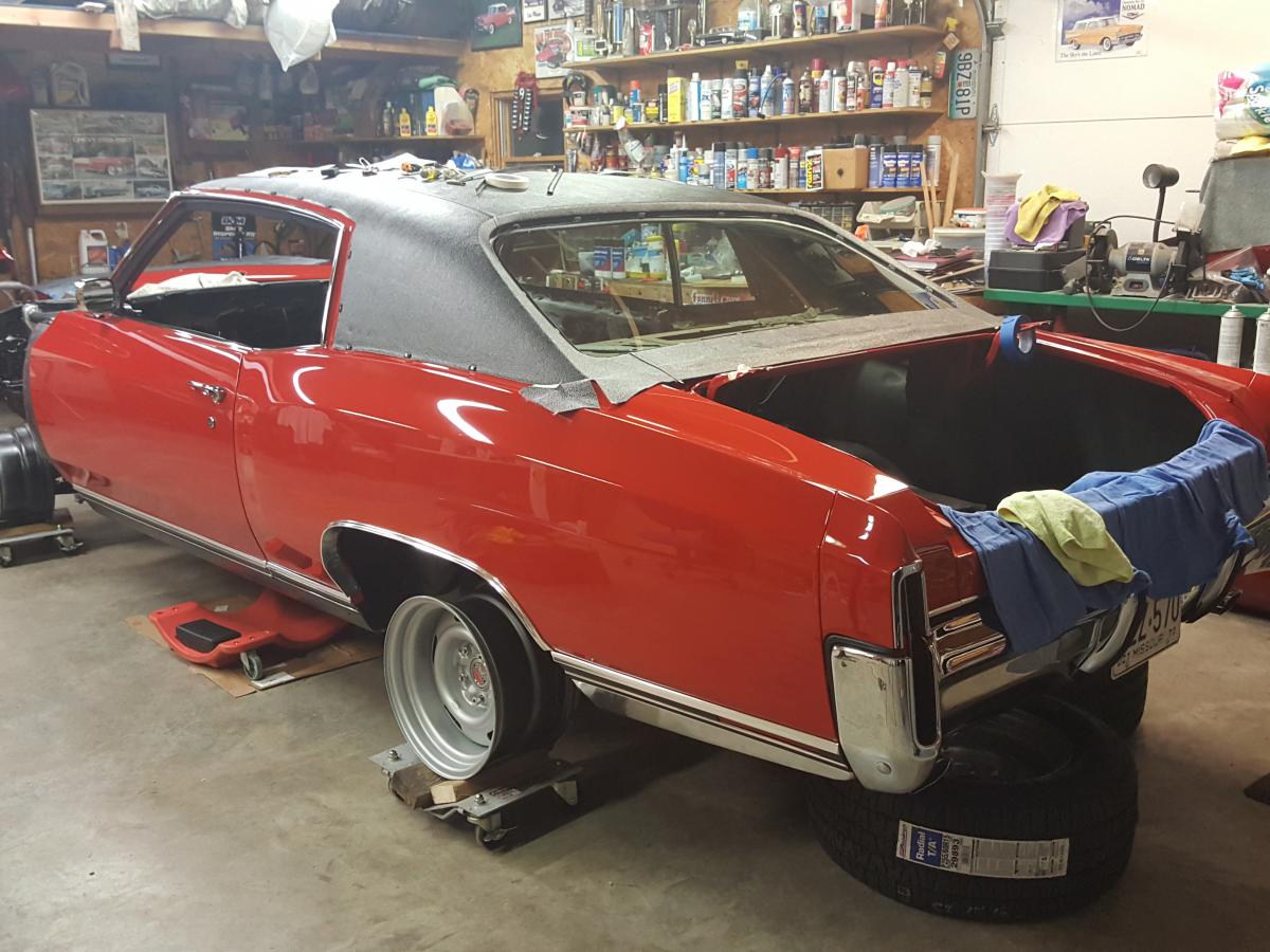

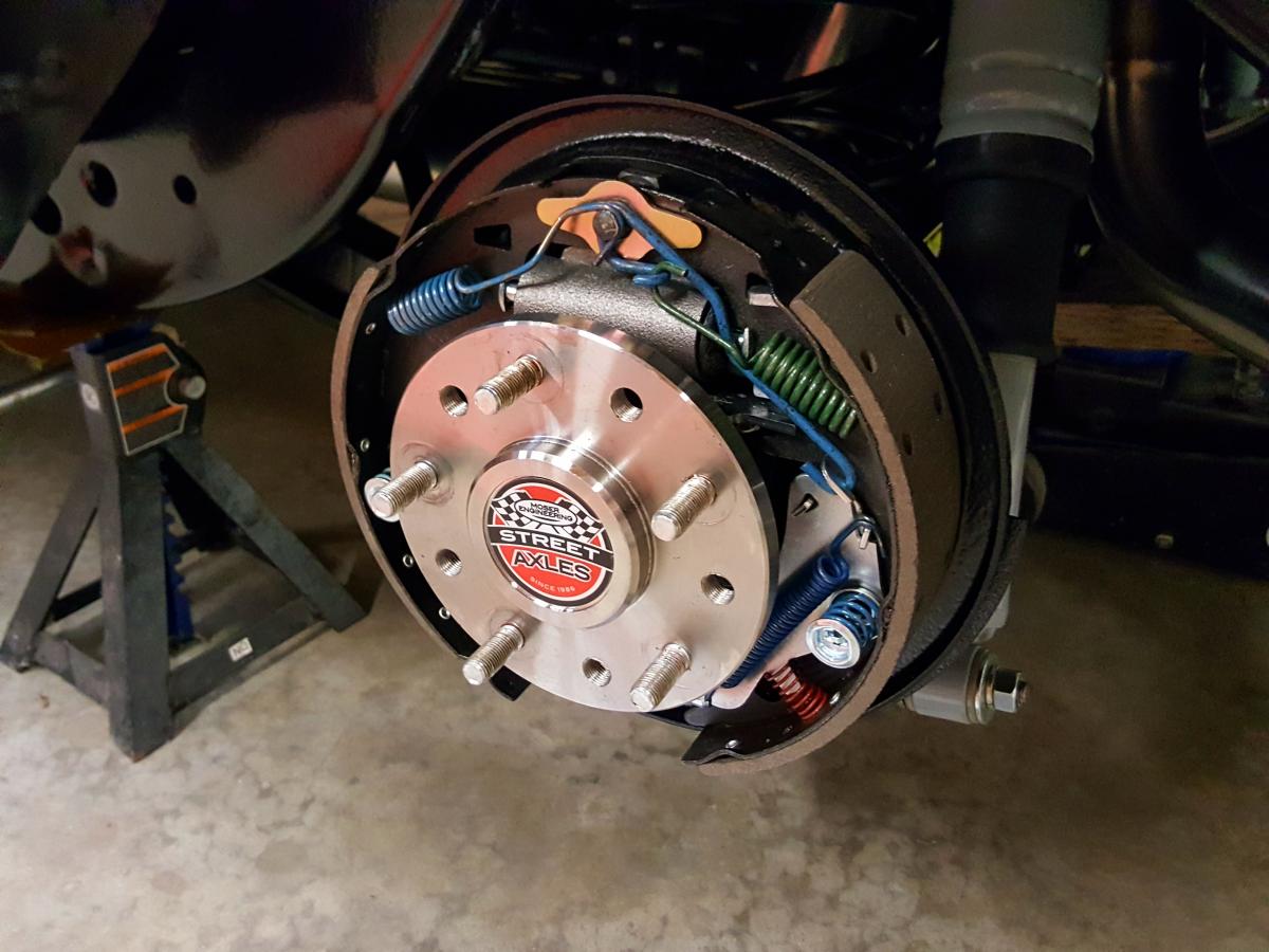

overdrive Posted July 10, 2017 Author Posted July 10, 2017 Thanks, everyone. The skills can be learned by pretty much anyone. Patience is important. I've made good progress on some load leveling compressor brackets for some of our members and worked on my car some more. My 8" rally wheels are Chevrolet originals with 4" backspace and the rear tires were pretty close to the wheelwell lip. My new Moser axles have thicker flanges that put the tires even closer to the lip, so I bought 4 new rallys with 4 1/2" backspace. USA made and nice wheels with powder coat. New tires came in Wednesday. The ones I had on this car have been on our Nomad for several years now. I buffed and polished the taillight lenses and they cleaned up really well. Rewrapped the trunk wiring harness and got the taillights installed with new bulbs. Shot spatter paint in part of the trunk to be able to install the wiring and NOS side marker lights. Finished plumbing and testing the new load leveling control valve and the air shocks. Works great. Put the rear brakes on and new stainless parking brake cables. Reinstalled the power window mechanisms and wiring, along with the roofrail seals and the 4 pcs of side glass. Got the cowl and firewall insulation installed. Cleaned, installed, and tested all of the vacuum motors and the heater box. Installed the gas, brake, and parking brake pedals. Figured out the issue with my top radiator hose. Ran the motor for a few minutes with the rear in the air, no tires in place, and the trans in drive so I could check the trans fluid level. Dan Quote
