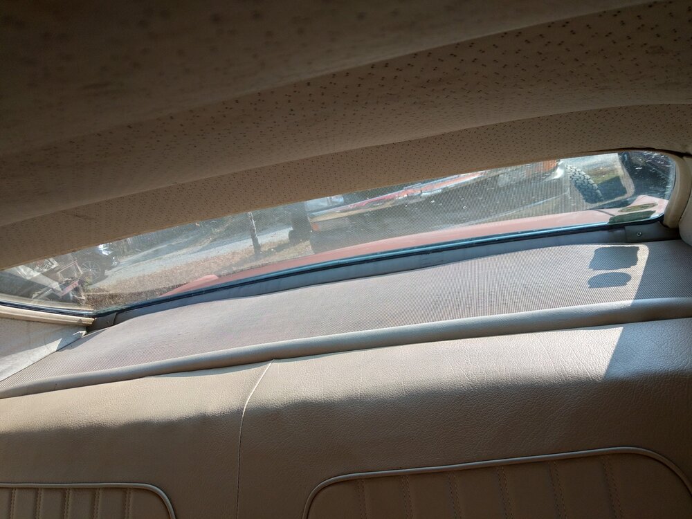

SPLATT71MC Posted October 11, 2022 Posted October 11, 2022 Got the back seat recovered to match the fronts and a new package tray. I know they are a little off color-wise but depending on the color the car gets painted will determine the final interior color. 5 Quote
Steve G Posted October 11, 2022 Posted October 11, 2022 21 minutes ago, SPLATT71MC said: Got the back seat recovered to match the fronts and a new package tray. I know they are a little off color-wise but depending on the color the car gets painted will determine the final interior color. Honestly I like when large stand alone parts are obviously a few shades off rather than a failed attempt at trying to color match ... I think it looks nice like that. 1 Quote
SPLATT71MC Posted October 11, 2022 Posted October 11, 2022 On 10/10/2022 at 8:32 PM, Steve G said: Honestly I like when large stand alone parts are obviously a few shades off rather than a failed attempt at trying to color match ... I think it looks nice like that. It doesn't look all that bad, I wouldn't have redone either but the back seat cover was essentially turning to dust and the package tray was warped, peeling and just flat nasty. The rest of the upholstery is in ok shape. Like I said, it will all get redone after it gets painted. I really don't like the interior color, not a fan of earth tones. If I keep the paint orange I'll go black or charcoal and if I paint it blue like I really want I'll go red. 1 Quote

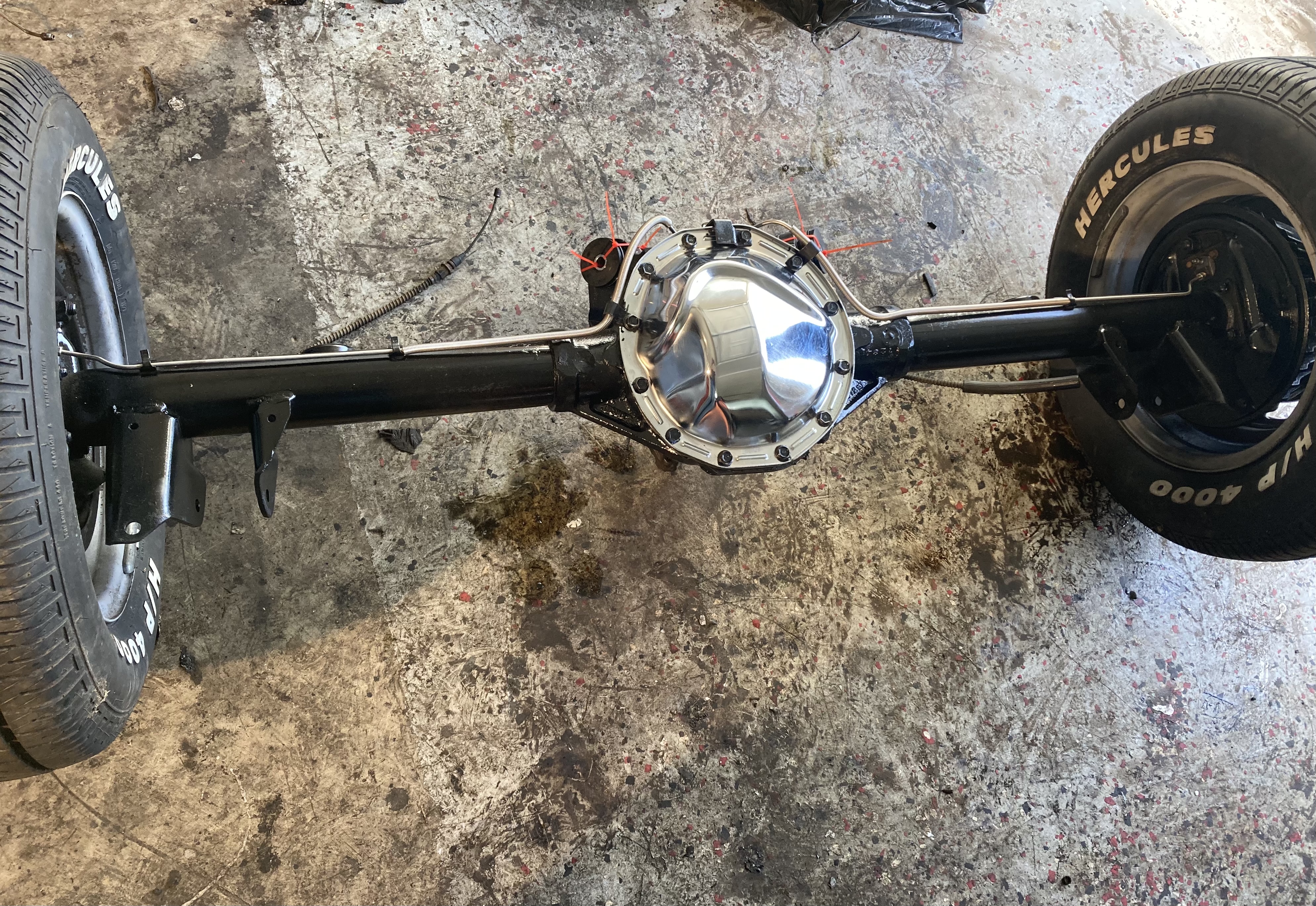

Steve G Posted November 7, 2022 Posted November 7, 2022 couple quick passes with a wire wheel and cheap gloss black paint, new wheel cylinders, stainless brake lines, bushings and a cheap chrome diff cover. This so far has been the quickest and cheapest part of the car. 6 Quote
cny first gen 71 Posted November 7, 2022 Posted November 7, 2022 Hopefully the cheep chrome cover don't leak. 2 Quote
Steve G Posted November 7, 2022 Posted November 7, 2022 11 minutes ago, cny first gen 71 said: Hopefully the cheep chrome cover don't leak. The gasket and tube of RTV I used cost more than the cover .. haha. 2 4 Quote

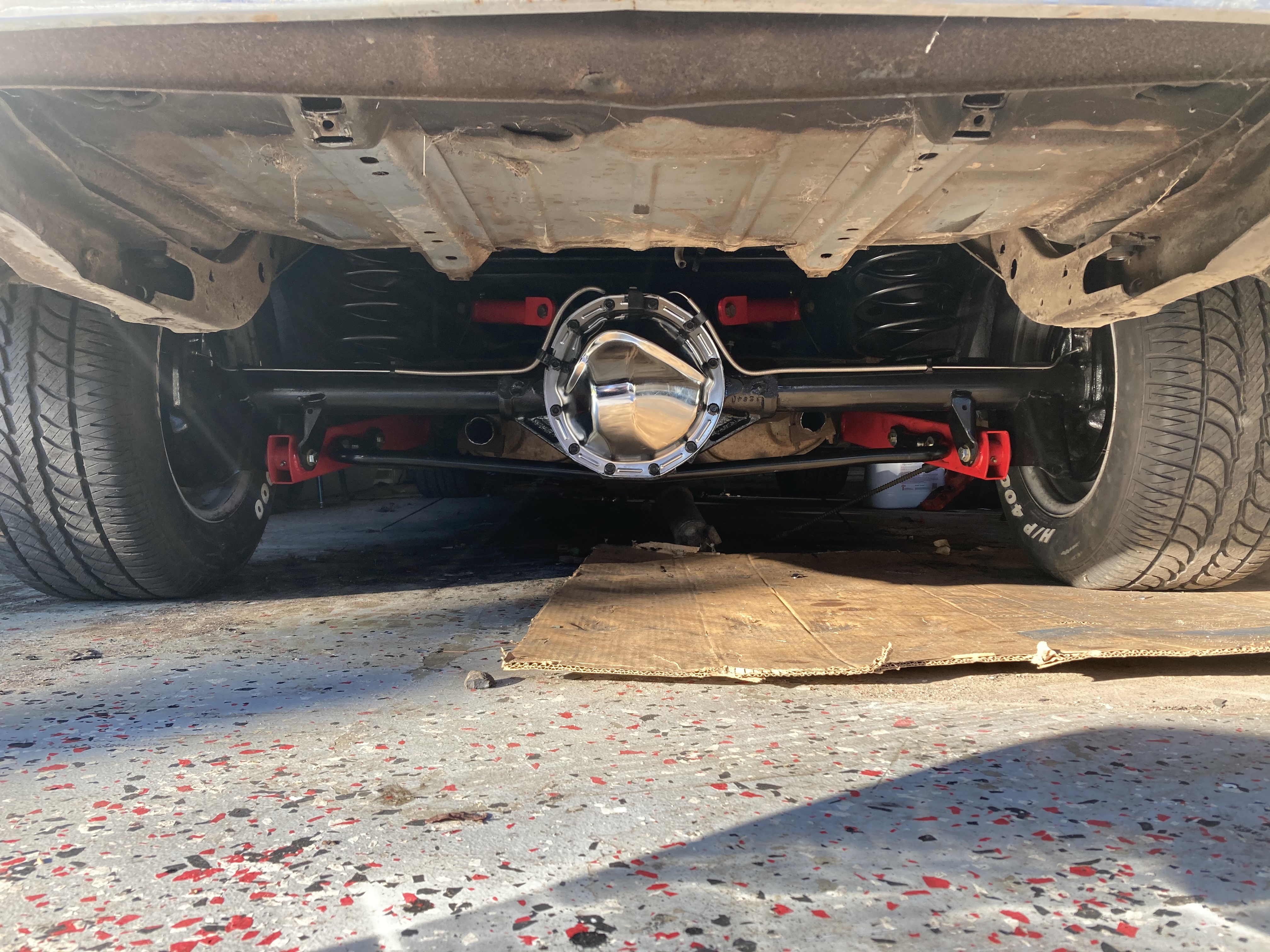

Steve G Posted November 15, 2022 Posted November 15, 2022 I got myself into a situation where I need to move the Monte over and clear some space. So I cleaned up the frame just where the rearend goes, bolted on my new control arms that were supposed to be not-red but I’m ok with it, added a sway bar (because you guys told me to) and some new non saggy springs. Not done but I think it looks good for a weekend driver. 8 Quote
Michael Boyte Posted November 15, 2022 Posted November 15, 2022 It looks great 👍 You did a fantastic job with that and it's something that will draw the attention of those who are following you !! You will definitely notice a big handling difference with the sway bar as well as upgrading the springs and boxed control arms . 1 Quote

Scott S. Posted November 15, 2022 Posted November 15, 2022 18 hours ago, Steve G said: I got myself into a situation where I need to move the Monte over and clear some space. So I cleaned up the frame just where the rearend goes, bolted on my new control arms that were supposed to be not-red but I’m ok with it, added a sway bar (because you guys told me to) and some new non saggy springs. Not done but I think it looks good for a weekend driver. Could have gone green.... Quote
Steve G Posted November 15, 2022 Posted November 15, 2022 1 hour ago, Scott S. said: Could have gone green.... In my 20s I have probably sprayed 600 gallons of John Deere green.. just looking at that gives me an anxiety attack. 1 Quote

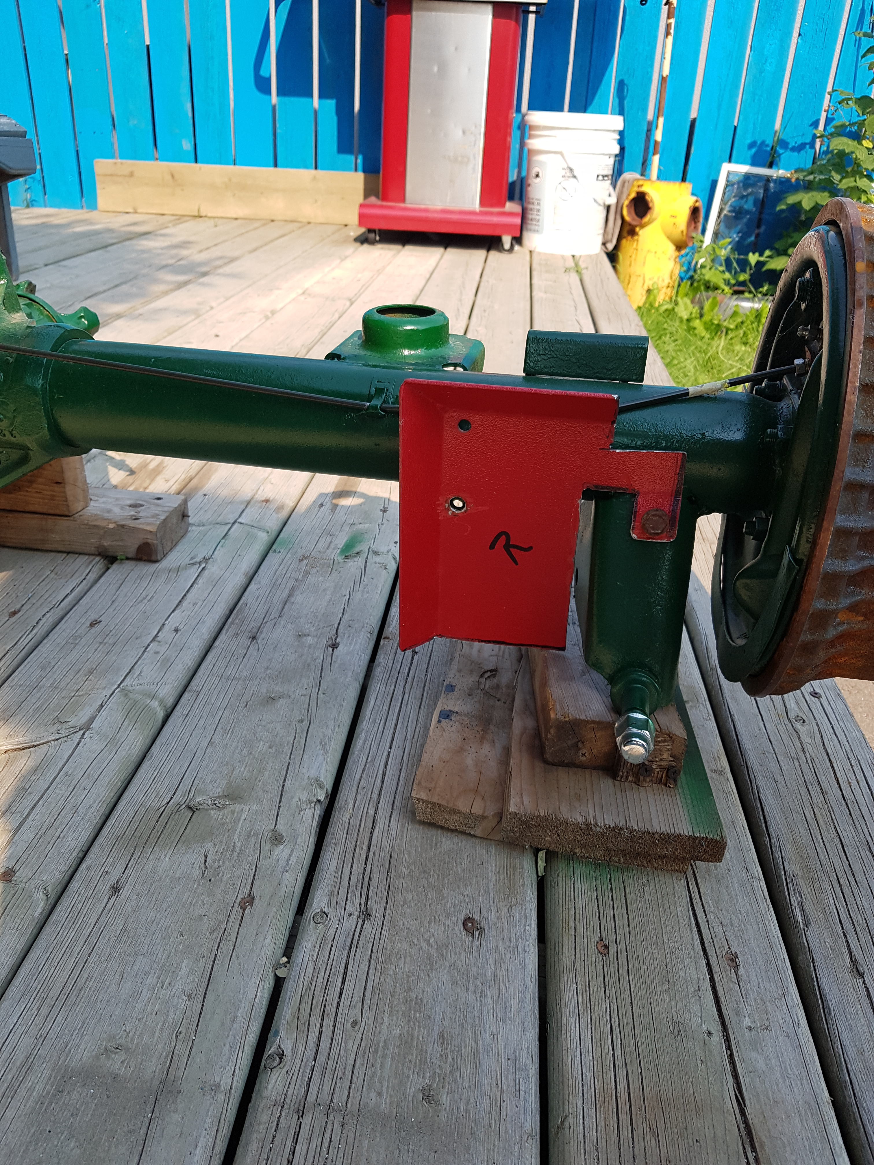

Michael Boyte Posted November 15, 2022 Posted November 15, 2022 With the shock protector plate, most likely would be for an SS454 .. If not, it definitely had air ride. I am sure the rear end will match the car. Quote

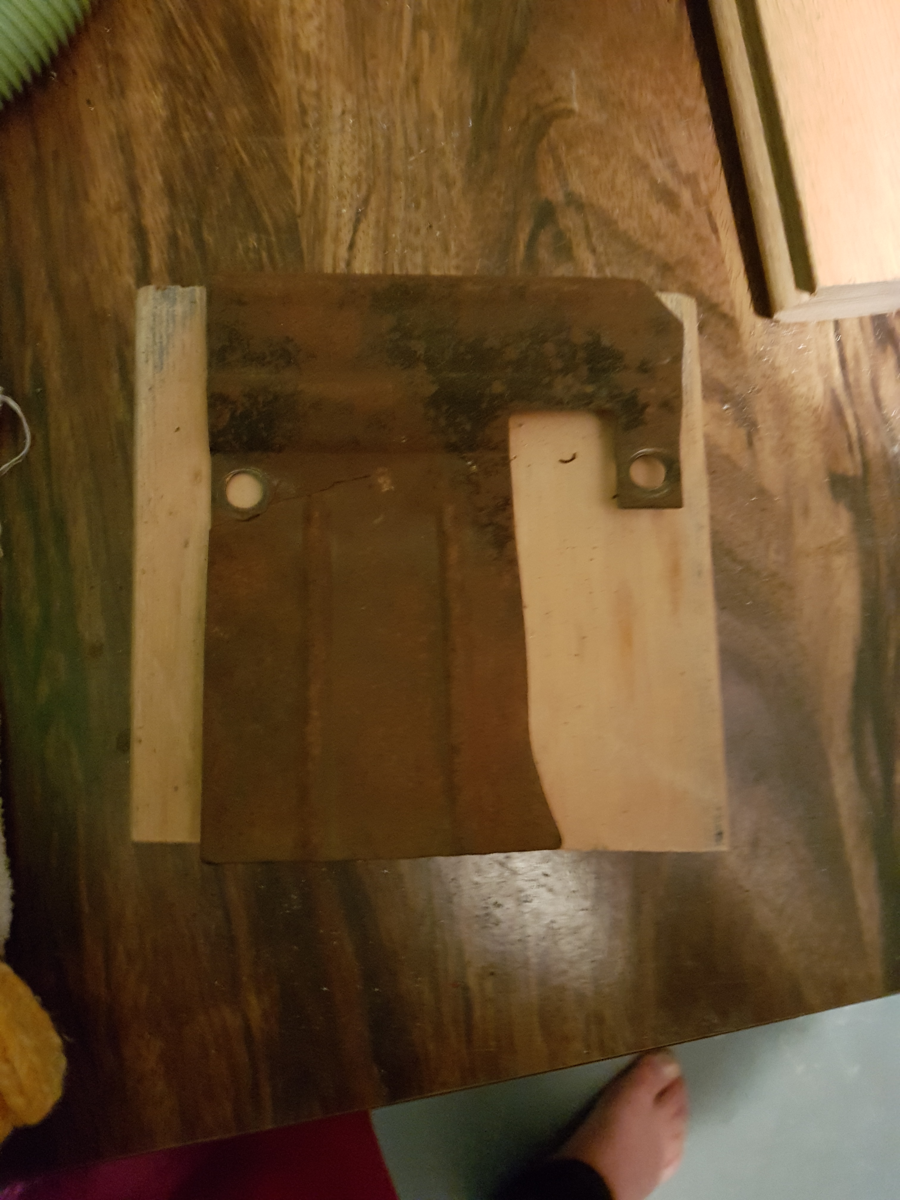

Rob Peters Posted November 15, 2022 Posted November 15, 2022 Are thise home made shock protectors or did you buy them after-market someplace. rob 1 Quote
Scott S. Posted November 16, 2022 Posted November 16, 2022 20 hours ago, Michael Boyte said: With the shock protector plate, most likely would be for an SS454 .. If not, it definitely had air ride. I am sure the rear end will match the car. The 12 bolt came from a '72 El Camino. The original plates were in rough shape. Quote
Scott S. Posted November 16, 2022 Posted November 16, 2022 20 hours ago, Rob Peters said: Are thise home made shock protectors or did you buy them after-market someplace. rob They're home made.... The originals were damaged, so I copied the pattern onto a piece of 3/16" plate steel. 2 Quote
Scott S. Posted November 16, 2022 Posted November 16, 2022 Switching from the 10 bolt to the 12 bolt widened the control arms enough to rub the exhaust.... Had to re adjust a few hangers to get rid of the rattling noise. Otherwise, it went in perfectly. Even used the same U-joint. Quote
