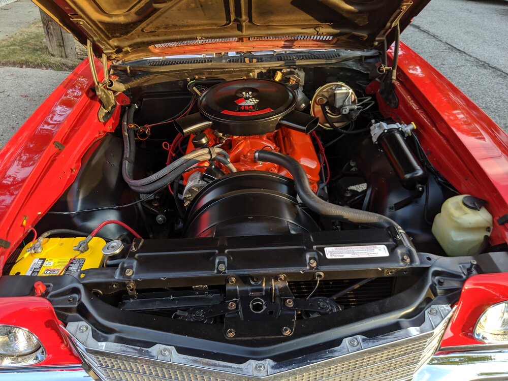

Don't understand why it doesn't fit. I have an RPM air gap, 1" open spacer, Holley carb and stock (for a big block 70 Camaro) air cleaner assy on Big Red with no interference. 🤔
Is it hitting an under hood brace? If so, can you "manipulate" it for the needed clearance?
My intake has 1” on an air gap plus my air cleaner lid is far taller than yours. It is a factory 402 air cleaner.  I’m just going to modify the air cleaner base.
Gotcha. That makes sense. The Camaro air cleaner is made to fit a Holley carb and is dropped more than yours with a Qjet.
Idk if you are running the Qjet but if not and you have a Holley on there you will have to make holes in the base for the float bowl adjusters to pass through the get the base lower besides bending the base itself.

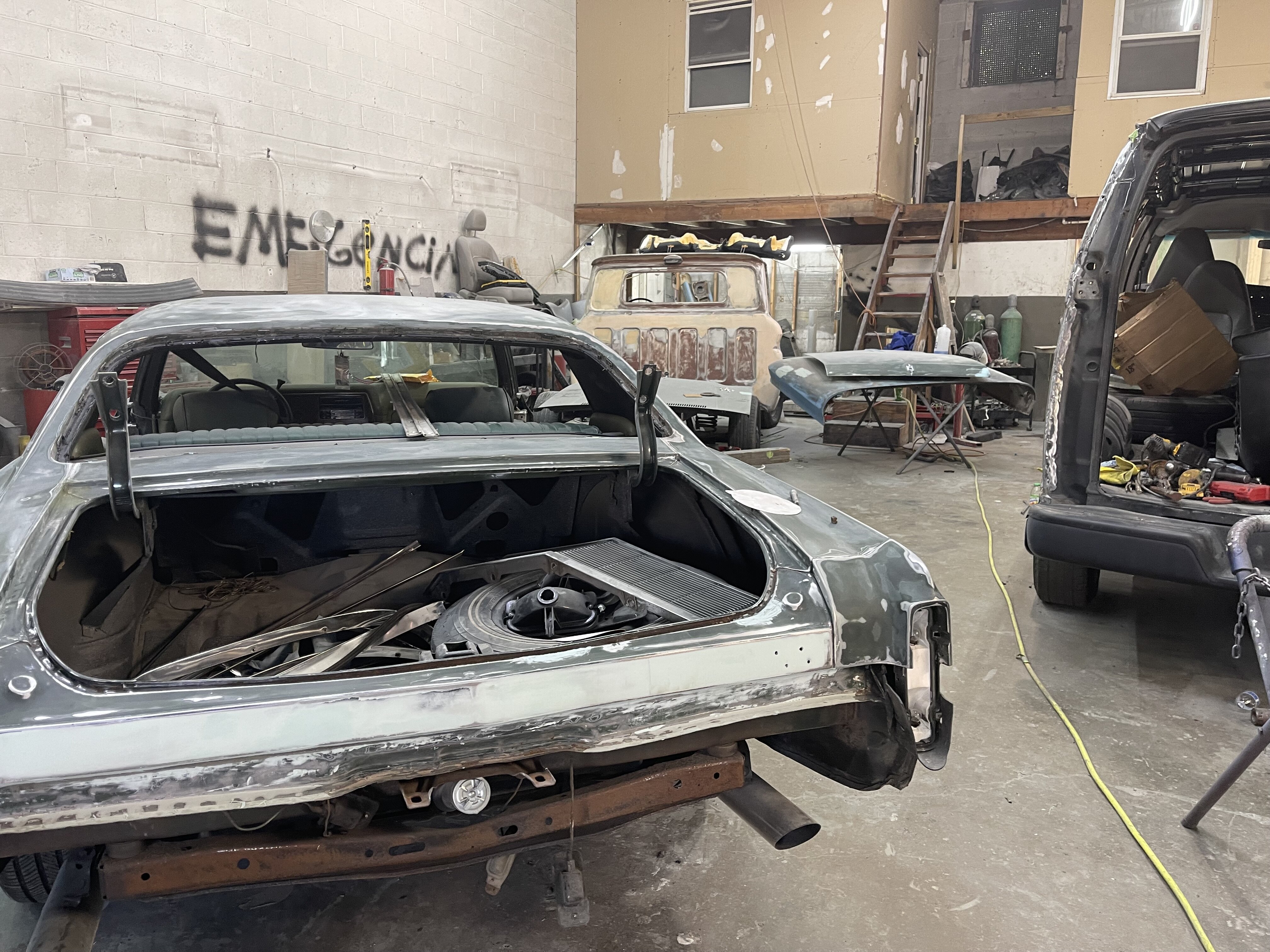

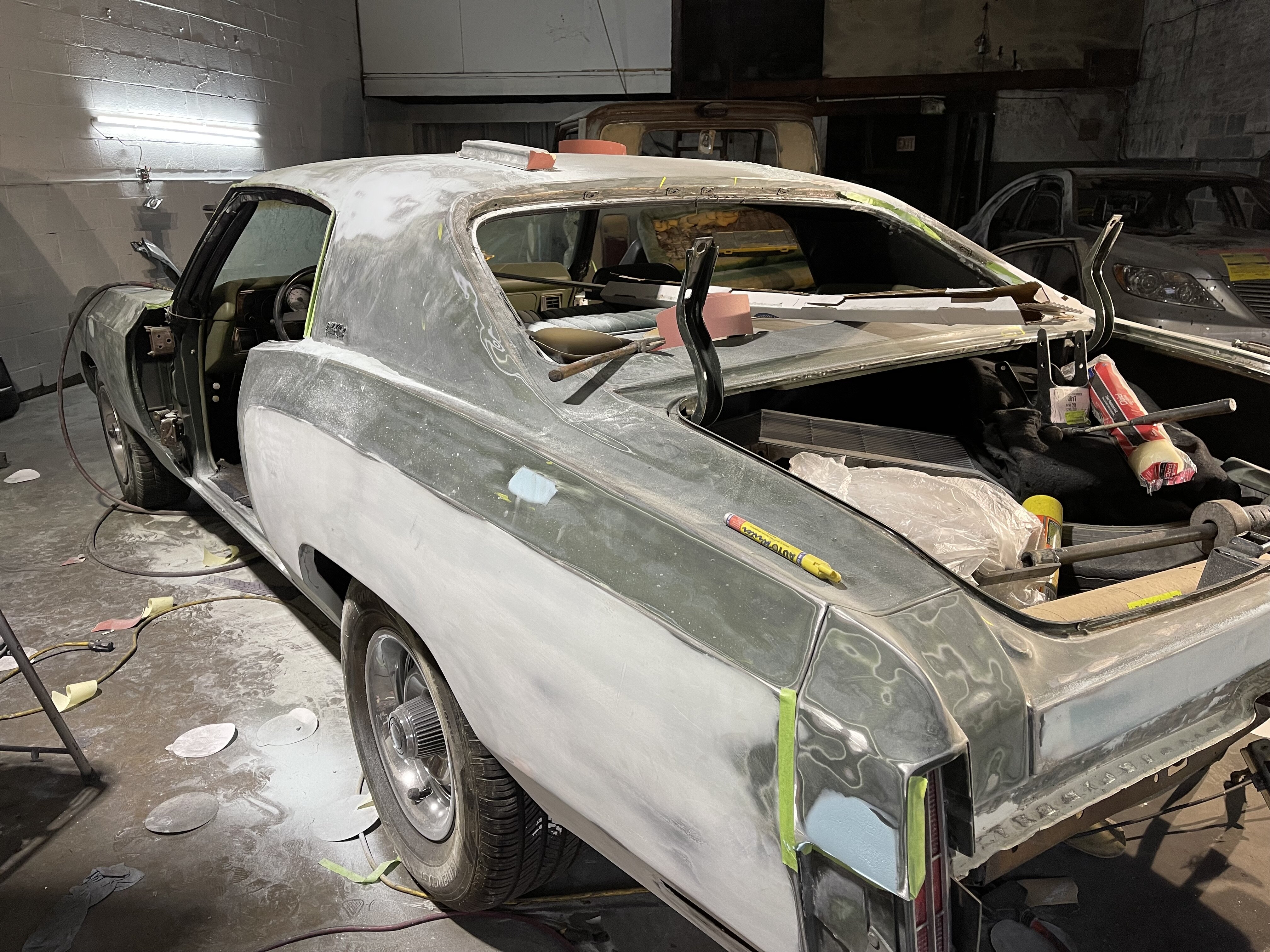

Went to the paint shop today, I’ve had girl friends that kept their promises better than these guy, they made some progress doors hood and trunk lid primered, it was due Sept 29, maybe Christmas but I’m not holding my breath
  • Like 4
Looking good. Are they going to remove the sailpanel emblems or paint around them? 🤔 They just pop off... Carefully. Barrel clips hold them in.
Joe she is coming along very nicely!!!  You know what they say, if they tell you 4 months you have to double that time. So in 8 months your car should be done!!!
I know the anticipation is a killer, been there done that!!  lol
