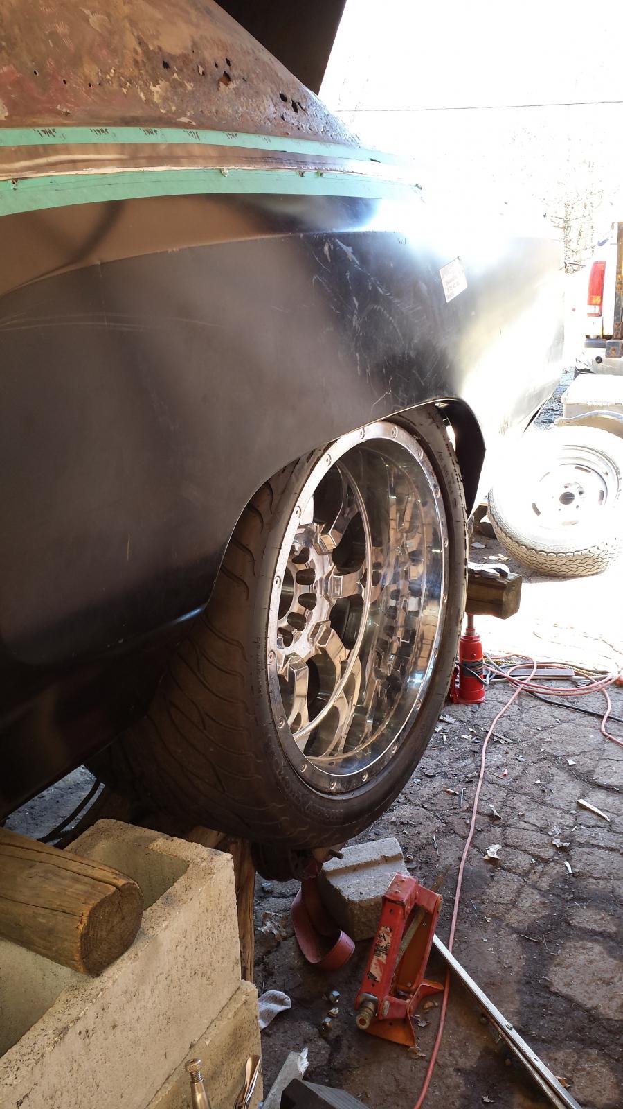

Boots Posted May 3, 2015 Posted May 3, 2015 Ahhh what a gorgeous weekend..took the kids camping in the back yard..copious amounts if coffee and bacon..got a 20 pack of cut-off disks..on sale...and NOW I will start my 1/4 panel work..burn 1 in and cut the other off ...SOOO envious of those that are rolling..even got a tear when I passed a 72 on the highway.....maybe for my 50th it'll be almost done Quote

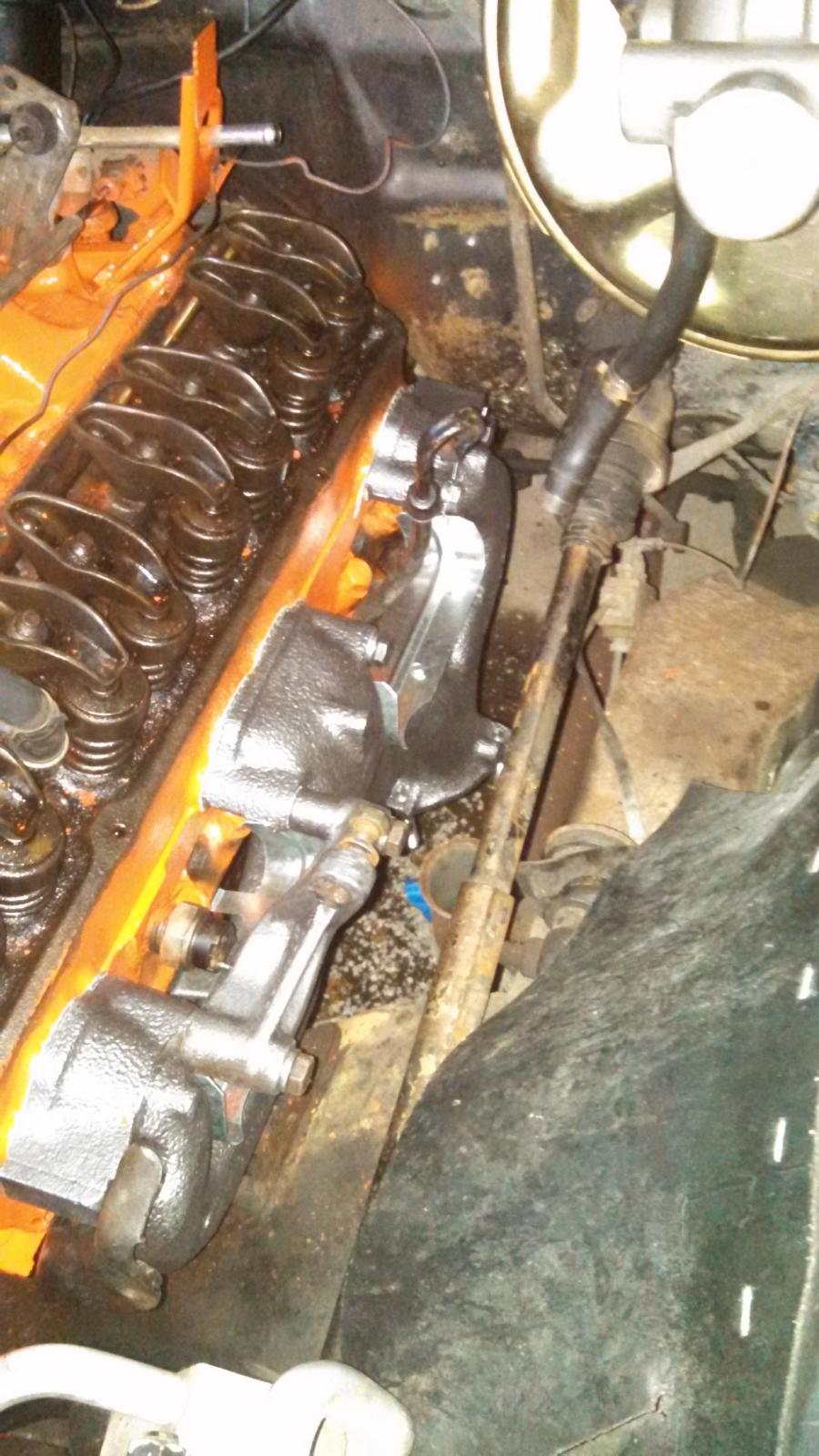

Rob Peters Posted May 4, 2015 Posted May 4, 2015 I am at the point of being able to start the reassembly. I wanted to install the Exhaust manifolds an I had started doing the passenger side when I realized I had not put the studs for the exhaust pipes into the manifolds so I removed the passenger side again. I started installing the studs but they would not go more than 1/2 thread into the manifolds so I had to take them back home. What I found was when I had the old studs removed the guy who did it did not run a Tap through them to clean the threads. Since I could not install the manifolds I started installing some of the other items. I installed the coil, carb, all the vacuum lines, carb linkages and spark plug heat shield brackets. I also found "The Parts Place" sent me the wrong Exhaust Manifold bolts. The set they sent me were all 12 bolts the same length but I think the set they sent me is for a non-air conditioning car because there is an extra bracket for the compressor support. It may be a few days before I get back to the reassembly if I have to get the correct bolts or maybe use the two old bolts. When I got home with the manifolds I ran a tap through the manifold holes and this solved the issues studs not threading up into the manifold. Rob Quote
Boots Posted May 4, 2015 Posted May 4, 2015 I appreciate the kudos of encouragement gents..and with that ....well I finally got the drivers 1/4 on..yahoo..my oldest lad said today he can't wait to be dropped off at high school and get out of this car..(I'm thinking he will want this for grad..in 5 years..that's too soon for me) Quote

Rob Peters Posted May 5, 2015 Posted May 5, 2015 Well, I have started the reassembly. I have gotten the manifolds, Spark plug heat shields replaced, carb back on. It is supposed to rain the next few days and since it is in a storage garage i won't be able to work on it. Sorry about the quality of the pictures but it was starting to get dark and the flash tends to distort the colors and quality of the pictures. Quote

Rob Peters Posted May 10, 2015 Posted May 10, 2015 I have gotten a little more done on the Monte. I re-torqued the exhaust manifold bolts, installed the valve covers and torqued them. As per the instructions that came with the gasket's and the gasket seal, I allowed the gasket to take a seat for a couple hours and re-torqued them. I installed the new spark plugs, plug wire retainers, plug wires, and all other wires which had been removed. I looked at the distributor cap and rotor and they were both looking shabby so I got new ones. The heater hoses are reconnected using new tower clamps because the old ones were looking a bit rusty. I have ordered a new radiator hose from Lutty's. I still need to install the new Rotor, Distributor cap, radiator hose, vacuum hoses, new radiator hose tower clamps, and a few other items. I need to refill the radiator with Anti-Freeze, change the oil and filter and other house keeping items and do some cleanup and she will be ready to roll. rob Quote
Rob Peters Posted May 12, 2015 Posted May 12, 2015 The rain cut my work time short tonight. I continued with the reassembly of the engine compartment. Installed the new rotor, distributor cap, air conditioner compressor brackets and compressor, power steering pump brackets and pump but no belts yet. I got delayed a bit tonight because I ended up with an extra bolt in the bag I had for the Air Conditioning compressor. I broke out the assembly manual and finally found where it belonged. I didn't even remember removing that bolt. I also installed the PCV Valve Grommet. Coming along fine, just need more time to work on it. Rob Quote
