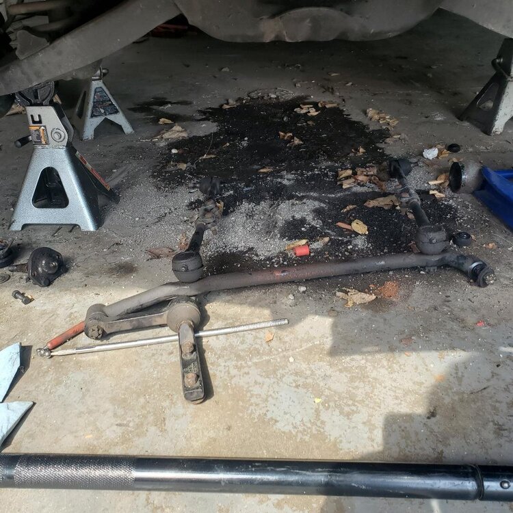

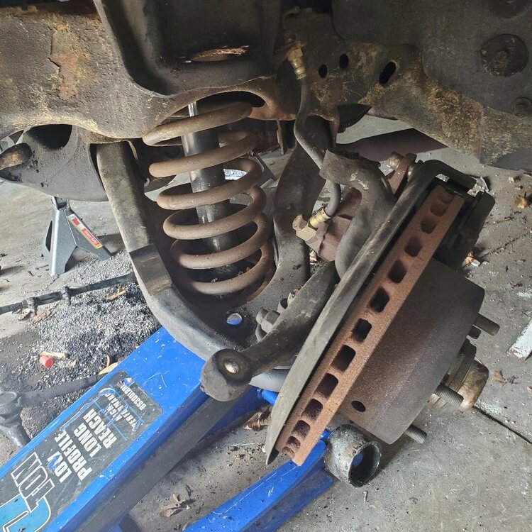

More prep for the Summer Cruise season and trips to the Eastern Meet in Kentucky and our Mini-Meet in Carlisle.  This all started last week with doing an oil change.  While it was up on jack stands I noticed a slight wear on the edge of one of the front tires so I started checking the front suspension.  There was no play in the ball joints but I found a lot of play in the Idler arm, inner and outer tie rods.  Last time I had it up on stands I had checked these items.  Being upset about the added work ahead, I accidently kicked the oil drain pan and spilled oil all over the place.
Even though the ball joints checked out OK, I noticed the boots on the upper ball joints were both torn.  So the demo started and an order for:  Inner tie rods, Outer tie rods, Tie rod adjusting sleeves, Idle arm, Upper ball joints and Stabilizer link kits.  I also ordered bushings for my stabilizer bar but they turned out  to be too small.  I figured my Monte being a small block it would have a smaller stabilizer bar but it was too thick for the new bushings.
Today I completed the installation of everything and rotated the tires.  I hope to get her realigned next week and other than cleaning her up she will be ready to go.

Upper ball joint removed
Stabilizer bar removed

Tie rods, center link Idler arm and ball joints removed
New parts all installed.
