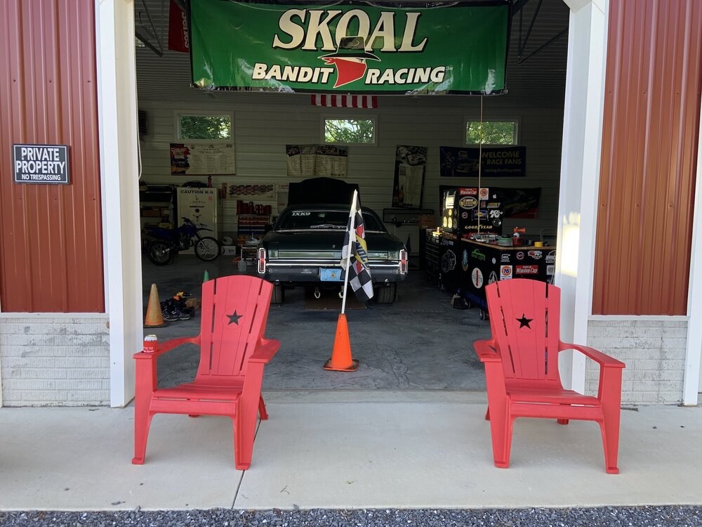

Weekend wrap up. Living between 2 college towns and graduations this weekend I pretty much stayed close to home. So didnt take the Monte out for a run.
Friday did all my post hibernation checks and fired her up 😁 Checked the oil gauge and then double checked the fuel gauge , thanks Glen 🤣 Hopefully this week I'll get a cruise in but looks like more rain ☹️
When I was in FL, saw some GREEN Adirondack chairs at HD for $20, thought they'd be nice in VA so waited till I got in town. Well, no green, or black in stock anywhere ☹️ Checked out Tractor Supply and they had blue and red, AND with cup holders. Thought the blue looked faded so went with red, test drove them tonight 🤣 They don't handle the old school foam koozies well but I had a new style red coozie from Carlisle last year and fit fine.
  • Like 10
Very cool Mark, and i like the star also!!!!

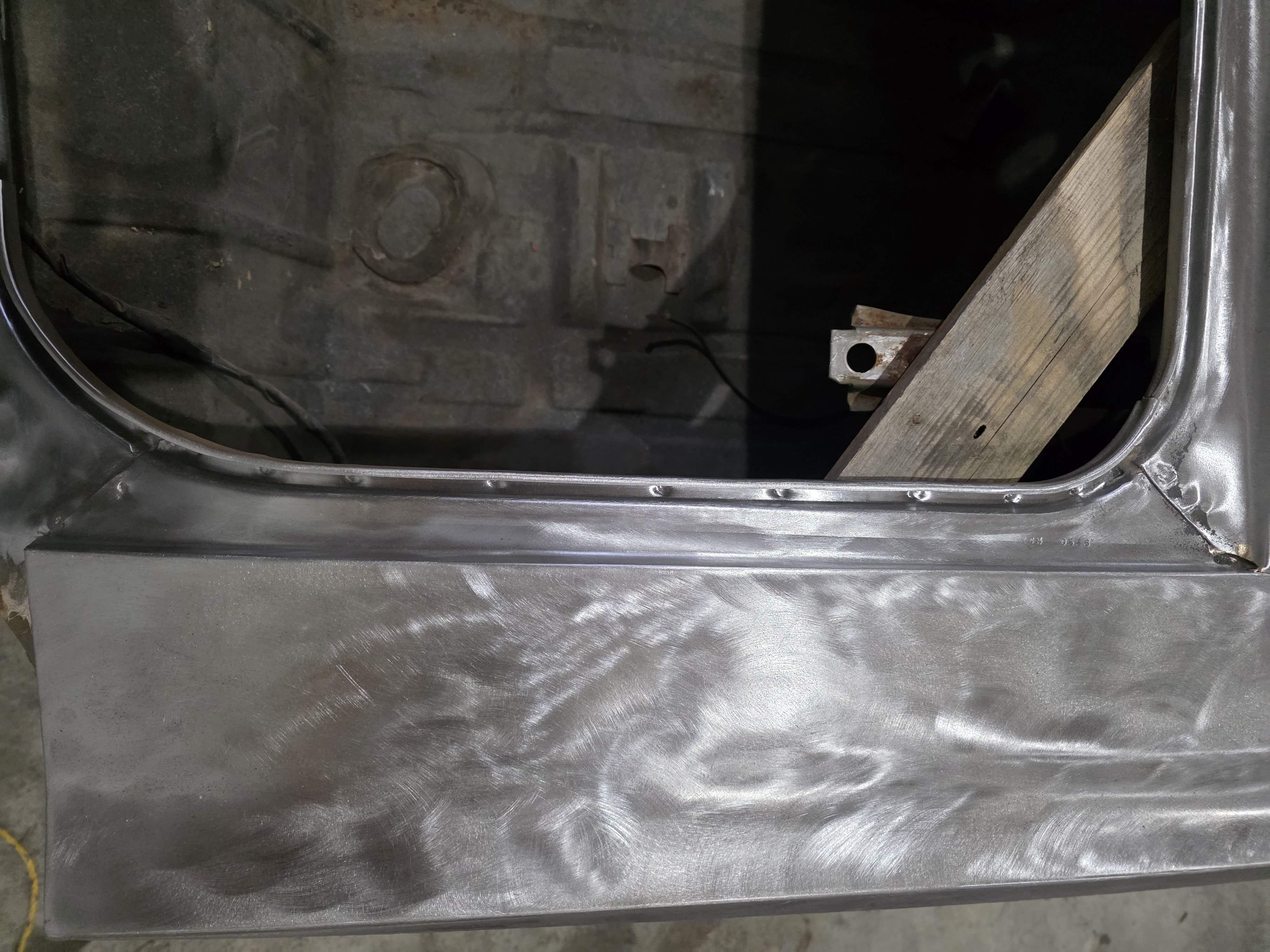

15 hrs of sanding the rear deck lid and deck lid seal area above the trunk, the front headlight extensions, and rear tail light extensions, all down to bare metal in prep for the epoxy primer.

Looks great. I don’t have the patience for that kind of work but the results sure are gratifying.

Nice work, and I like your method for holding the hinges down and out of the way.

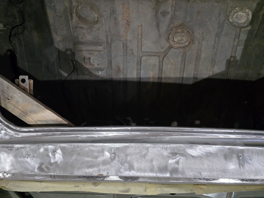

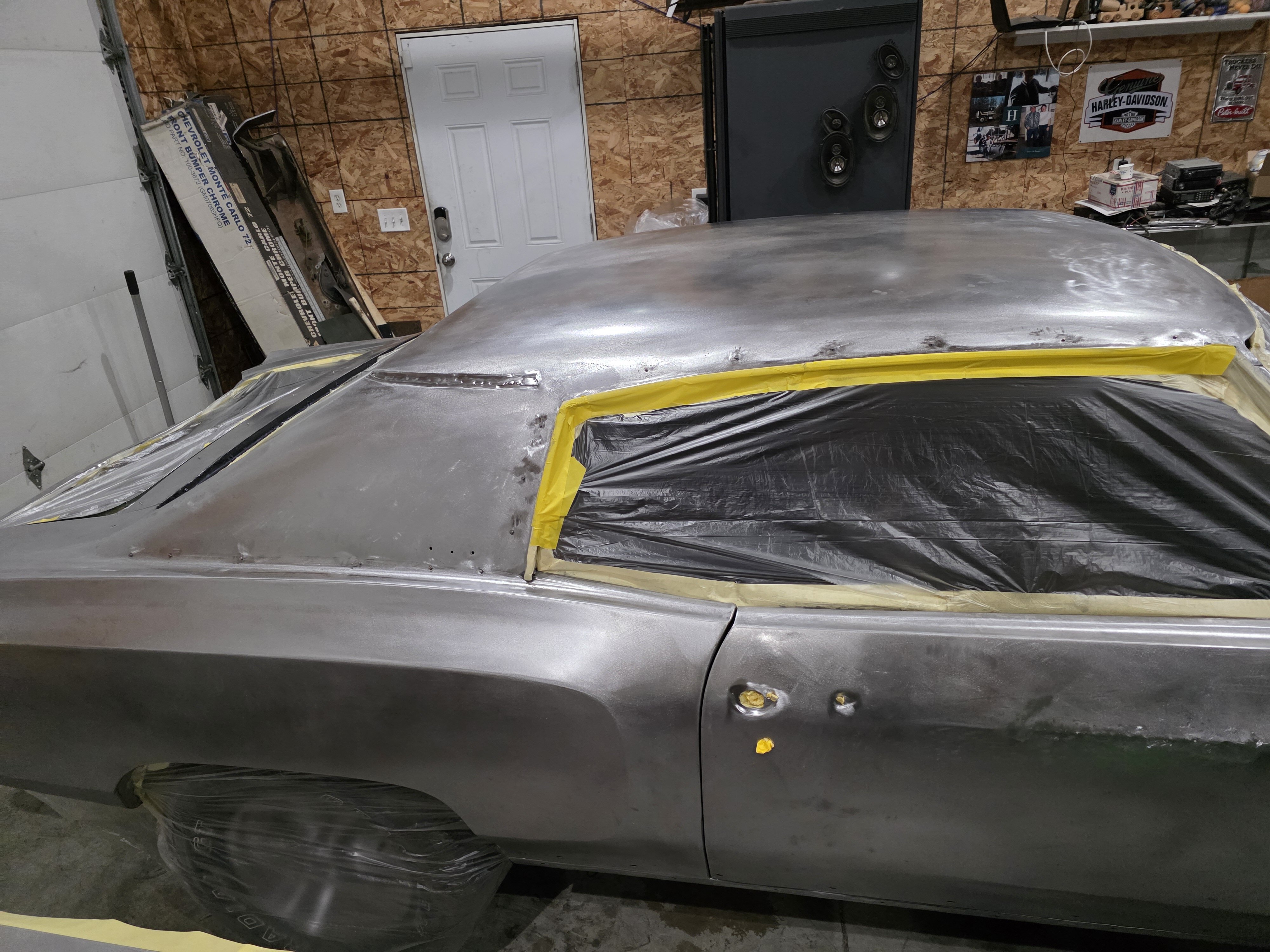

I stripped the factory paint from the rear marker light recesses, the rear deck lid key cylinder hole, and ran a DA sander over all the bare metal on the car.
I only need to clean the two sides of the rear quarter panels where the tail light extensions mount to, then the major sanding is finished until we start to block and sand the car.

I got the factory 53 year old paint, primer, and sealer off the PITA back end last night.
It will get new sealer put back on in all the seams/joints like how it was from the factory.

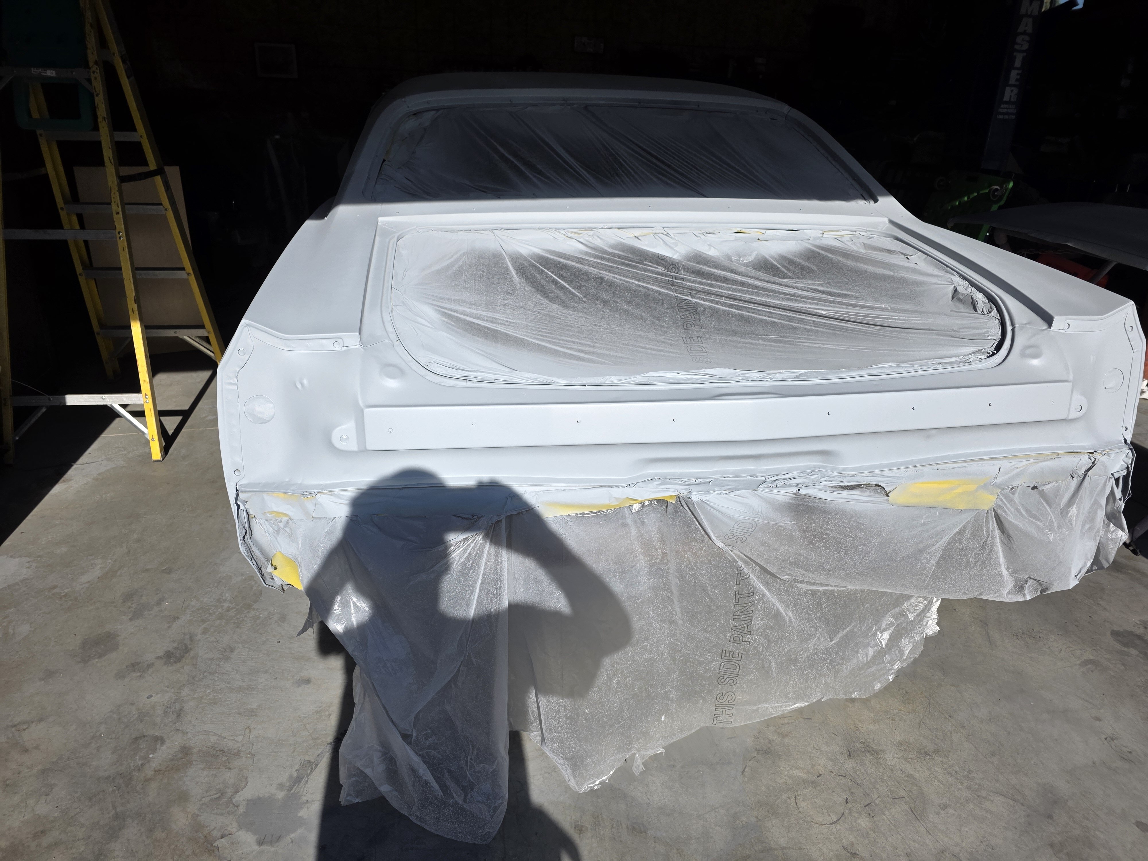

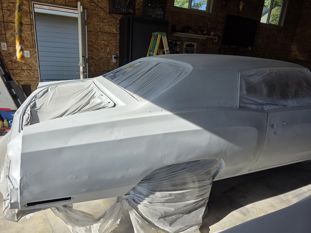

My car is finally ready for the high build primer/sealer, which I think we're spraying on it tomorrow.
  • Like 13
A lot of work and time... looks great.
  • Like 4
Doug you are on your way if She is in primer!!!!

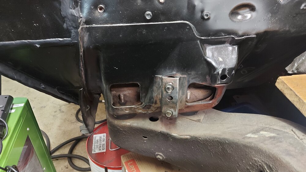

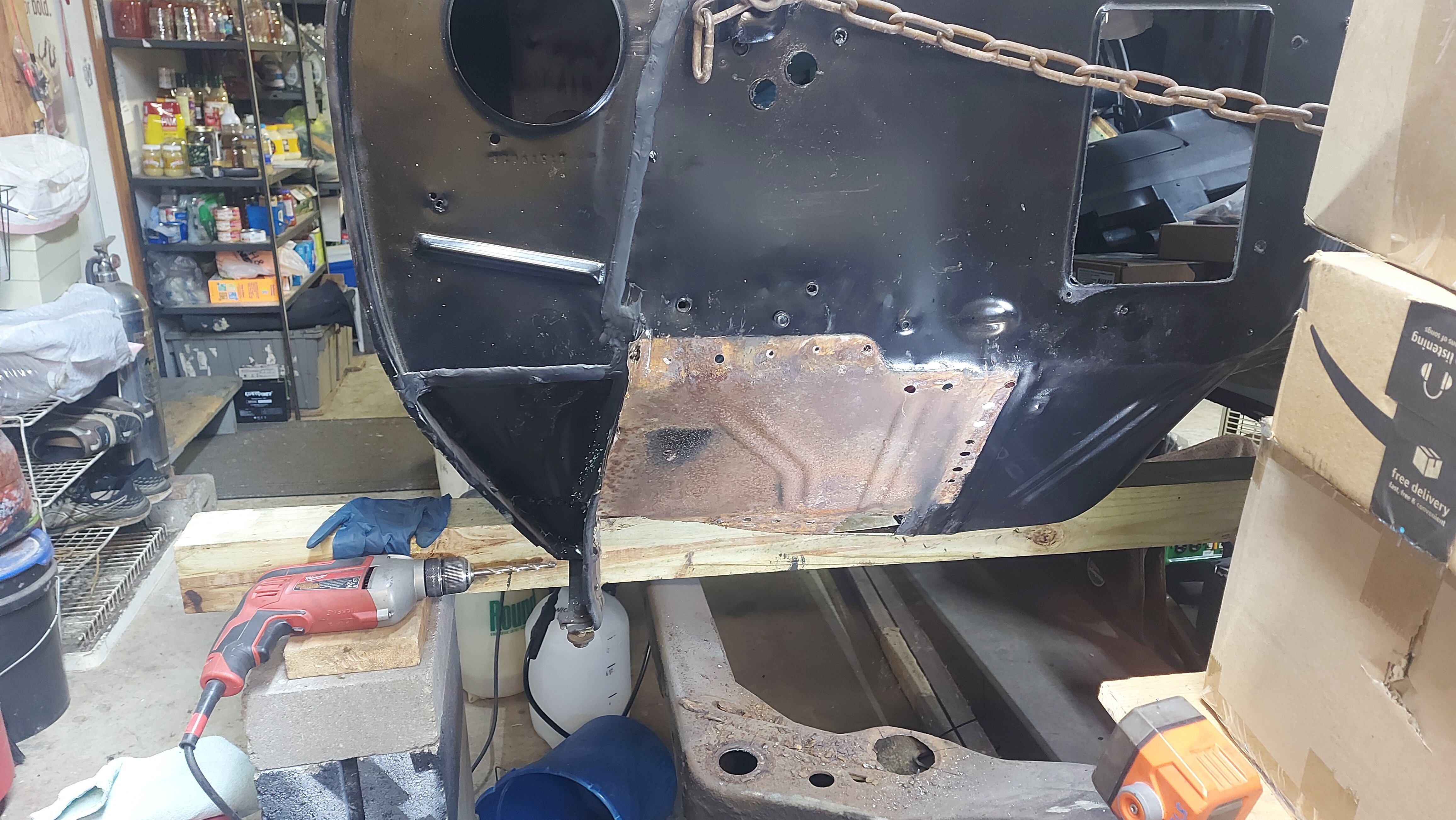

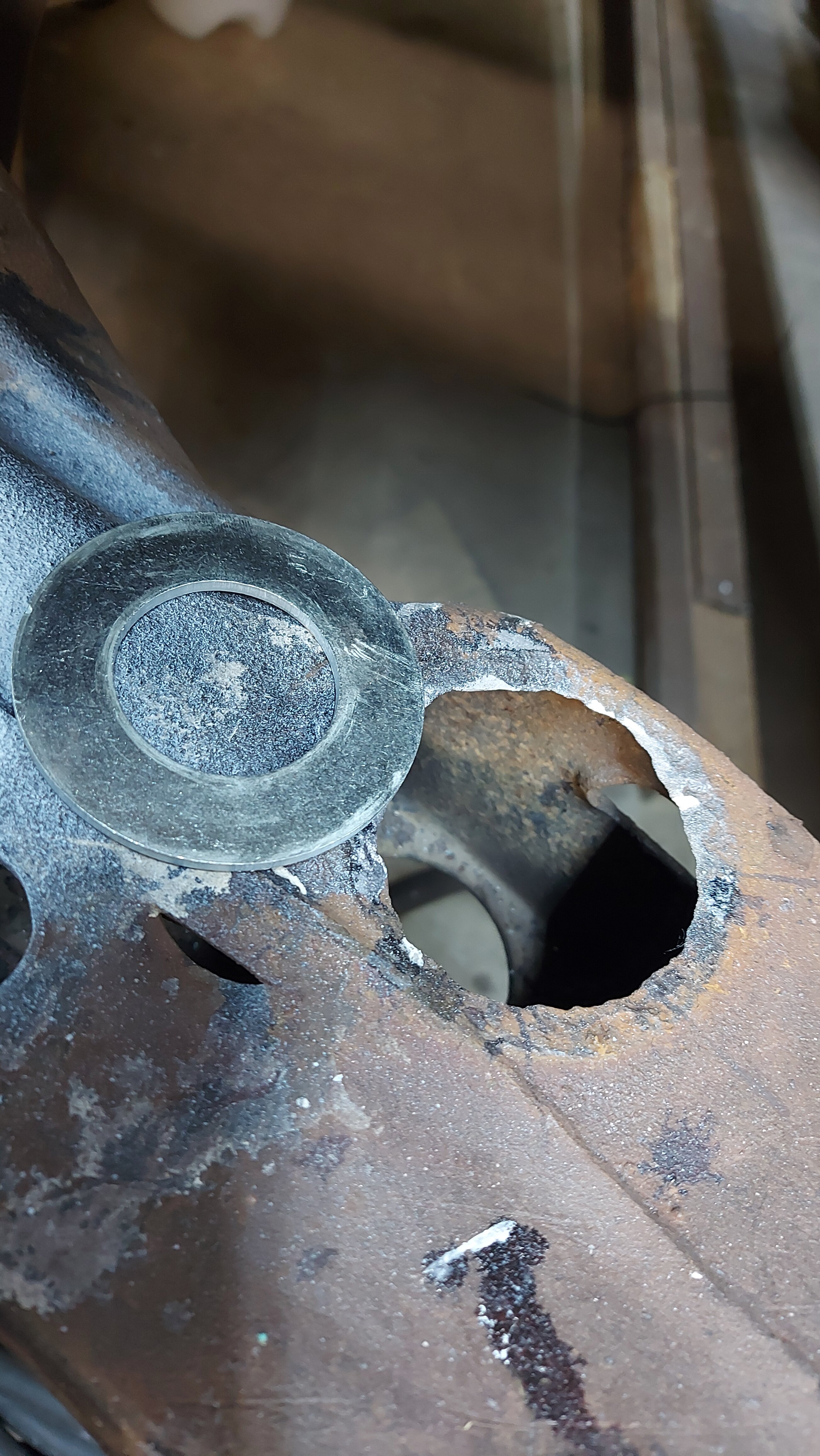

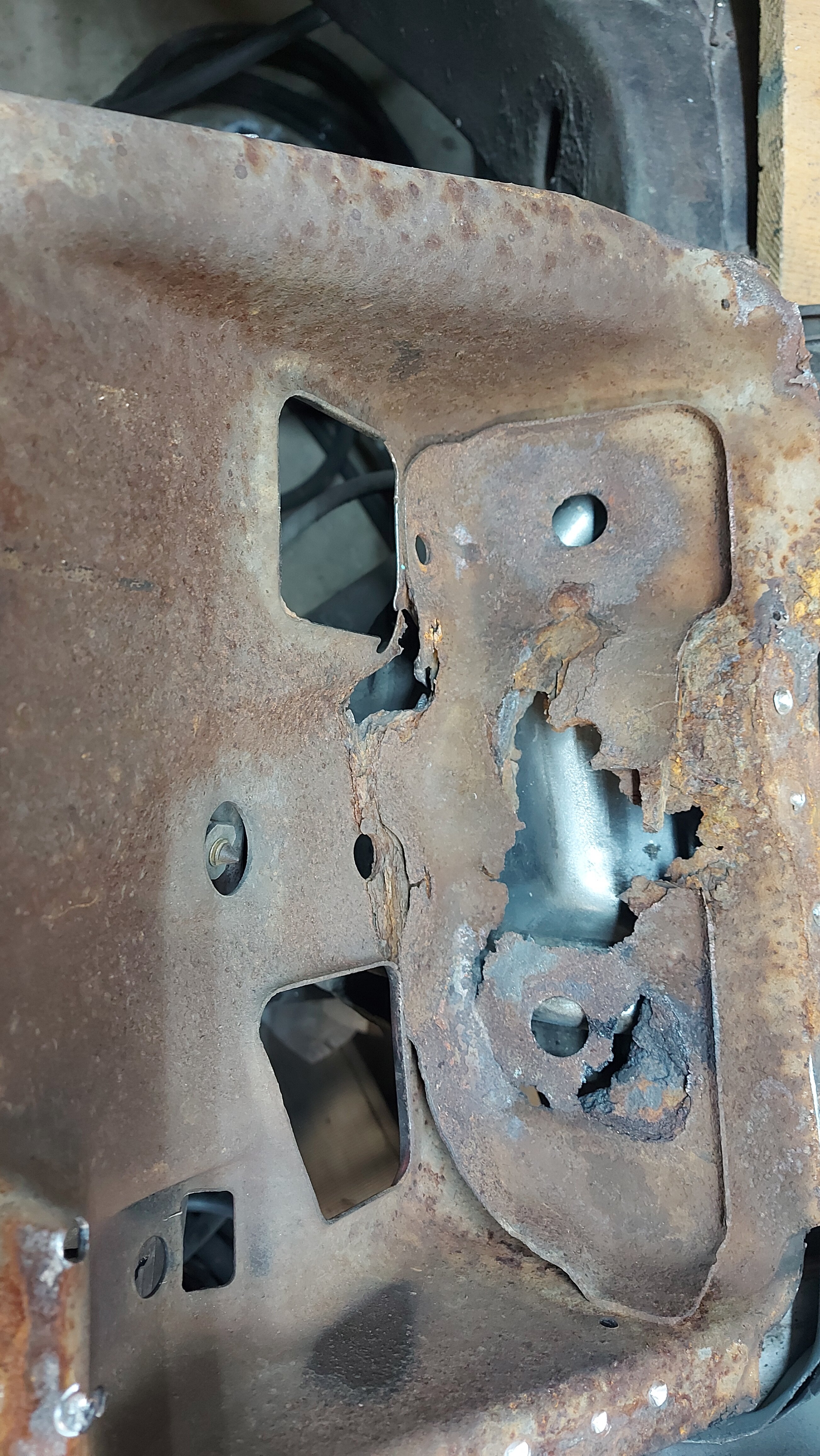

It "fell off"!   Silly me I thought I was going to repair it... FYI, both sides have been on back order since March.  Considering the work it would be to repair, $160 for the pair is reasonable. Onto the frame in while we wait.
It started with a little inspection hole!  ☺️

YIKES !!!
Just a thought on the frame repair washers. I was going to do that on my 70 frame but didn’t because I thought it may throw off all the panel alignment if I did just a few. Sometimes to think about. Is it an all ( 12 holes) or nothing deal. Just curious.
