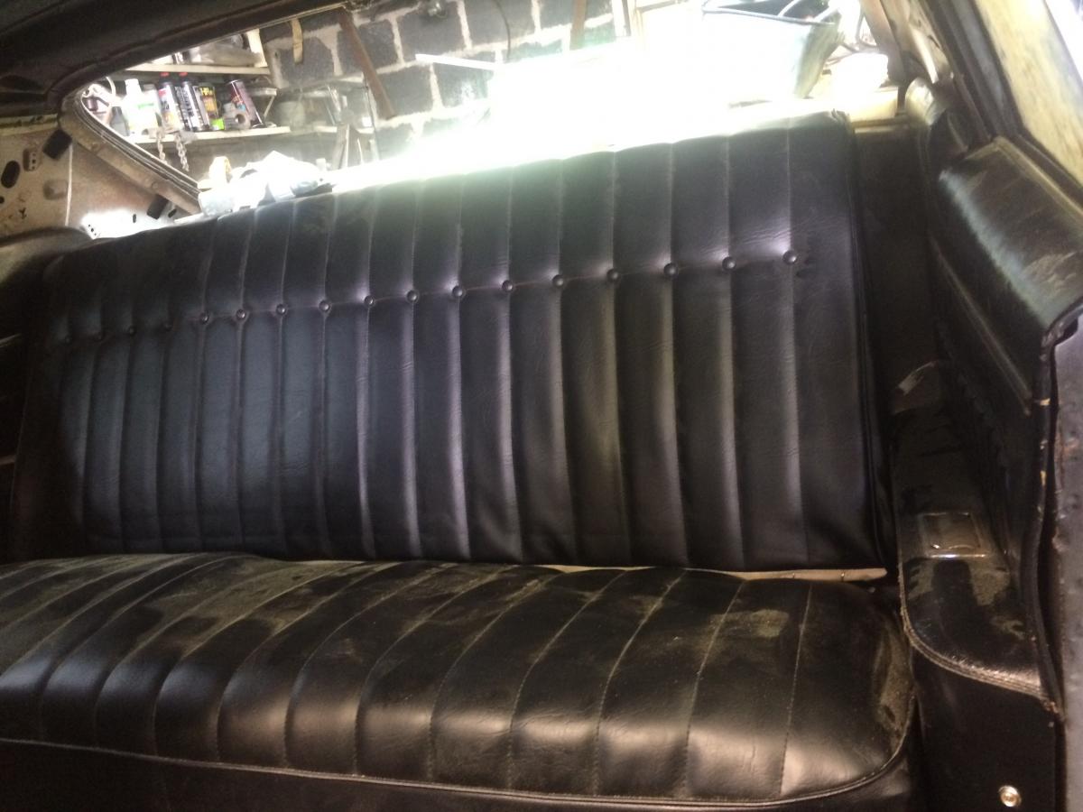

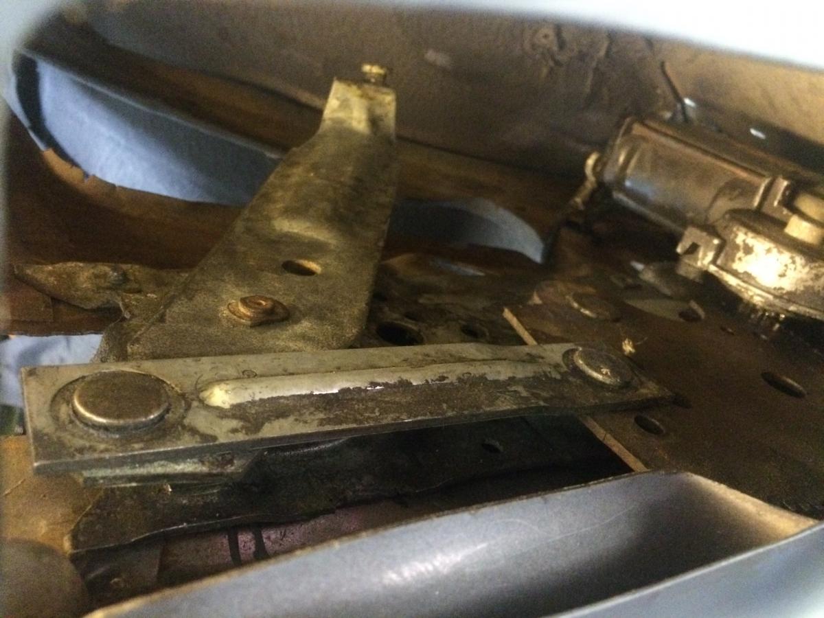

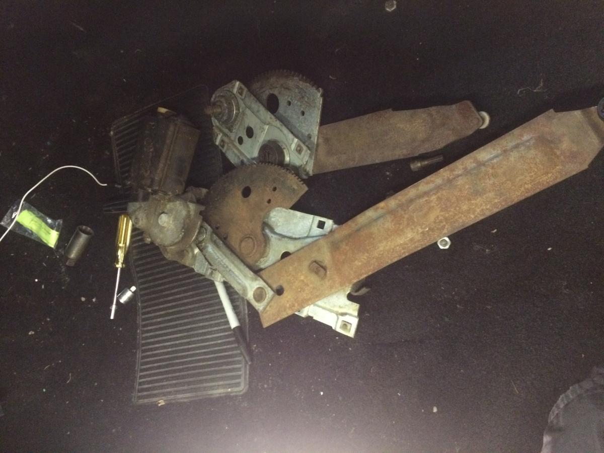

monte70car Posted June 12, 2015 Posted June 12, 2015 Last year I brought a power window setup for the 72 . The last two I've been busy getting the rear windows installed so the rear seat can go back in it took a long time to find the information in regards to installing the quarter windows but I was able to find the post. Final got the power regulators in and test them before buttoning everything and there is no binding, motor did go up and down slowly due to using the power probe to test them. While the rear seat was out I was able to pull the seat cover down further Quote

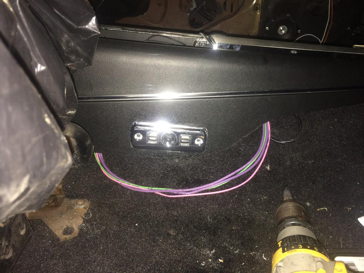

monte70car Posted June 16, 2015 Posted June 16, 2015 Sunday I got brave and cut a hole into the side of my brand new console for the 72 to house the power seat controls. Today I cut the matching hole in the passenger side of the console leaving me with running the wires over to the console. I also did a little more wiring to car and routed some wires to their location as there is nothing to hook them up to. Quote
Bluemalibu Posted June 16, 2015 Posted June 16, 2015 Robert, are you happy with the quality of the console that you purchased? I have been searching for a base that is built well... and after only finding cheaply made units, I had pretty much resigned myself to waiting for a good original to come available. Quote
monte70car Posted June 16, 2015 Posted June 16, 2015 Doug I'm happy with the console even at the price I paid for it. I received the shell, alum top plate that would be found in Chevelle's and El Camino's, the dial plate with the correct white face letters, console door and hinge (didn't come with the lock or retainer), and the rear panel with the light for $400. I just hated the thoughts of putting the holes in it for the switches but didn't have many options. Quote
