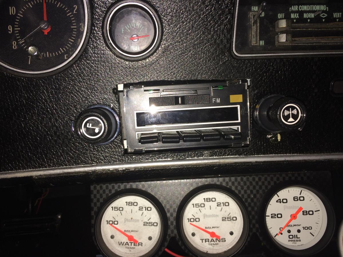

monte70car Posted January 3, 2016 Posted January 3, 2016 Got the radio opening cleaned up and looking better radio is to look stock but has all digital inside. 1 Quote

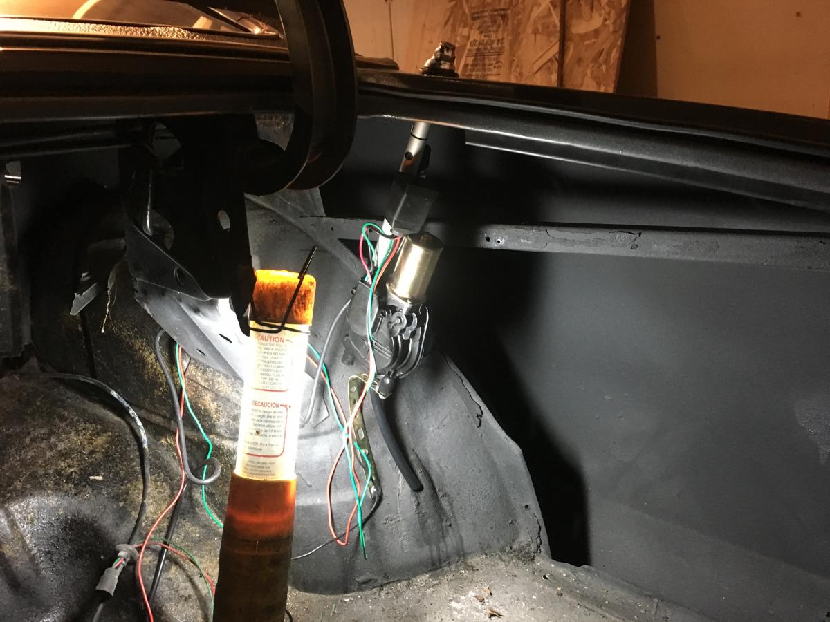

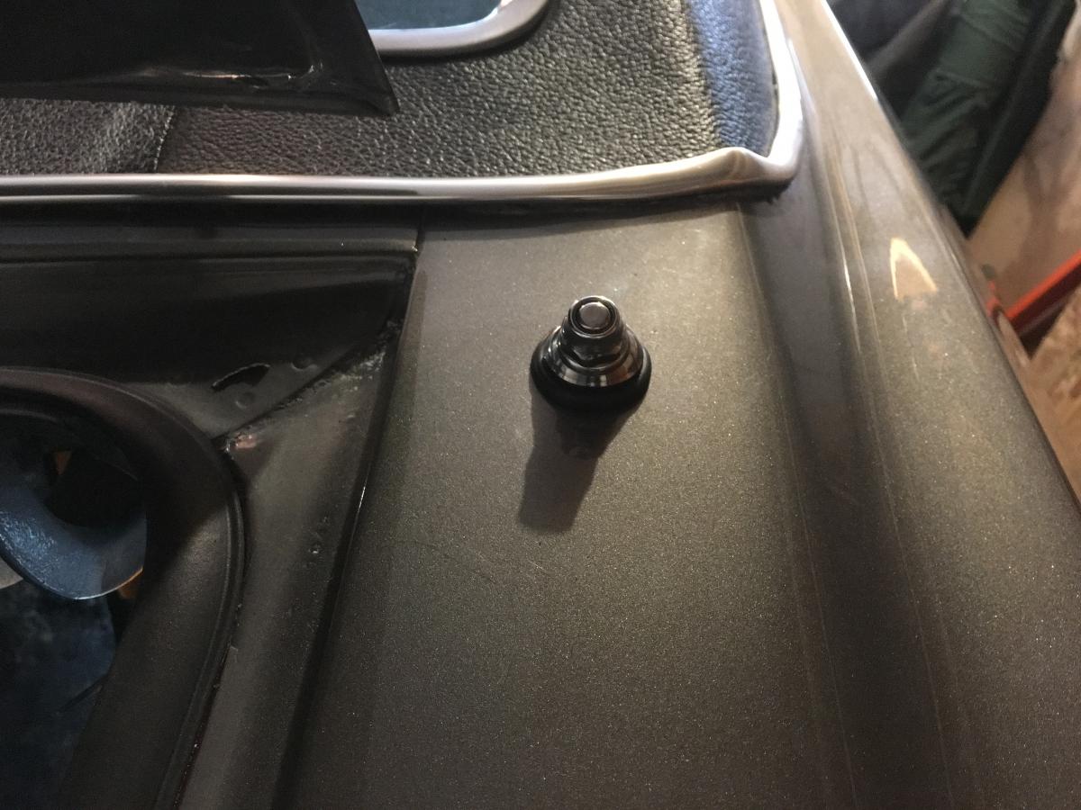

Rock Posted February 7, 2016 Posted February 7, 2016 As many know I had another birthday....I am now 29(lol) my son bought me an electric antenna for the Monte and I am now installing it...it will be nice not having it out when it doesn't need to be. Quote
