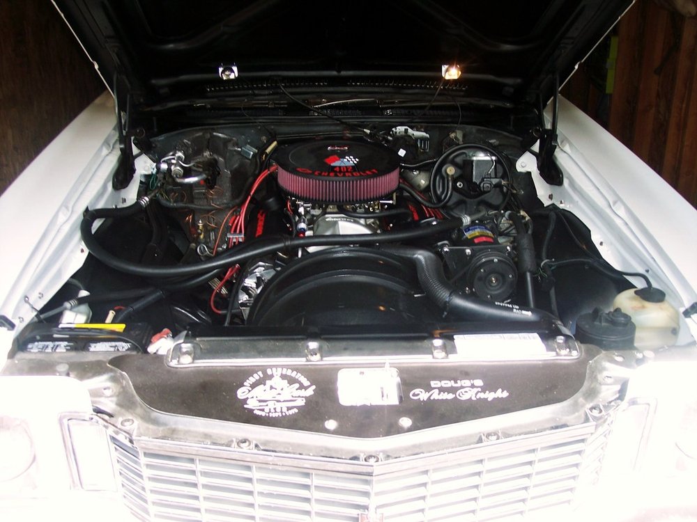

Decided to do some polishing and discovered that my drivers side door lock quit working.   Oh well, something else to tackle.  Looks better under the Hood than previous.

Tacklrd my lame driver door lock today and found another problem after starting the car this AM.  Had a rattle somewhere near the front of the motor.  Isolated it to the Balancer where after checking the 3 pulley bolts that hold pulley onto balancer, two had loosened up some, so got that fixed.  The door lock actuator plunger shaft was corroded so bad it just froze up.  Pulled the door panel, removed, cleaned and lubricated the shaft and moves up and down freely again.  There was a hole in the boot that let water seep onto boot and held it there until it seeped into hole thru boot.  Repaired boot and will be more diligent with water in this area even though I believe it shouldn't happen again.
Anyway, the rattle which originally thought to be inside motor as the rattle sounded internal turned out be tightening and that was a relief.
Until the next burp............................ Sorry, no pics of the work but here is a couple of the car while I was getting ready to work on her.
Doug

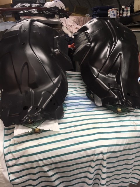

Here is a pic of the inner IMG_1039.JPG.b53e25080b1761eaaba028817f37fc6a.JPGwells, they are not done I think they need another coat or two, but it has been raining so cant get them outside yet.
