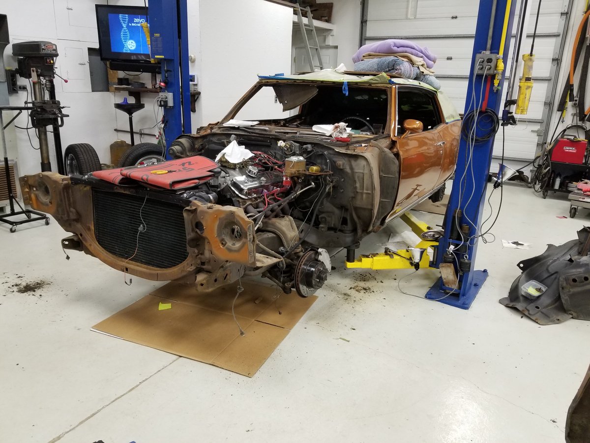

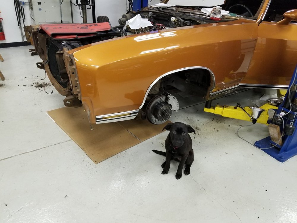

jft69z Posted May 12, 2019 Posted May 12, 2019 Finally starting to dig in on the disassembly to get the body off to clean and paint everything. Had some little helpers... 1 Quote
cny first gen 71 Posted May 12, 2019 Posted May 12, 2019 They seem to be sitting around a lot, I guess they are learning That looks like a pretty nice shop you have there, the lift will make things a lot easier. 1 Quote
jft69z Posted May 12, 2019 Posted May 12, 2019 They're not learning too much, their nicknames are 'dumb and dumber' 😁. In all fairness the little one is a 5 month old puppy. Just lost the 8 yrs old to cancer recently. Put a real damper on wanting to do anything out in the shop for the last month and a half. Quote

jft69z Posted May 12, 2019 Posted May 12, 2019 1 hour ago, Paul Bell said: Joe, nice shop! Is this in your home? Thanks! Yeah Paul, behind the house. 65x40, 12 foot ceilings in the main part, an office/parts area and added a spray booth area later. I did a lot of work out there until a year or so ago. Finally got tired of burning the candle at 3 ends. Started by peeling off the collision and restoration work a few years ago and then stopped the mechanical and diagnostic work too. Apparently I got bored, or nostalgic and ended up with the '72... At least it's my stuff now instead of everyone else's vehicles. 1 Quote

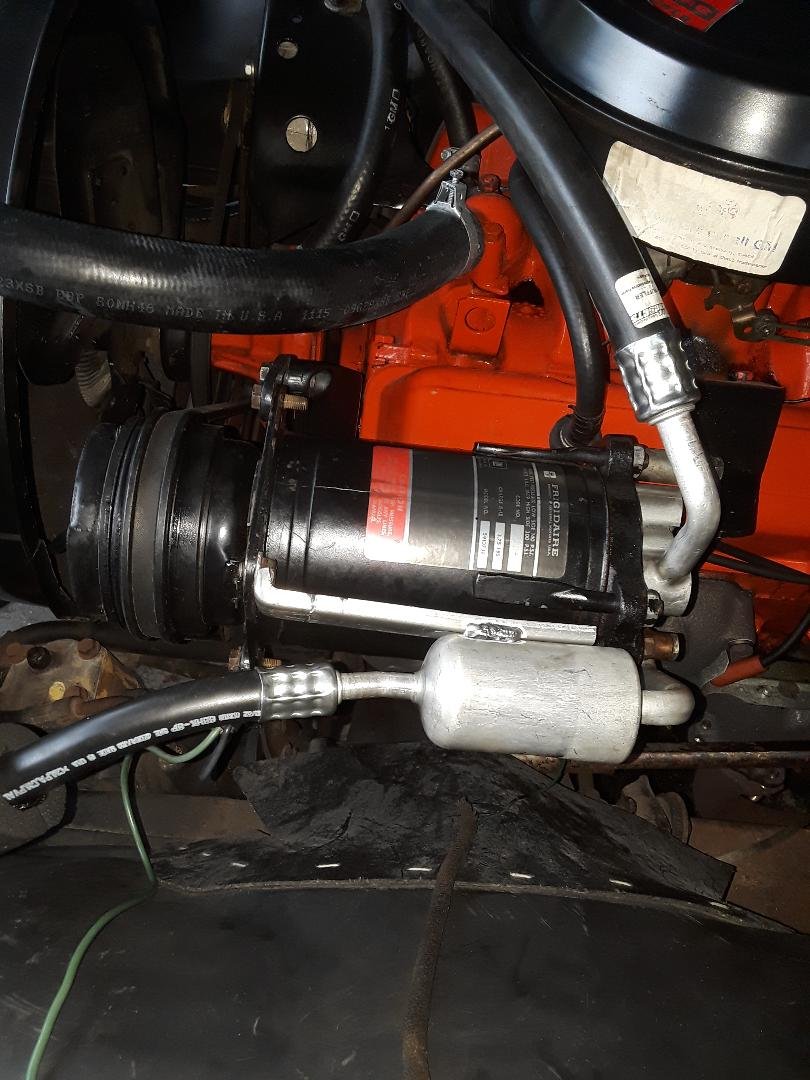

Rob Peters Posted May 14, 2019 Posted May 14, 2019 Finally got a chance to head up to the storage garage to try to finish up the Air Conditioning rebuild. Most of it was done with the exception of connecting all of the lines, expansion valve bulb, replacing the PAG-150 oil, compressor and reinstalling the grill. According to Original Air Products people who I purchased all of the lines, drier/receiver, POA, Expansion valve and who rebuilt my compressor I needed to install 10.5 ounces of oil. At first they told me to put 10.5 ounces into the compressor. A couple weeks ago my son and I tried several times to get the compressor to take the oil. LIVE AND LEARN.... We finally called them and one of the guys there got back to me and told me that the entire system holds 10.5 ounces. I was able to get about 4 ounces into the compressor, 2 ounces into the drier and the rest into the condenser coil. I was not able to finish the reassembly because with the conversion to the R134 the new POA valve has a switch that needs to be wired in series with the compressor. The new POA valve has a pressure switch which will cycle the compressor. The problem is that the wiring they give you to wire it in is way too short so I will need to go buy some wire to complete the reassembly and then I can get the system vacuum checked and recharged. rob Quote

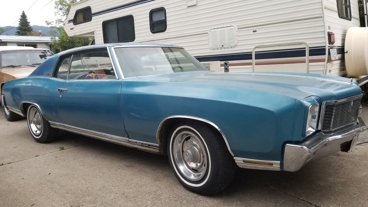

Hoodicoff1 Posted May 16, 2019 Posted May 16, 2019 Did some polishing to the faded blue paint, new plug wires and fixed all the burned out lights, this ole faded beast wants to be on the road. Everything I touch has been an easy fix. 2 Quote

Rob Peters Posted May 18, 2019 Posted May 18, 2019 As of tonight, my Air Conditioning is completely done with the exception of taking it to a friend to do a vacuum check and recharge the system. Tonight I rechecked all the line connections and wired the POA Valve pressure switch. Below are some pictures of the rebuilt compressor with the new lines attached, the new Drier/receiver, the new expansion valve and the new POA Valve and pressure switch. rob 2 Quote

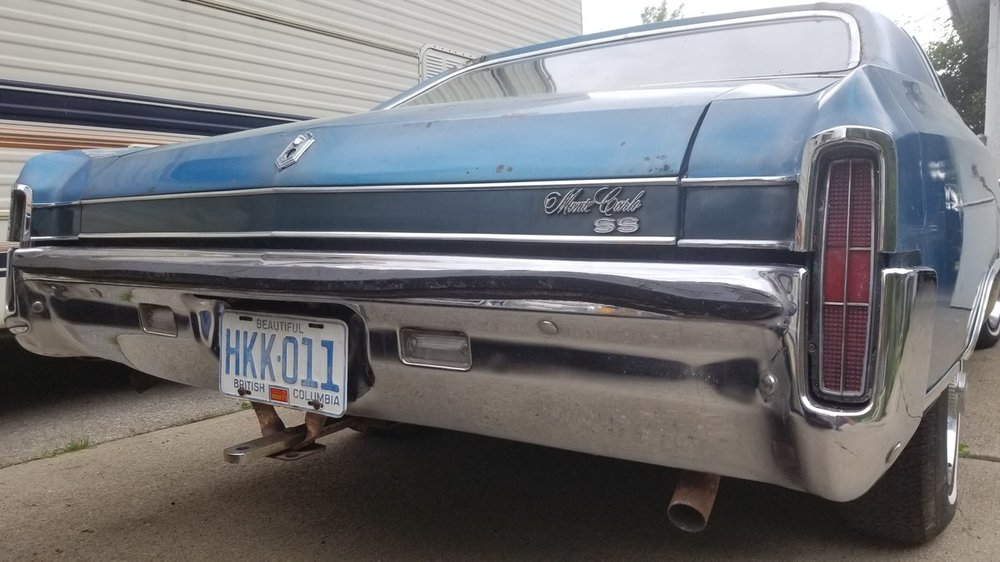

monte70car Posted May 20, 2019 Posted May 20, 2019 Well I pulled the cover off change the battery and sprayed a little starting fluid in the carb and got it running. 8897BB99-8A55-468C-818B-9356978F59FA.MOV 8897BB99-8A55-468C-818B-9356978F59FA.MOV 3D3320A9-85DF-49B0-AD4E-8FC8FAC84E46.MOV B61D2B79-B00D-4C62-BD59-5FFD59513D47.MOV Quote
Hoodicoff1 Posted May 21, 2019 Posted May 21, 2019 Got the ole 71 SS cleaned up as best as I could over this long weekend. Brakes are good, lights all work. Now just get the paperwork signed over so I can drive the crusty beast 1 Quote

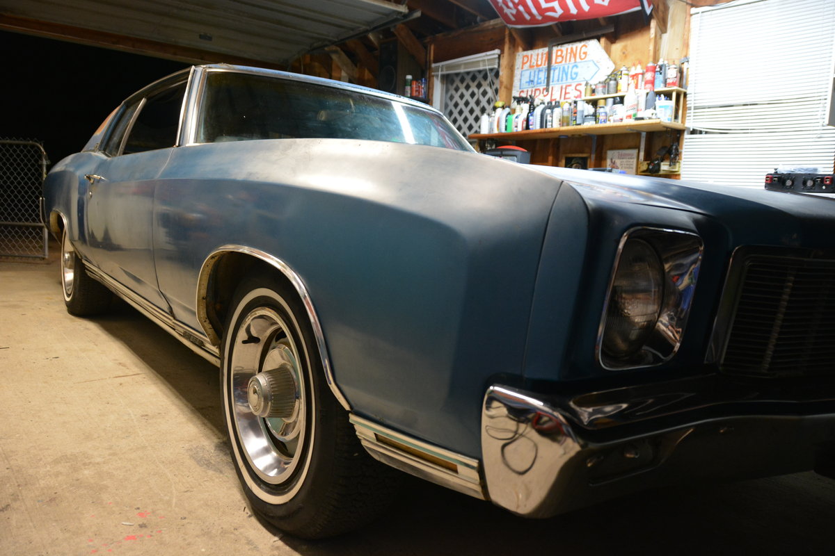

Paul Bell Posted May 24, 2019 Posted May 24, 2019 My body shop guy: "What do you mean you don't need a full paint job? Every panel has a ding!!" Quote
