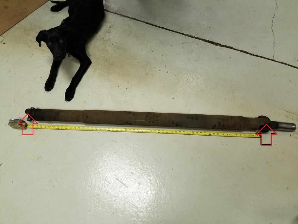

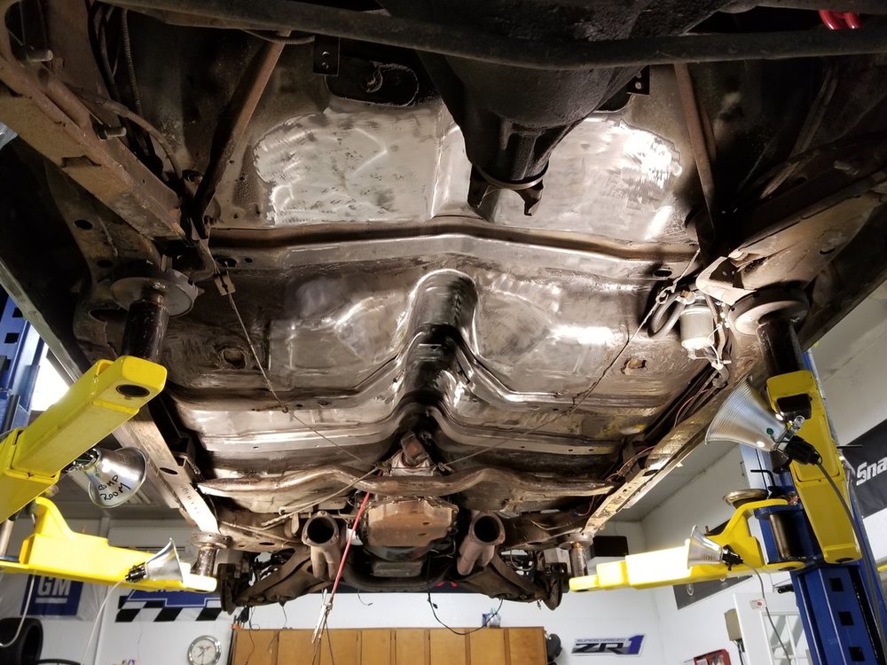

jft69z Posted June 13, 2019 Posted June 13, 2019 Been cleaning the undercoating and 47 years of dirt from the floor pans and frame....loads of fun. Plenty more to do. Hope to have the body off before I go back to work next week. On a side note, noticed the driveshaft seemed a bit too long when I removed it, Barely moved forward into the trans to clear the rear yoke (not good). Also seem to remember my old '72 Monte had a big steel ring around the front of the shaft, sort of like a damper that this one doesn't have (that was originally a 350/turbo 350). Anyone have a driveshaft kicking around to confirm what the yoke to yoke measurement may be? This one is 54 1/4" long, center to center at the red arrows. Probably putting a different trans in anyways & will need a new driveshaft, but just curious what length should have been in there. This is a '72 402/turbo 400/12 bolt car just in case it makes a difference. Thanks! Quote

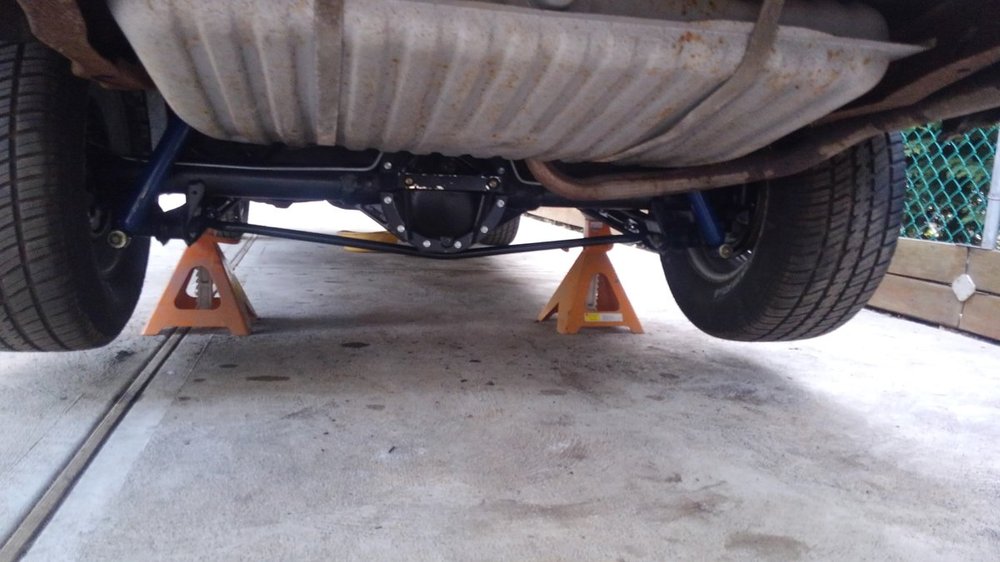

Paul Bell Posted June 13, 2019 Posted June 13, 2019 1 hour ago, MC1of80 said: Remember, you have the car on a lift, the rearend hangs low causing the distance between the trans and rearend yolk to become closer. I think you got the backwards Tom, as the rear drops, it arcs away from the transmission. Them diesel fumes at work, I'm sure.... Quote
MC1of80 Posted June 13, 2019 Posted June 13, 2019 Umm sorry Paul. On the lift, the rear moves towards the transmission, making the distance less/smaller. Coil spring rear. 4 link. Ever notice when you jack up the car in the rear how the tire is closer to the door in the rear fender well than it is on the ground? Quote

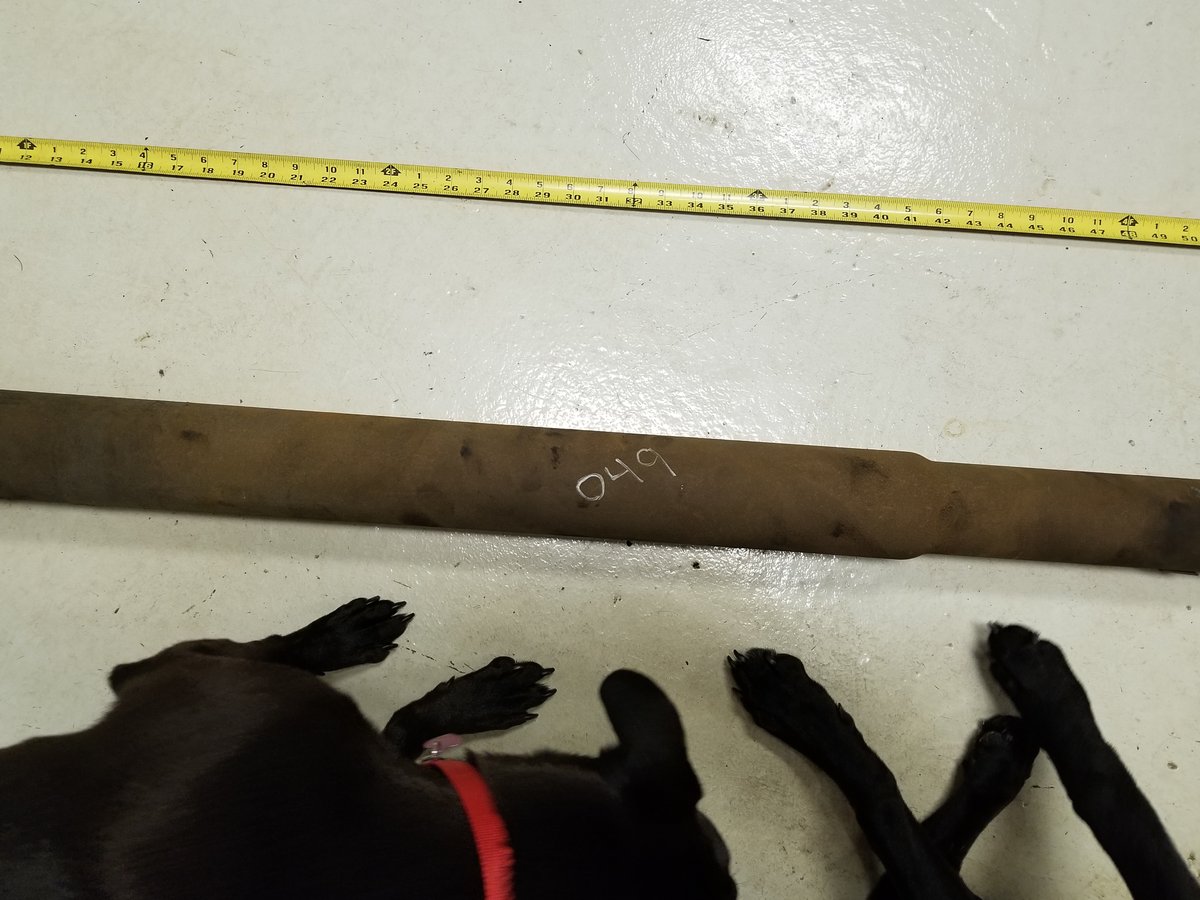

jft69z Posted June 13, 2019 Posted June 13, 2019 Thanks guys! I've pulled a lot of driveshafts off on the lift, but this one just seemed unusually tight. I had to pop both u-joint caps off the rear joint to finagle the driveshaft out. If the shaft moved 3/8" to 1/2" forward into the trans, that would be generous. Certainly wasn't enough to clear the rear yoke without removing the caps. One other clue was there was a paint mark on the shaft, like it came from a scrap yard or something. That had also led to my suspicions. No damage underneath though, floors untouched & perfect, numbers match on engine & trans, and the rear end ID & date codes seem good. (I've had them break before and they flailed around underneath, certainly left a mark or two ). Odd, but who knows what happened in it's prior life, if it was replaced, and why. That picture you have Willie is exactly what I remember the old Monte's shaft having as far as the ring. Entirely possible I replaced it when I put the 454/4 speed in the old car with the larger output shaft, and then put it back when I converted the car to stock before selling it. Too long ago to remember now. Certainly seems that you guys don't recall the 402 cars having the ring, so that's good info. Quote
MC1of80 Posted June 13, 2019 Posted June 13, 2019 Hi. Measured from canter of cap to center of cap on my 402 driveshaft. Got 55 1/4". Hope this helps. Quote

jft69z Posted June 13, 2019 Posted June 13, 2019 46 minutes ago, MC1of80 said: Hi. Measured from canter of cap to center of cap on my 402 driveshaft. Got 55 1/4". Hope this helps. Thanks Thomas. Mine measured out to 54 1/4"...1 inch shorter, but still tight (sometimes I forget to subtract the inch if I use a metal tape measure and start at 1" though). No way mine could add an inch and still work. It looks like someone added poly motor & trans mounts , but doesn't appear to be set back at all. Did notice that the trans crossmember is bolted solid to the frame with one center bolt. Didn't they have some rubber sleeve, then a metal cap to bolt in 2 places at the frame? I see witness marks that look like it was bolted on both sides of crossmember (red arrows). Might be the poly trans mount is tall, so they eliminated the rubber mount, or they wanted it solid, so eliminated it. Another mystery. Thanks again! Quote
MC1of80 Posted June 13, 2019 Posted June 13, 2019 I bet if you look deeper, that crossmember is supposed to have the rubber isolators and someone removed them, drilled a hole in the center and bolted the crossmember in. The crossmember on my 402 4speed is like a Chevelle and mounts solid to the frame. I will look Saturday if my 402 auto does or does not have the isolators. I will also double-check my driveshaft measurement. 1 Quote

jft69z Posted June 13, 2019 Posted June 13, 2019 1 hour ago, MC1of80 said: I bet if you look deeper, that crossmember is supposed to have the rubber isolators and someone removed them, drilled a hole in the center and bolted the crossmember in. The crossmember on my 402 4speed is like a Chevelle and mounts solid to the frame. I will look Saturday if my 402 auto does or does not have the isolators. I will also double-check my driveshaft measurement. It looks exactly like it was rubber mounted in the past. Found the brackets and rubber inserts available online and certain it used to be that way. Even the ends of the crossmember look like it was in the rubber sleeve in its past. No biggie, easy to correct. I'm kicking the idea around of installing a 4L85 trans, and it would require a different mount anyways. I hear it's a tight fit, but doable. Open to suggestions though...pro or con. Rear gears now are 2.73, but have a complete 12 bolt with 4.11 gearset. If I put a 4 speed auto in, the 4.10 would probably work out nice. If I re-use the T-400, then I'll want more gear out back like something between 3.42, 3.55, 3.73 maybe. Decisions..... Thanks for taking the time to check! Quote
