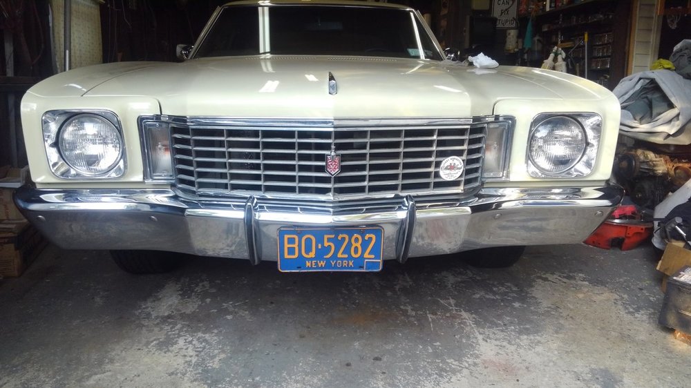

714024SPEED Posted July 30, 2019 Posted July 30, 2019 Finally got my shifted bumper problem solved,new brakes and added bumper guards 2 Quote
714024SPEED Posted July 30, 2019 Posted July 30, 2019 Sorry Damm auto correct new bumper brackets lol Quote
Rob Peters Posted July 31, 2019 Posted July 31, 2019 Yeah, I hate auto-correct. Congrats on the improvements. I like the bumper guards. rob 1 Quote
