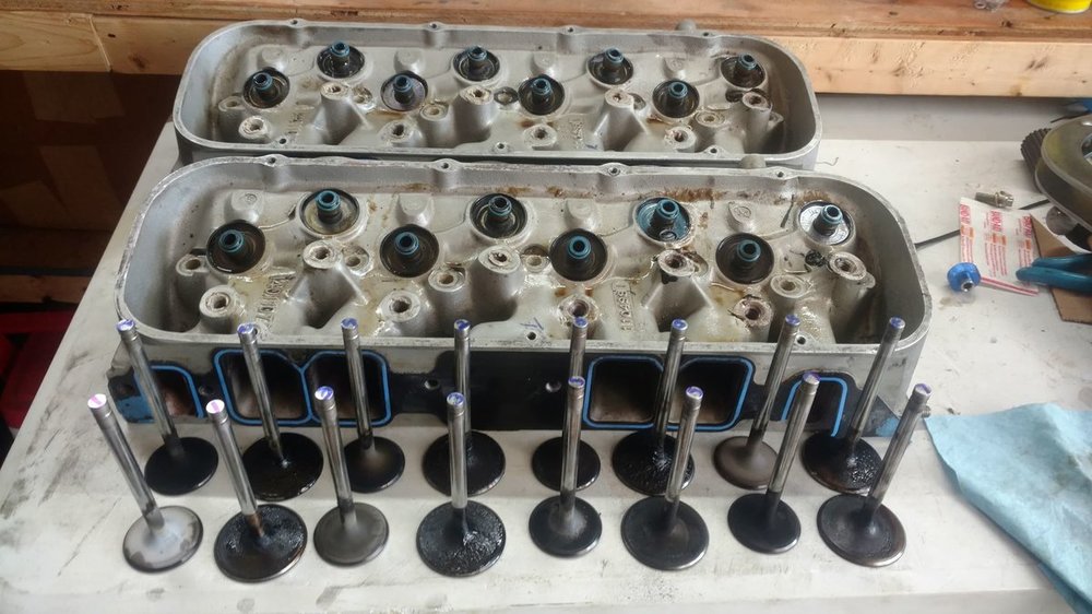

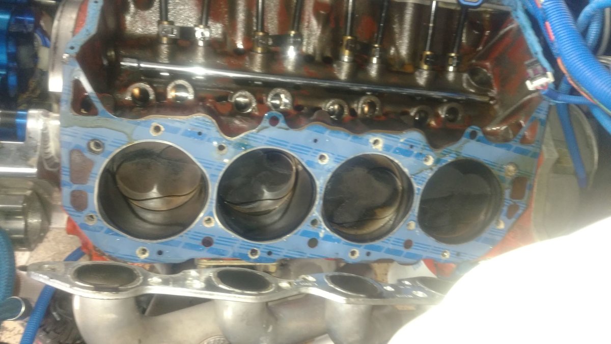

MC1of80 Posted August 11, 2019 Posted August 11, 2019 Wow Paul! You were busy. Why that much teardown? Find something else? Quote
Paul Bell Posted August 11, 2019 Posted August 11, 2019 My current valve springs have 600 lbs open valve pressure. I installed them in the car. Super difficult, I needed a five foot bar to compress them to get the locks in. I had a bunch of rope in the cylinders to hold the valves closed. Crower says the new lifters need like 700+ lbs. No way was I gonna change springs in the car again. Although pulling the heads are a lot of work, it's easier than an in-car spring swap. And I can do a few other things, like cleaning out the evap box, I want AC next year. Quote

Paul Bell Posted August 11, 2019 Posted August 11, 2019 James, my lift is .630/.630. Bullet says they can grind my cam with slightly more lift in a hydraulic version but it's $500.00, no-needle hydraulic roller lifters are actually $100.00 more and I'd have to strip down the front of the motor-no small task with a serpentine front drive. I have a magnet on a flexible wire so it'll grab whatever isn't in the filter. Any bigger chunks wouldn't pass the oil pump's pickup so they'll be in the pan. Quote

Paul Bell Posted August 17, 2019 Posted August 17, 2019 So this is where I’m at. I have a mechanical cam and the needed mechanical lifters, they’re 25 year old Crower roller lifters. The cam is a custom grind from Bullet with the LS firing order. The lifters are from before anybody knew to give them a wheel oiling hole, they rely on “splash lube”, which doesn’t happen a lot at idle or sitting in traffic. One broke, somehow the cam isn’t damaged. I never lost oil pressure which means none of the needle bearings got into the pump, they’re in the pan. I’ll get them out. Bushing style bearing lifters (no needle bearings) are the most reliable today but the most expensive, a set is over $1,000.00. Worth it to me. Lifters need to have specific spring pressures. The lifters from Crower or Isky need over 700 pounds at full open valve. These springs are about $500.00. All these springs have different inner diameters so Titanium retainers are about $300.00. There’s no way I can install these springs in the car so off come the heads-add in $170.00 for Cometic head gaskets. I’m swapping out the ARP head bolts for ARP studs, another $190.00. My headers are kinda beat up and they hang very low. I want those American Racing Headers, made specifically for and only fit big block Monte Carlos (it’s not a poor fitting Chevelle header). They are a whopping $1,465.00. ARH is near me and I know them so I’ll ask to go watch them make them, this is a made to order header. This hits about $3,500.00. A mechanical cam is noisy and as it has a lash gap, when the cam lobe hits the lifter, it impacts it. Bullet says they can make the cam slightly bigger in a hydraulic and I’ll have the same power. It’ll be smoother and quieter. If I do this, add $500 for the custom cam and $380.00 for shorter pushrods (hydraulic roller lifters are taller) but the springs are less pressure and less expensive. Going this route puts everything at about $4,300.00. Either way I choose, my car won’t be running until springtime. Quote
