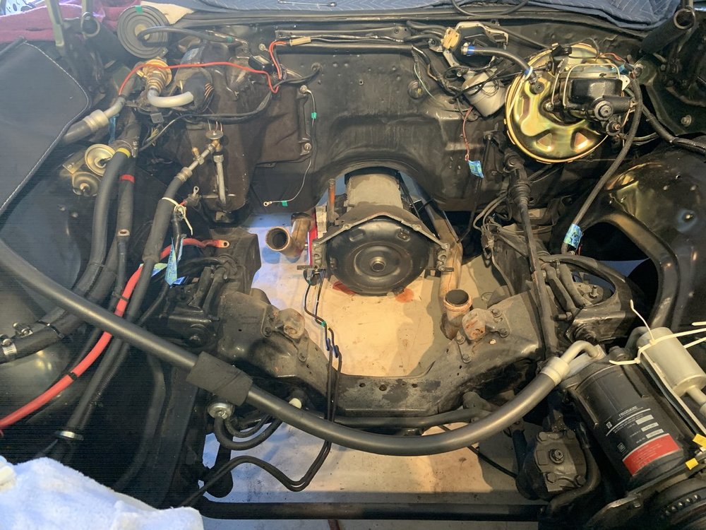

DragCat Posted January 28, 2020 Posted January 28, 2020 Finally got the old 454 out , put in the cradle and almost ready to bag for storage. No I didn't pull it with the spark plugs in it lol. Only thing left is to pop the plugs and drain the remaining water from the block. Trans should come out this week. Never a dull moment 1 Quote

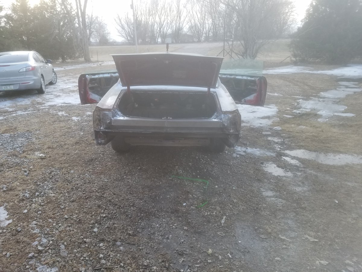

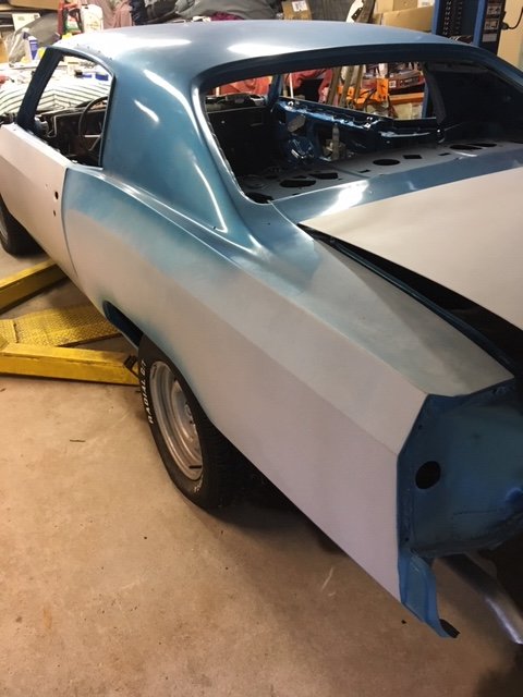

72RustBucket Posted February 3, 2020 Posted February 3, 2020 Waiting on parts to do more work to my tail panel, so started on the floor and trunk pans. Really only 2 spots that need patches. Made 1, the other might need to be purchased. There are some spots with some pitting, but the metal is very sturdy, so think I will be ok just treating those areas with ospho. Quote

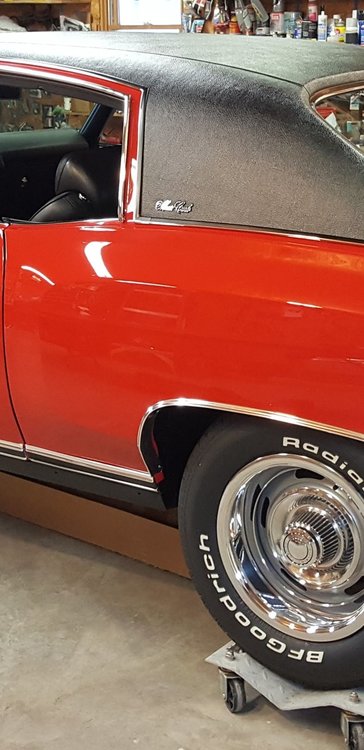

RON T Posted February 5, 2020 Posted February 5, 2020 Found an original nk4 steering wheel from a club member to put on the 71..horn button cap is nos ... build sheet called for this sport wheel,, why some one took it off and put a camaro SS wheel on it I have no idea... anyway, it’s back to what it should be.... Also replace dinged seal plates.... approximately 136 days till eastern meet... 😎👍🏻 2 Quote

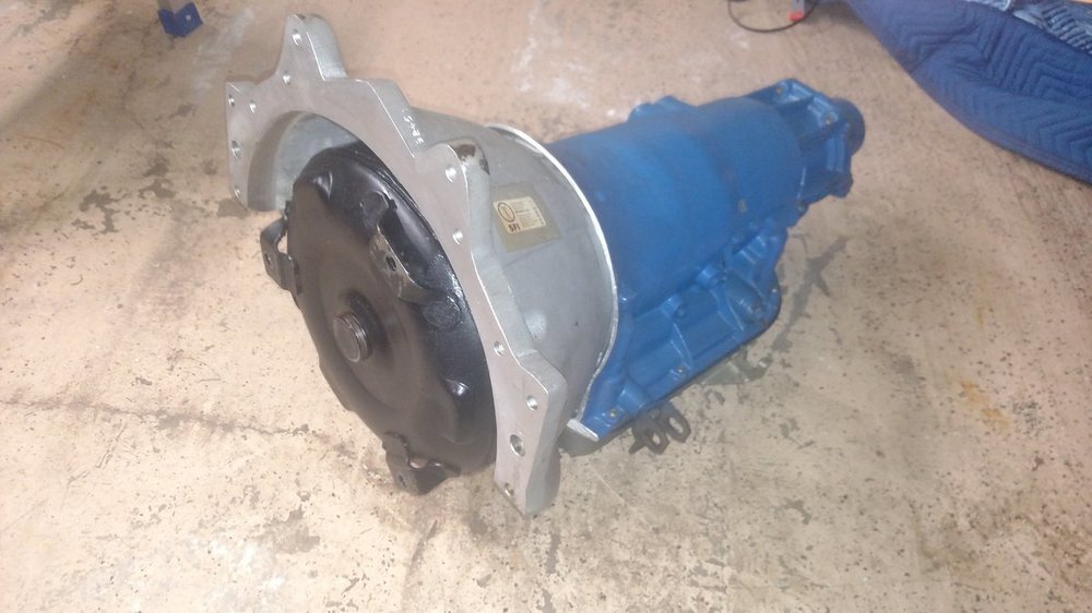

DragCat Posted February 8, 2020 Posted February 8, 2020 Pulled the trans yesterday, The bad news is there is a 5 inch crack in the bell housing where it mounts to the engine, the good news I guess I found it now not later. Was going to check with my builder to see if he could do something like this https://www.summitracing.com/parts/jpt-92451/overview/make/chevrolet but its a race weekend so he's at the track. Might be posting questions in the drivetrain thread lol. Did read I might want to upgrade my crossmember to a chevelle type due to the additional HP. Will see what happens Quote
Paul Bell Posted February 9, 2020 Posted February 9, 2020 Mark, I installed that bellhousing many years ago, I cut the transmission myself-almost perfectly straight. The current version of it has some sort of O-ring around the pump bolts to seal them. Be aware you'll need a smaller than stock torque converter and there's no way to mount a torque converter cover. 2 Quote
DragCat Posted February 9, 2020 Posted February 9, 2020 Thanks for the heads up Paul 👍 Cutting it myself is out of my skill set, i'll see what the trans guy says. And of course I already bought a new converter when I ordered the crate, but the new one is a 10 inch and I think the stock is 11?. Never a dull moment Quote
imr Posted February 9, 2020 Posted February 9, 2020 1 hour ago, DragCat said: Thanks for the heads up Paul 👍 Cutting it myself is out of my skill set, i'll see what the trans guy says. And of course I already bought a new converter when I ordered the crate. Never a dull moment Mark how bad is the crack. could it be welded. Might be cheaper than cutting and adding a bellhousing. unless you need the safety of a scattershield. Quote
DragCat Posted February 9, 2020 Posted February 9, 2020 1 hour ago, imr said: Mark how bad is the crack. could it be welded. Might be cheaper than cutting and adding a bellhousing. unless you need the safety of a scattershield. Hey Antoine, its about 5 inches. I thought about the possibility of welding but with the new crate and the added HP i'm in a safety mindset. Especially since i'd rather get it done now and not have to revisit pulling the trans again later. Quote
jft69z Posted February 9, 2020 Posted February 9, 2020 I wonder if someone broke it years ago trying to draw the trans up to the block, but the TQ converter wasn't seated correctly. It happened to a customer of mine years ago. He was trying to save a few bucks on the car I was restoring for him. Decided to mate the engine/trans himself while I wasn't there. He ended up paying me to weld up the trans case instead. Man, did he have a long face... Read a review that someone had on Amazon for that bellhousing. Said he needed a 153 tooth flex plate & corresponding starter. Is that what you found as well Paul? 1 Quote

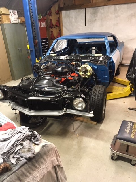

willie Posted February 11, 2020 Posted February 11, 2020 Where do you think she is going? Hopefully going for Paint tomorrow depending on the weather. I do have a question, where do i find the pics of how to paint the black under the moldings and in the door frames, and also what color is it? Semi gloss? thanks guys 1 Quote
1970mcss Posted February 11, 2020 Posted February 11, 2020 21 minutes ago, willie said: Where do you think she is going? Hopefully going for Paint tomorrow depending on the weather. I do have a question, where do i find the pics of how to paint the black under the moldings and in the door frames, and also what color is it? Semi gloss? thanks guys Willie, looking good. Didn't Overdrive (Dan) have that information when he repainted his SS??? Quote

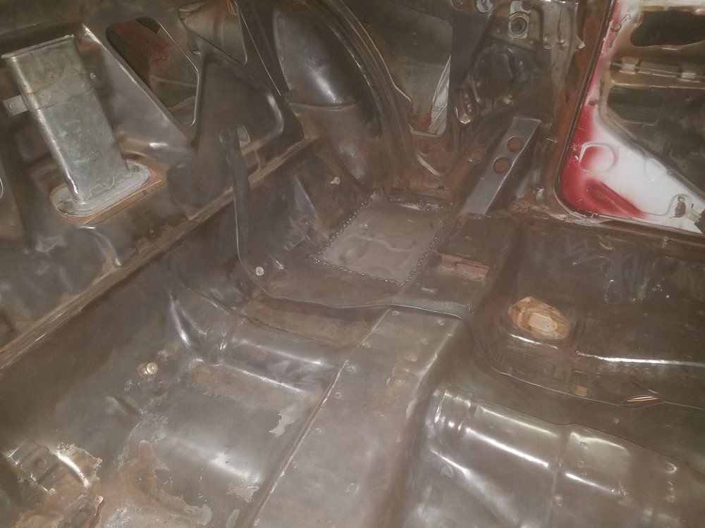

72RustBucket Posted February 18, 2020 Posted February 18, 2020 Did some shop cleaning today. Gave the monte a good air bath to blow out some dust and rust. Also, shrinker/stretcher and bead roller came in today. Played around with the beads and steps, made a floor patch. Got all my major floor patches welded in. I won't lie, they are (in my opinion) ugly as sin, but very strong. Had a few welder issues during the process, but it should be fine. Quote
