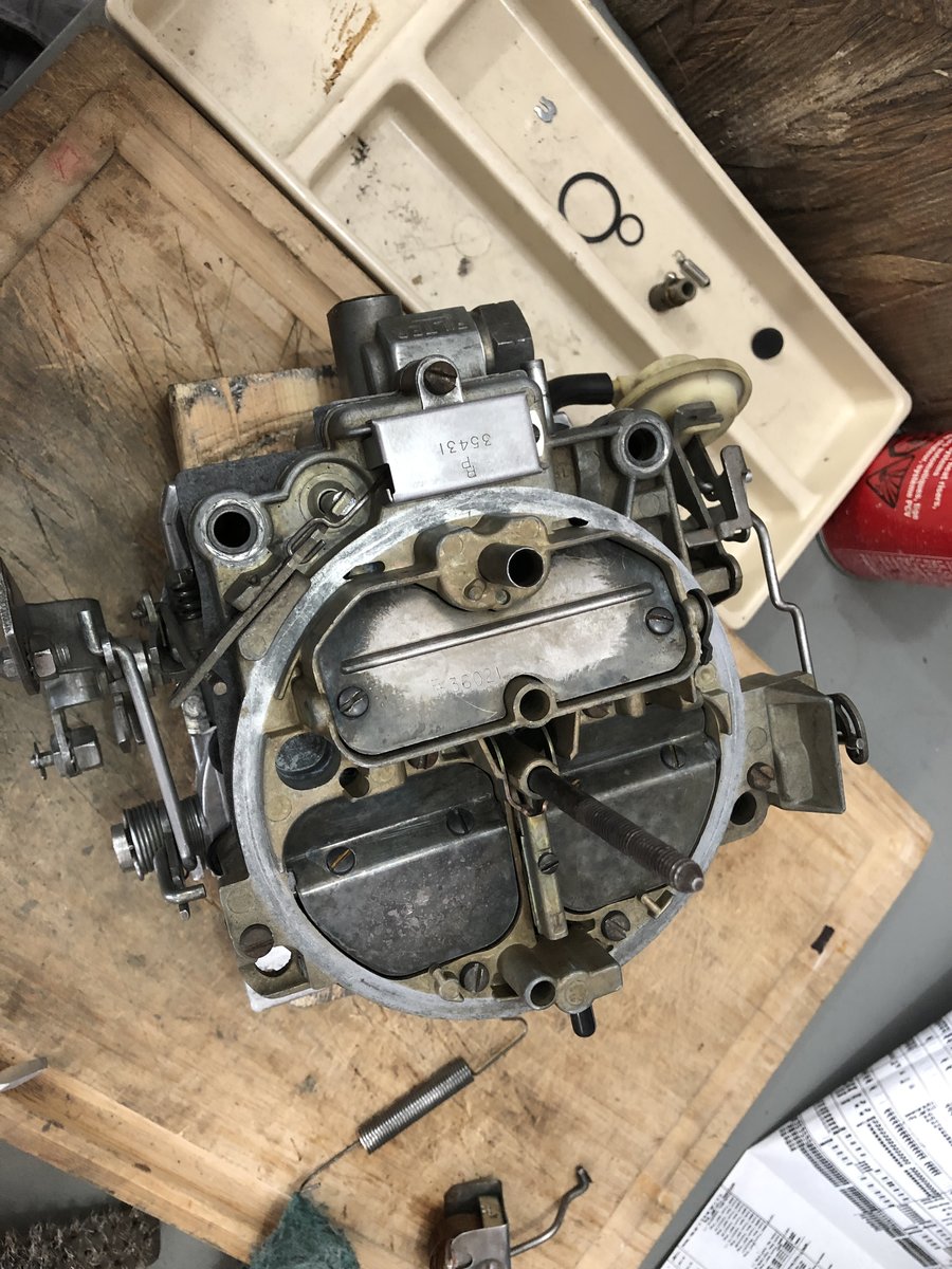

Rebuilt the carb for the 70 Monte today.
  • Like 5

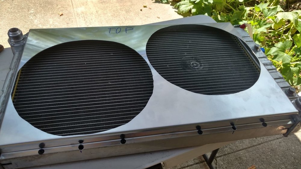

I made some progress on my Super Sucker cooling system today. These are 14" Perma-Cool fans that flow 2,950 CFM each. The rings I mounted around them makes them more efficient and quieter. I special ordered an Ebay shroud without fan holes. I still have to fab up some blocks to mount the fan brackets to the shroud.
I'm setting up a relay that bypasses the EFI triggers to kick the fans to high speed when the AC compressor kicks in.
Hey Paul, looking good. I did much the same thing for mine see attached. I used 14” fans too and a shroud.
