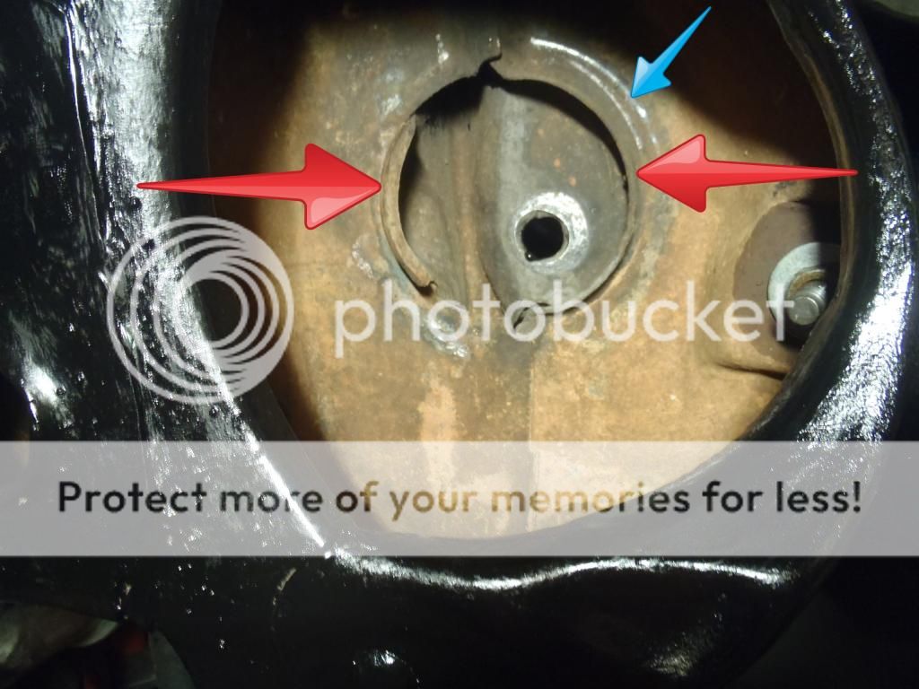

MCfan Posted August 20, 2014 Posted August 20, 2014 Question ?? Is the Coil spring pocket tab supposed to be to the outside or to the inside of the coil spring? If the spring pocket tabs look similar to the photo below, they go on the inside of the spring. The red arrows show the tabs on both sides of the spring and the blue arrow clearly shows the wear track of the spring on the outside of them. The small hole in the center is the upper shock mount. The second photo shows the top of the spring correctly positioned over the locating tabs (blue arrow). I have rebuilt the front end of both of my '70s and getting the front coil installed correctly was the scariest, trickiest and most time consuming part of the entire job both times - I guess I'm a slow learner. Quote
snomobeelr Posted August 20, 2014 Author Posted August 20, 2014 Thanks guys. I had them installed wrong. The old springs were binding on the tabs. I did not realize those tabs were there when I installed them. I angled the springs in so I could have the bottom part of the spring lined up between the holes on the lower control arm. The old springs are level in top but there is no flat spot on them like the other springs had. Think Ill get the new ones cut them and install them correctly. Quote
