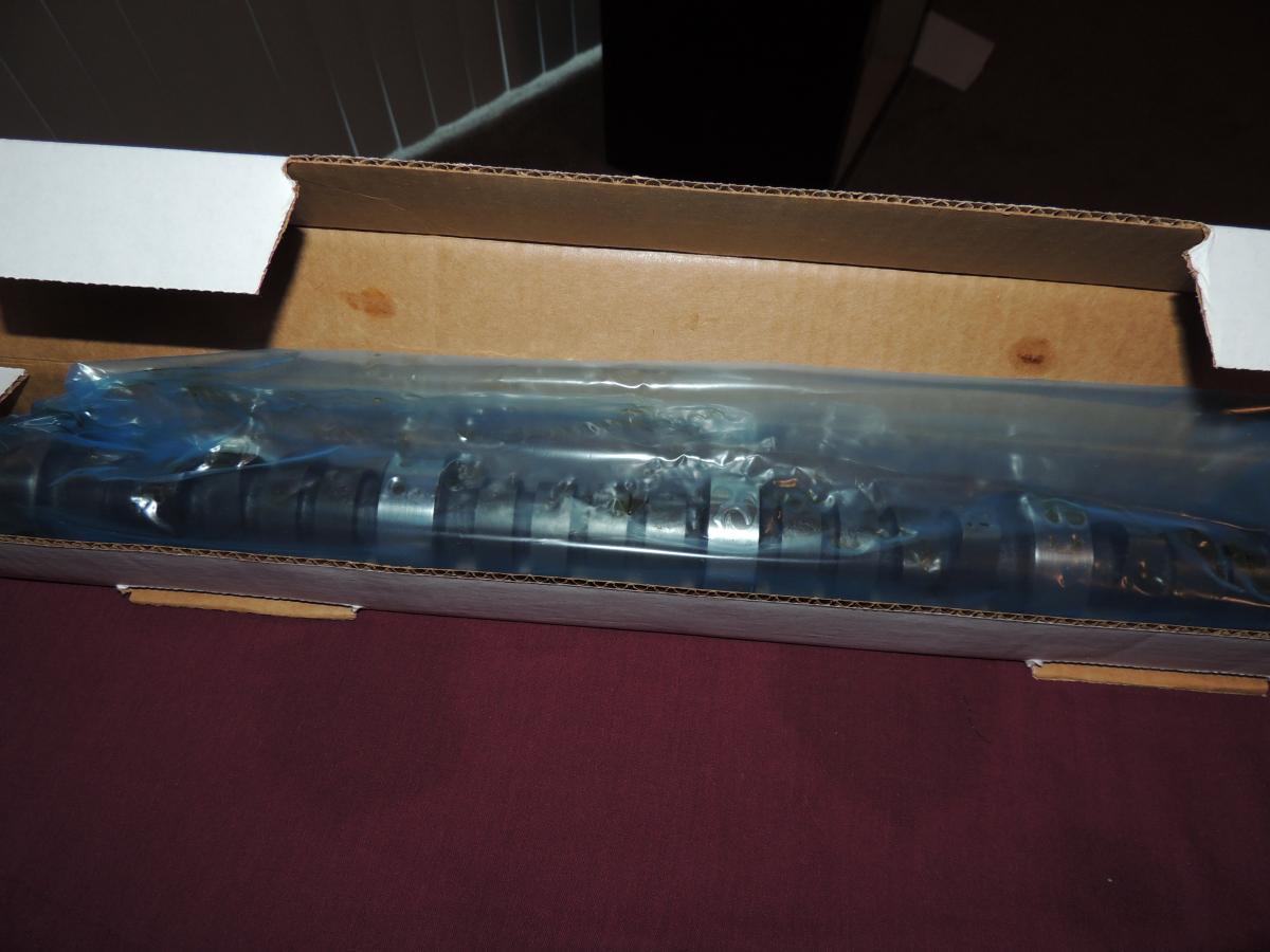

GriffsMonte Posted February 13, 2015 Author Posted February 13, 2015 I had the shop guys do a leak-down and all is good with my valves and they confirmed the bad cam, so i ended up going with the edelbrock performer plus hydraulic flat tappet cam, hopefully the shop can have it in and running by hump day next week. Quote
