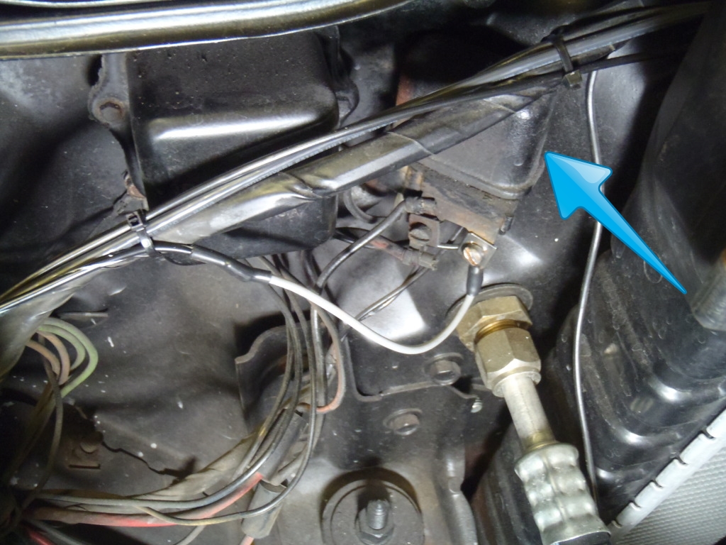

Right on! Turn out my horn relay was bad. The relay was not strong enough. Just need to mount the relay. I know it should be somewhere on driver side behind headlight. Just not sure exactly where. Is it mounted to the fender well?
Leroy, the attached photo shows the location of the horn relay (blue arrow) on the backside of the core support.  It is just left of the radiator and tucked up under the top edge of the support.
