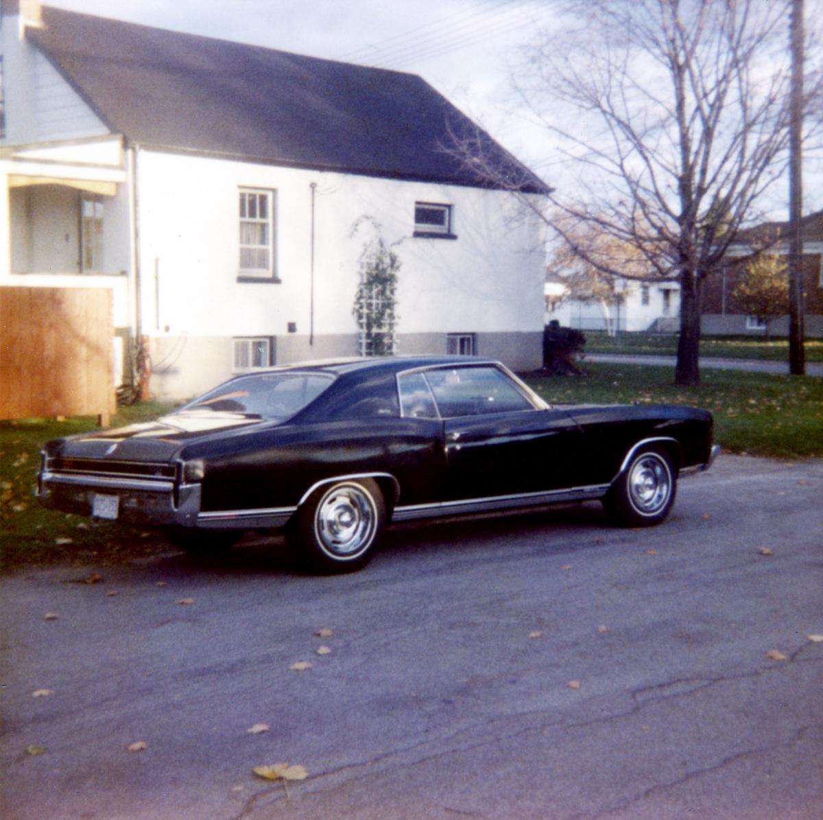

LostnFound Posted April 16, 2015 Posted April 16, 2015 Hi Carl, here's the photo of my car in about 1974 before it's first repaint. I'd say it looks glossy black due to it being an all black car. Quote
