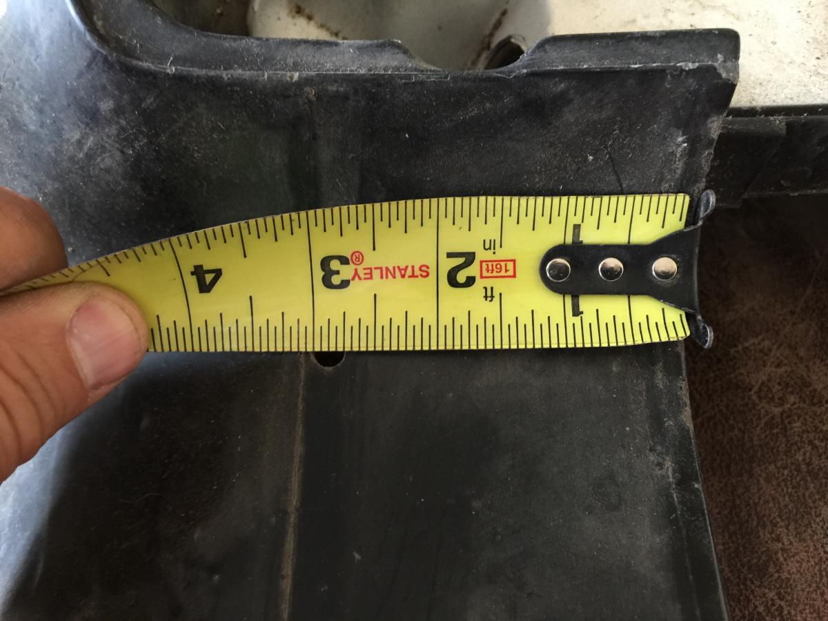

I think this is what you need. First three are the left and second three are right side.
Here is some shots of an nos set. The demand isn't there or I would have already 3d scanned them and reproduced them. The part #s are 9861027 & 9861026.
Can you redo this for me. In the 4th picture on the bottom molding in the picture hold your tape measure on the end of the molding and show me both measurements to the studs. Also tell me the part number on that lower molding so I can determine which is the left or right. Hold the tape so I can see the bace of the stud and not the end of the stud.

Here is another shot for measurements. It's from the bottom so you can determine the side.
Do you think there was a mistake in the casting. I can't figure any other reason why the studs are offset. one is at 1"3/8 and the other is 1"11/16. That is a 5/16" difference. I think someone messed up.
One is left and one is right. Can't mix them up that way.
