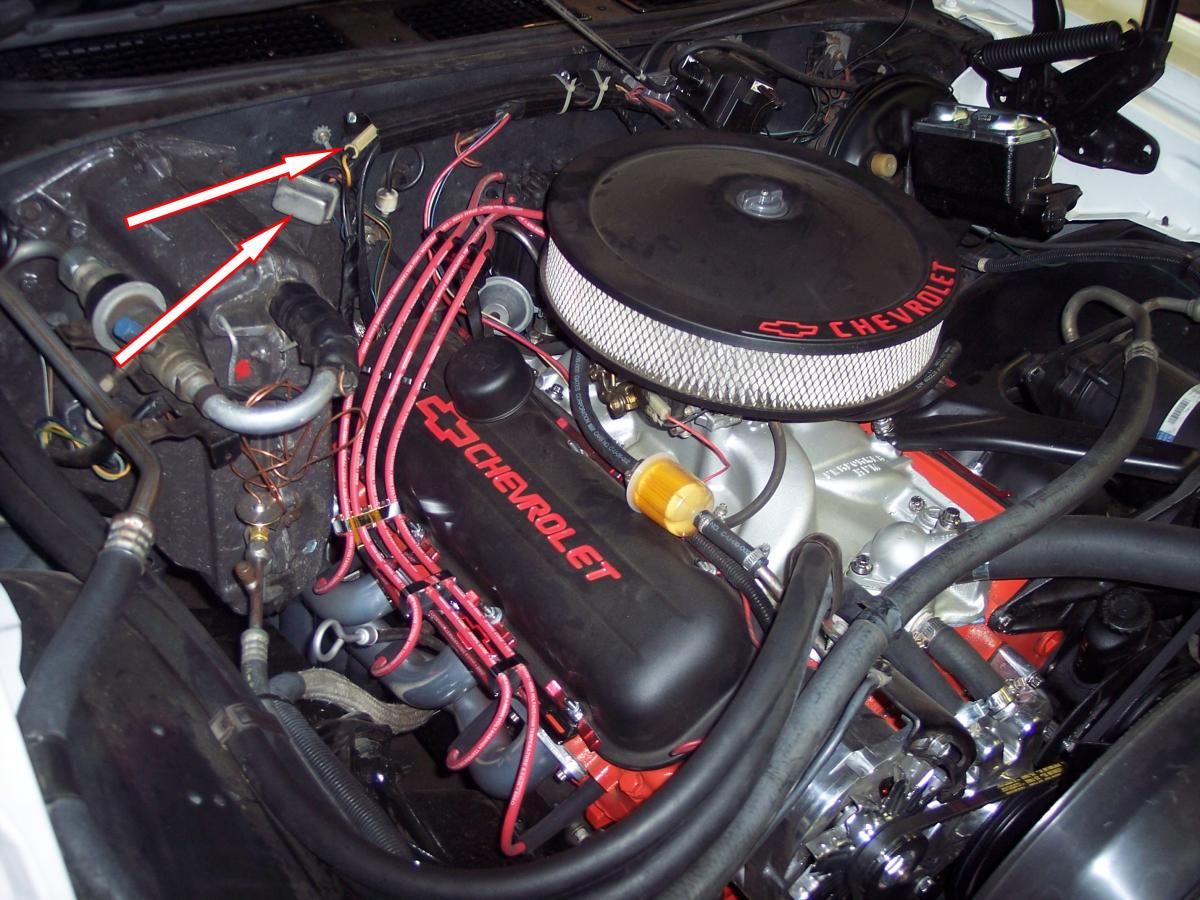

72-CLASSIC_RIDE Posted April 26, 2015 Posted April 26, 2015 I believe this pic shows both the relay and fuse for A/C. This pic is from a 72 model and may not be same exact location as a 70 / 71. Note that relay is mounted on the firewall and fuse runs into the harness mounted on firewall. I am not positive on this but is what I believe to be true. Doug Quote
72-CLASSIC_RIDE Posted April 26, 2015 Posted April 26, 2015 Here is a better visual for you. Doug Quote
GriffsMonte Posted April 26, 2015 Author Posted April 26, 2015 doug, the pics are accurate. and i remember my pops messing with those to get the fan to even come on. but i dont see how i can get the fan to go faster with a fuse and a relay ? does anyone know what ind of fuse should be in there ? or if i might have the relay wired wrong ? i will work on it today since its going to be sunny after work Quote

72-CLASSIC_RIDE Posted April 26, 2015 Posted April 26, 2015 Not well versed on the A/C or with electrical diagrams either. That is the high speed fan relay on firewall. The diagram(s) I have available do not identify the amperage of the inline fuse, just shows its there.. As I understand it, the higher / highest speed selector reduces or stops working both with A/C and Heat, but at lower fan speeds works as expected for both? If true, I would suspect the high speed relay. That being said, there are a couple other relays under dash related to heater control operation and have no clue what exactly their function is or how they/it might interface with high speed relay. I cant keep my A/C charged and high speed in particular is very weak. Been like this since owning car. Being in Oregon, I haven't done much about it as the windows down work as my A/C. I plan on having it repaired someday but realize it will have to be a certified A/C technician to make the repairs. So my issue is both air velocity of heat/cold air. Depending on your knowledge, you may be able to measure amperage from the high speed relay with controls set at different speed settings and using OHM meter, check what relay puts out at different settings. I wouldn't think the inline fuse has any implication as it would be expected to work each time or not work at all. Intermittent operation of fan speeds pretty much rules the fuse out. Anyway, those are my thoughts on it. If high speed relay performs as expected through all fan settings, then the issue moves to another location of the climate control system and this is where I am lost! Someone else might have had a similar issue and knows the answer. Lets hope they find your Post and can respond to it. Best of luck researching this problem. If anything comes up that might be useful, I will sure let you know. Doug Quote
