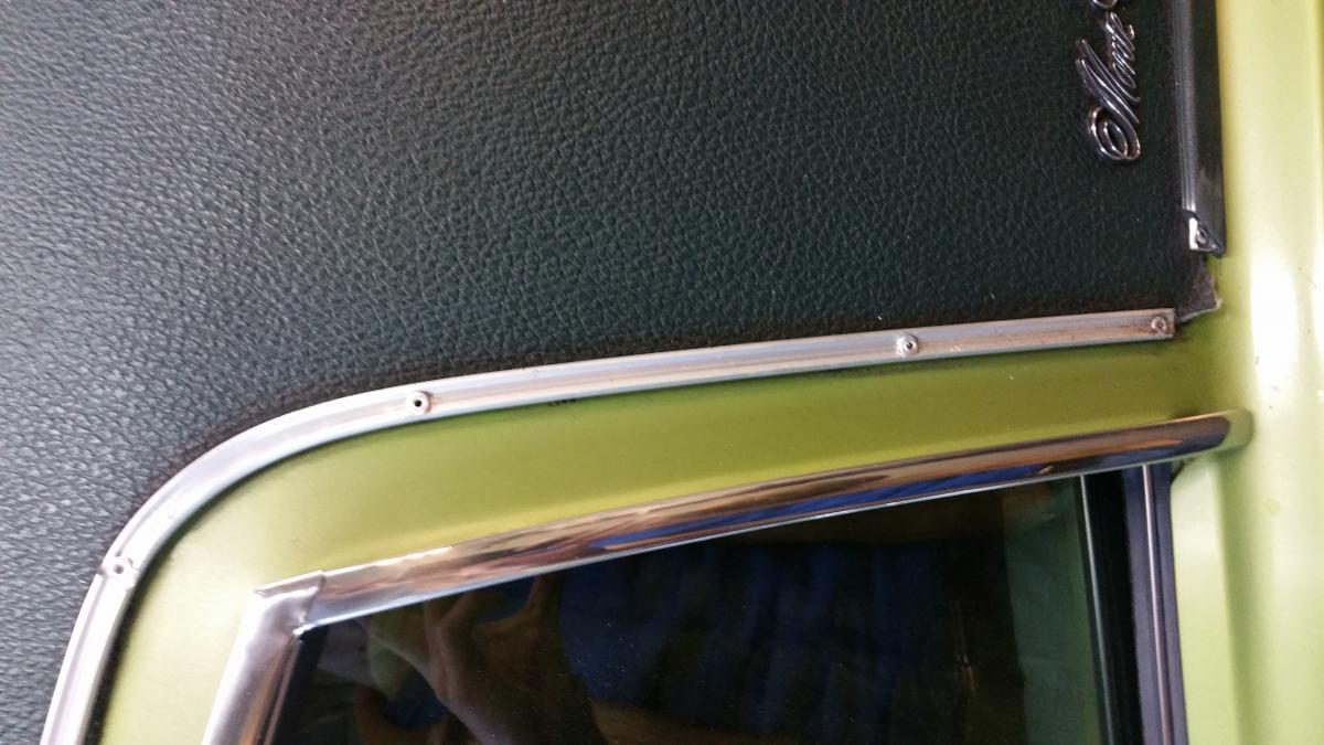

GermanMonte Posted December 25, 2015 Author Posted December 25, 2015 Merry Christmas to y'all! I finally found the time to get back to the vinyl top trim again and Jared is going to supply me with the required parts. It looks like the roof of my Monte has been modified to take the current plastic trim. I took a picture where you can see the aluminum rail that's below the plastic trim: This is not original, is it? What would a stock "setup" look like? Robert
Jared Richey Posted December 25, 2015 Posted December 25, 2015 That's different for sure. Some type of. Aftermarket something
monte70car Posted December 26, 2015 Posted December 26, 2015 That is the same trim a friend of mine's 71 had on it with a padded vinyl top The only thing that made no sense to me was there was no signs of the factory studs for the original trim on the roof, but could tell it had the corner trim on it at one time as the holes were about the size of a dime.
GermanMonte Posted December 26, 2015 Author Posted December 26, 2015 Hmm, ok. Mine came with a dark green vinyl top from the factory, given that I understand the built sheet correctly. Maybe someone replaced the original vinyl top on it one day, who knows. I can't find traces of the factory studs and there are no holes for the corner pieces as well though. I'm wondering if it's possible to put the factory trim that Jared has for me on the car without having to drill the [censored] out of the roof. The body of my car is super solid and unmolested, with the factory paint still on it.

GermanMonte Posted December 27, 2015 Author Posted December 27, 2015 Thank you! I think I can make the stock parts fit well enough. There are no factory studs anymore though. Maybe I can use the existing holes in the roof where the rivets are now and bolt down the factory clips with some stainless screws.
Leghome Posted December 28, 2015 Posted December 28, 2015 There are screws made to hole the molding clips by AuVeCo. Some one else may have the part number as I cannot remember it.
GermanMonte Posted March 14, 2016 Author Posted March 14, 2016 From Dixie to Germany! Thank you, Jared. The roof looks so much better now with shiny metal trim instead of crappy plastic stuff!
