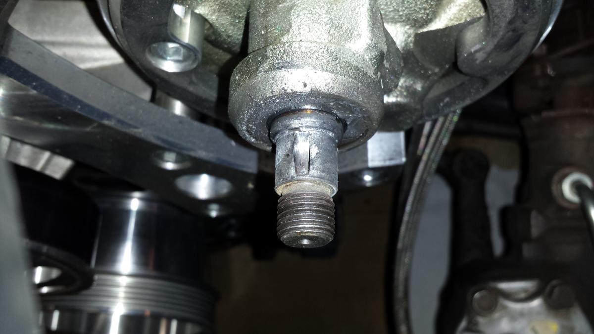

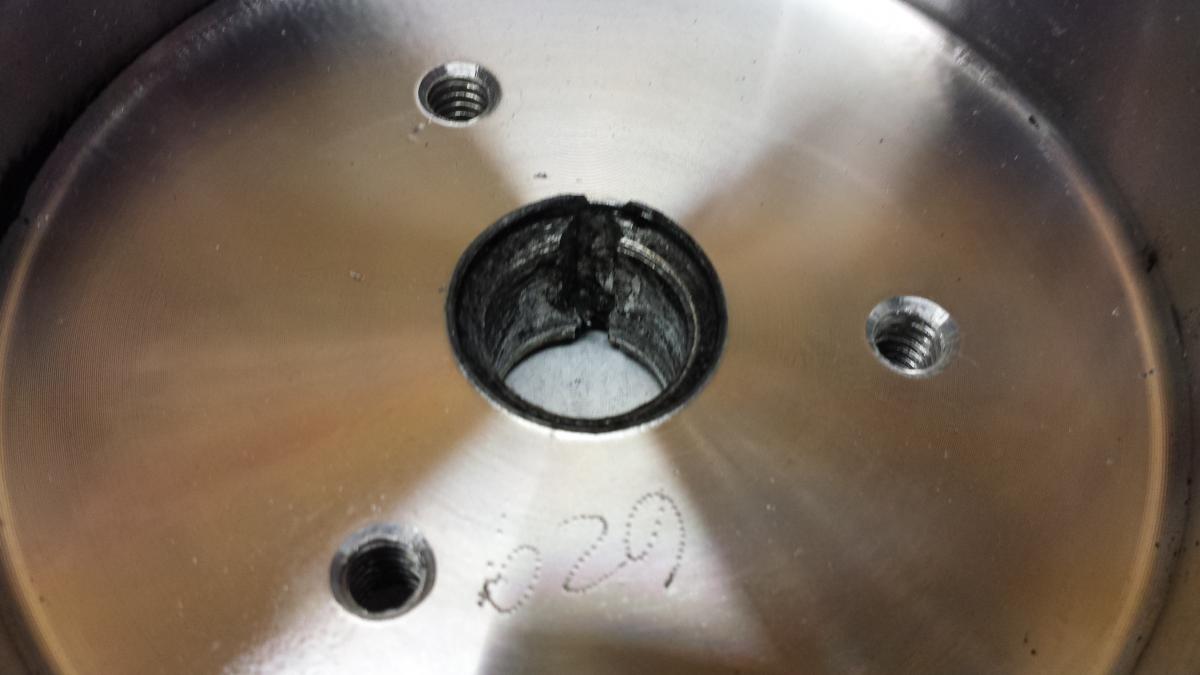

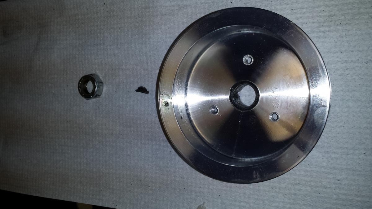

I got 80% of the way home and noticed my power steering feeling funny so checked the level and topped it up.  I started it up to see if the level would go down and I found that my power steering pump pulley lock nut had come loose and the pulley was wobbling wildy.  I was able to get what little woodruff key I had left in place and tighten it back down to keep going but was very close to being stranded if the key had broken or I had not been able to find it as I fell out when I took the pulley off.
At any rate we made it home with 6 stops to keep checking it but it never got loose again in the last 2+ hour drive home.  Just like my many issues I had at the meet that got taken care of thanks to the help of the group this one had me worried but got through it as well.
Has anyone ever had their power steering pulley come loose??  This can't be common but perhaps due to the serpentine system I have it was something I should have checked but never did.  I am sure it came from March with the pulley already attached.

When I get the replacement parts I will put another nut on behind it and loctite them both.  Not something I could pull out of a junkyard if it happens again.
