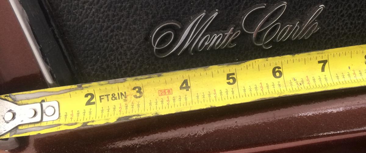

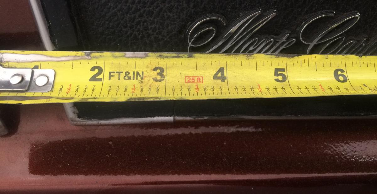

monte70car Posted August 21, 2015 Posted August 21, 2015 Try this, they do not show the pin location but will give you an ideal on where the script goes. The first and last are taken from the drip rail chrome, the second one is taken from the top of the quarter panel 1
