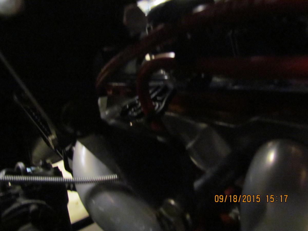

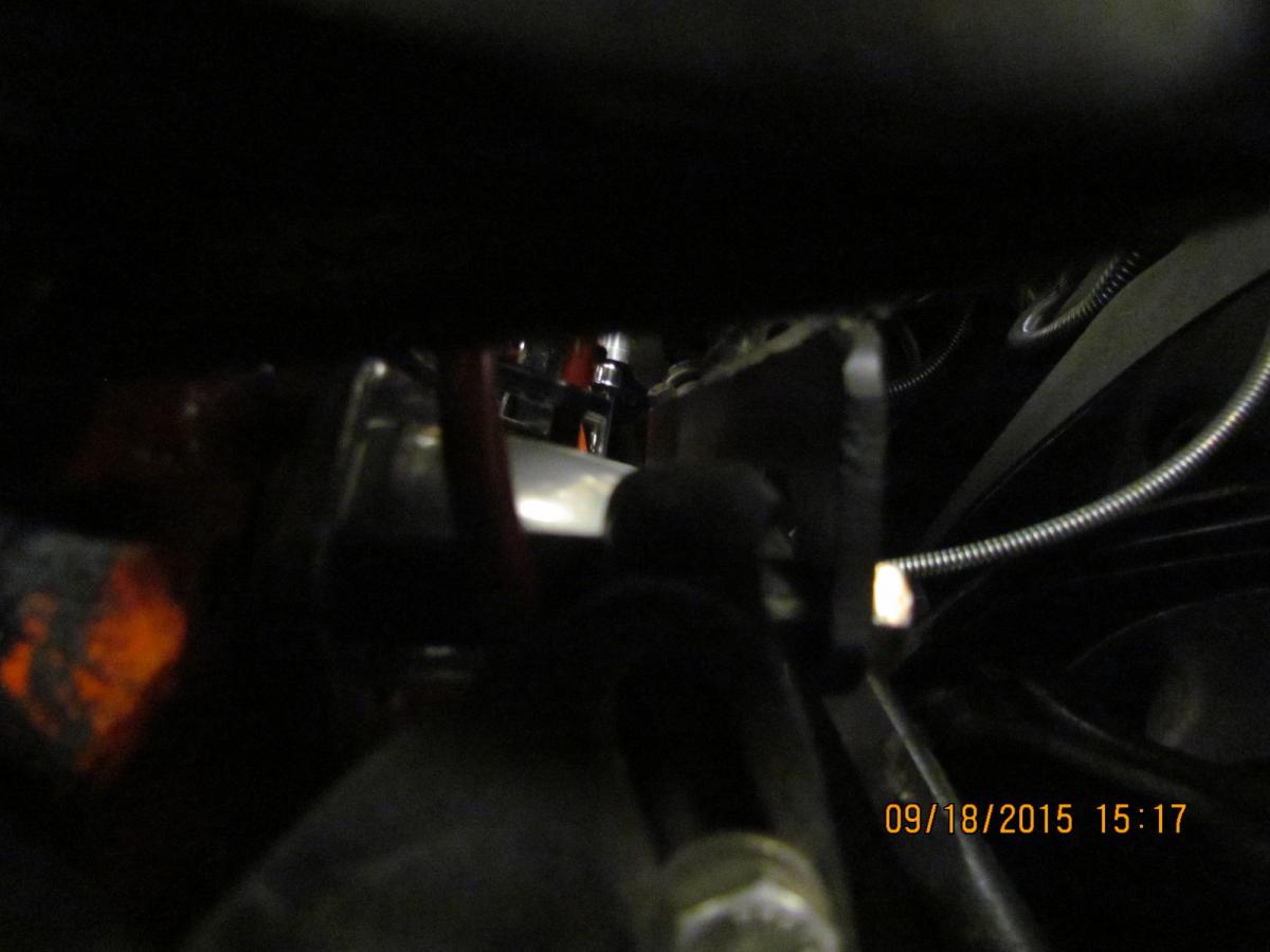

Yes I have the A/C compressor in the original location. I had a special bracket made for the lower rear A/C mount to attach to. The new bracket spans the second to third bolts holding the header to the manifold and a spacer for the compressor and another for the power steering pump. I will try and get a photo of said bracketing in a day or two. I had sinus surgery on Tues and am just now starting to get around. You might remind me after this weekend to get he photo.

I tried to get wome photos of the special made A/C bracket. If you look closely you can see where it spans the header tube over number one cylinder. The pic are not the best but it was hard getting the camera down into that tight area. I had to make special spacers to go behind the bracket for the header bolts to attach to the head. I hope these help you. The guy who made my bracket is a really good fabricator and can make about anything.
