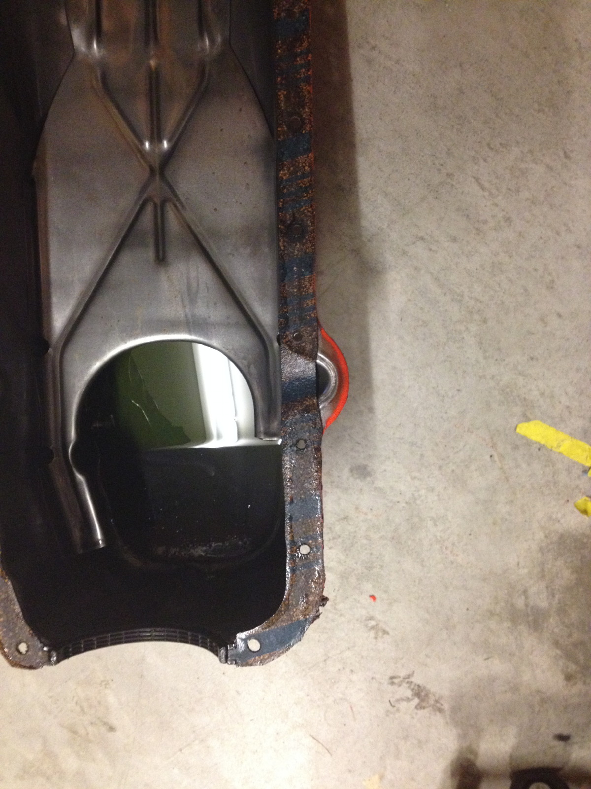

Got the pan off early this morning and then Glendia decided we needed to go and visit Alissa our granddaughter. Attached are the reason for the pan leakage. That is a very good reason that the Monte when I put the pedal to the metal I looked like a mosquito fogger.
The guy that rebuilt the motor put everything on it but the carb, torque converter, headers, dist and water pump. A very big oversight to my way of thinking. Oh well the engine does run great except for the oil leak that the new one pc. gasket will fix.
