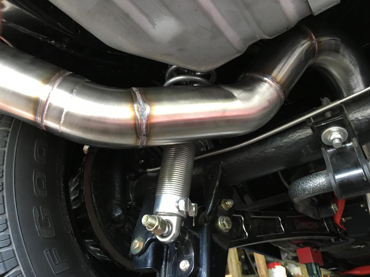

snomobeelr Posted June 25, 2016 Posted June 25, 2016 Good job. It may be quite a pain but I think it is worth it. I forgot about all that fun. I also had an issue with the lowers because of the type of trailing arm I used. I had to grind the head of the nut down a bit. To top it all off my 3 inch tailpipes wouldn't work after installing the rear shocks. Quote

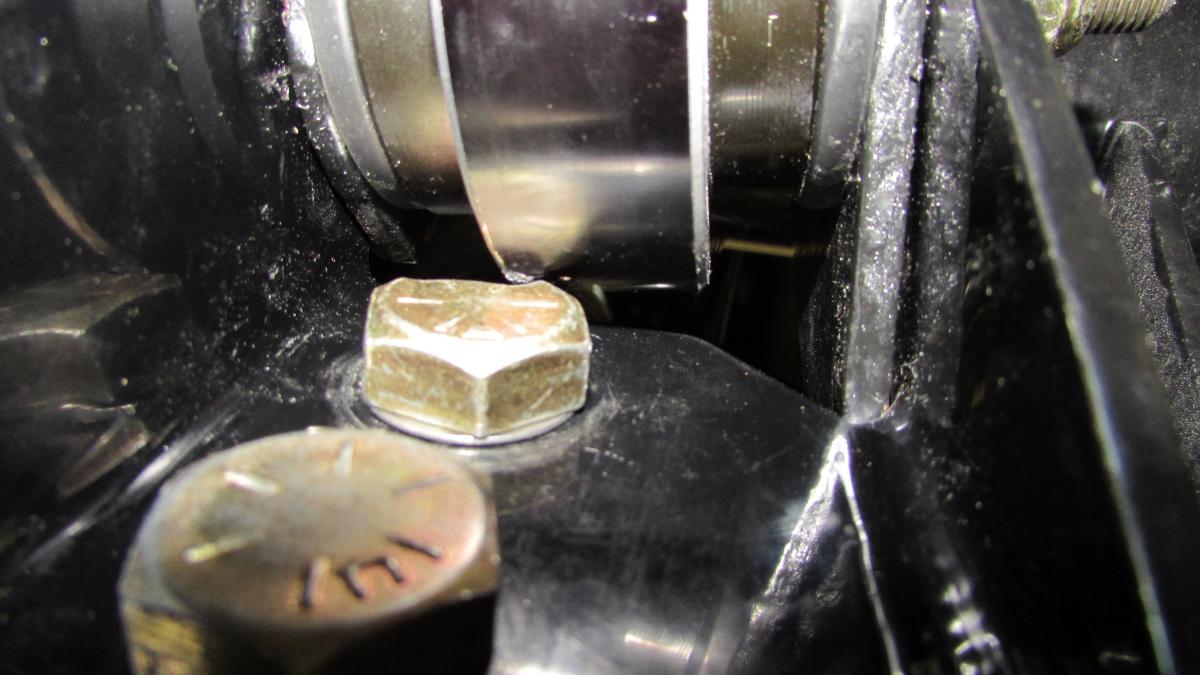

snomobeelr Posted June 29, 2016 Posted June 29, 2016 Glen just saw you asked about that bolt. I had an issue with the lower control arm. The head of the bolt was interfering with the the Control arm. I had to grind the head of the bolt a bit . You need the bolt if it is the one I am thinking of. Attached some pic's Quote
Rock Posted June 29, 2016 Author Posted June 29, 2016 Glen just saw you asked about that bolt. I had an issue with the lower control arm. The head of the bolt was interfering with the the Control arm. I had to grind the head of the bolt a bit . You need the bolt if it is the one I am thinking of. Attached some pic's I am talking about the upper one on the side we had to drill a hole for. Quote
snomobeelr Posted June 29, 2016 Posted June 29, 2016 Glenn , I believe you do need it. I ran into issues too so don't get discouraged. Took me a while. Turned out with the shock moving outward, my 3 inch tailpipes that came with my Torque tech kit no longer worked. I had to get custom tailpipes made. Here is a picture of the bottom Mount on my car. I can get more if you need. just let me know. 1 Quote

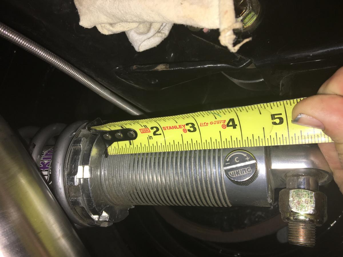

Rock Posted June 29, 2016 Author Posted June 29, 2016 Glenn , I believe you do need it. I ran into issues too so don't get discouraged. Took me a while. Turned out with the shock moving outward, my 3 inch tailpipes that came with my Torque tech kit no longer worked. I had to get custom tailpipes made. Here is a picture of the bottom Mount on my car. I can get more if you need. just let me know. I see you really ran the spring base way up the shock too. What is your ride height at when measured from the ground to the top of the wheel well? I thing mine is set at 25" I think I would like another 1" but I only have a bout 2" of thread left on the shock. Quote
snomobeelr Posted June 30, 2016 Posted June 30, 2016 I believe its 25.5 to 27. I can't measure it right now. It s up off the ground trans went last friday so its up off the ground I had to pull it out.. When I get it back in and on ground I will let you know. Quote
snomobeelr Posted June 30, 2016 Posted June 30, 2016 I measured the bottom spring mount to the last thread is 3.5 inches. See picture 3. 1 Quote
Rock Posted June 30, 2016 Author Posted June 30, 2016 That bolt in question looks pretty tight against your control arms. The problem I see with mine is they are boxed square and looks like it will hit the bolt head and could possibly gouge the control arm. I am going to look around to see if I can get some low profile bolts. The old control arm wouldn't of caused problems but these UMI control arms are wider. If I can't I will do what you did and grind the heads down a little. In this pic you can follow the control arm edge back and it is in line with the hole I drilled. Quote

Rock Posted July 1, 2016 Author Posted July 1, 2016 Well I installed the 2 bolts for the lower bracket. I think the bolt heads will clear without binding the lower control arms. I also measured my threads and I come in at 2 3/4" so when time permits I will adjust them up another 3/4" and see where I am at. Fun stuff! Quote
