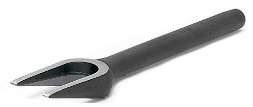

All you need is a ball joint separator post-1188-0-44958200-1467399928_thumb.jpgand a hydraulic jack to do the front springs. I replace both my front springs and shocks with Viking coil overs in less than 3hrs.

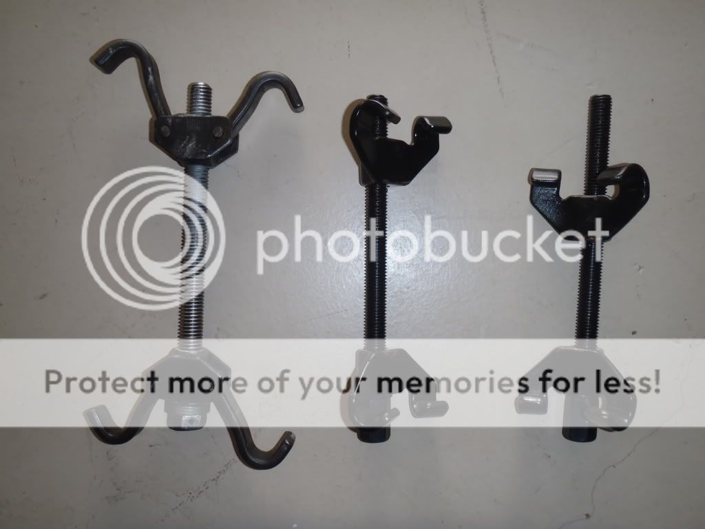

As a minimum, I suggest you borrow, rent or buy  inside and outside spring compressors and ball joint/bushing removal and installation tool kit. Outside spring compressors are useful for removal but not for installation. You can actually borrow any/all of them for free (refundable deposit required) from Advance Auto.
