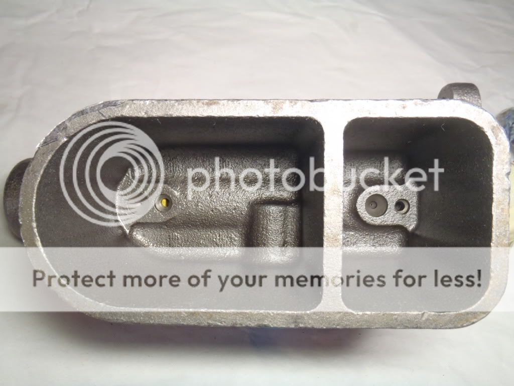

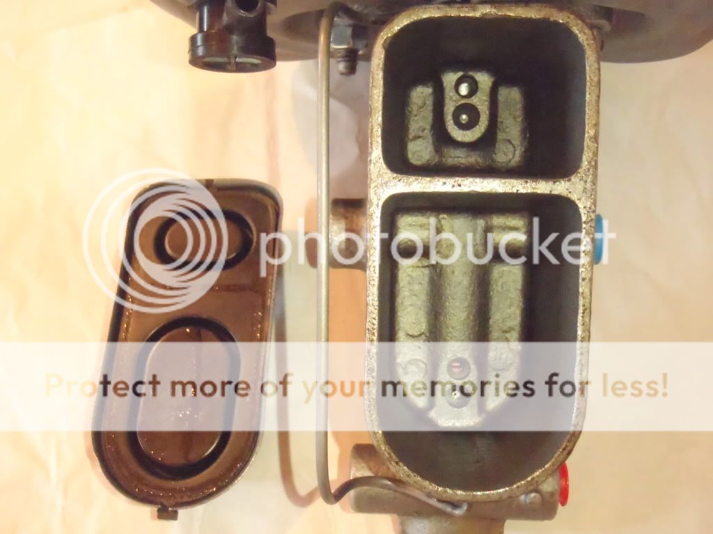

MCfan Posted November 10, 2016 Posted November 10, 2016 I had a similar bad experience with a "new" (actually re-manufactured) master cylinder. Although Bendix and Delco Morraine master cylinders were both used on our first gen Montes (and they use the same mounting bolt pattern and line connection ports), they have different internal pistons and require different length actuator rods through the booster. The first Bendix master cylinder I purchased was a complete assembly with a new booster attached so that was all good. The problem was that the internal piston used for the rebuild was the wrong one so the supply port in the rear brake chamber was never exposed to an opening during the normal piston stroke. (see first photo below) The front chamber primed and pumped well but nothing worked on the rear chamber. I exchanged that master cylinder for another re-manufactured Bendix and you can see the difference in the rear chamber supply port in the photo below. Just can't assume that all "new" replacement parts will work. Quote
Rock Posted November 10, 2016 Author Posted November 10, 2016 I noticed the one I took off the piston was not the same as the one I bought but I recieved 2 different length push rods when I bought the new booster. When I bled the master both the front and rear ports were flowing fluid so I assume this one will work. Quote
