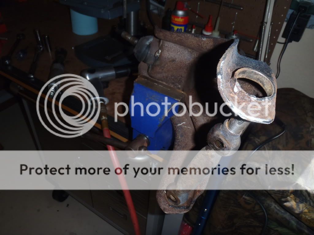

MCfan Posted December 30, 2016 Posted December 30, 2016 Hi, carguy, Your post is definitely in the correct section of the forum (although probably no one would get upset if it wasn't). It is very common for both upper and lower ball joints, as well as, the control arm bushings to be shot in a Monte that has already been driven a good many miles without a front suspension rebuild. If you are sure the upper control arms need to be replaced (or rebuilt), there is a good chance that the lower control arms are in a similar condition so you won't achieve a stable front end condition unless the lower control arms are also replaced or rebuilt. I don't know if you have the time, skills and tools to do either a replacement or a rebuild of the front control arms, but I have done it on each of my '70s and it is a major (and somewhat dangerous) task. Here's a link to a photo journal for one of my projects if you want to get an idea of what is involved (whether you do it or have it done): Front Suspension Rebuild I noticed the parts you are looking at recommend professional installation so it is going to cost you if you can't do the work yourself. If you are going to have it done, it would be wise to have all of the bushings (upper/lower control arms and anti-sway bar), ball joints, tie rod ends, travel stop bumpers and possibly the idler arm replaced at once. The other things to consider are replacing include the shock absorbers and/or the front coil springs if they are sagging since it requires no additional time or effort while doing the other work. Any rebuilding or replacing you do in the front suspension will likely require a new wheel alignment job so it's best to do it all at once, if possible. There are several quality (i.e. Moog) complete front end rebuild kits available from classic car suppliers like The Parts Place Inc, Year One, Original Parts Group (in a pinch), as well as, Summit, Jegs and many others. Of course, complete parts kits are also available on ebay but they are often sourced out of India or China so beware of the quality. You pretty much get what you pay for. Lots of our members have experience with the tubular after market control arms that you are looking at and they can advise you better than I. One consideration is how original you want to keep your '71. You can still buy new original style upper and lower control arm assemblies (i.e. from The Parts Place Inc.) if you want to replace them rather than rebuild them. If you don't care about keeping your '71 more original, the tubular ones will work for you although you probably don't need them for a daily driver. As you can tell, a project like replacing upper control arms can (and probably should) "snowball" into a complete front suspension rebuild. To keep the snowball rolling, this would also be a good time to service or replace front wheel bearings and front disc brake pads (and possibly rotors). Well, others may give you different/additional advice on this but that's my 2 cents worth. Good luck! Quote

MCfan Posted December 31, 2016 Posted December 31, 2016 Bruce, I don't know of any place that rebuilds control arms but you can buy stock replacement upper and lower control arm assemblies (including new ball joints and bushings) from The Parts Place Inc for $129.00 each. The upper left control arm is part number SU4840A and the upper right control arm is part number SU4841A. Carguy, if you decide to rebuild your current control arms, removing the old bushings and ball joints may be more challenging than installing the new ones. The original ball joints will almost certainly be riveted in place so an air hammer with a chisel point will make quicker work of the removal process. The old arm shaft bushings can be driven out with an air hammer with a blunt point. If you use a regular big hammer to remove (or install) the bushings, be sure to support the arm well so you don't distort the bushing opening or bend the arm. New ball joints bolt right on and new bushings are easy to install with a large vice and/or large hammer. After installing the first bushing in the upper control arm, be sure to put the arm shaft in place before installing the second bushing or you will get to do it twice. If you don't have a ball joint/bushing removal & installation tool set (see photo below), you can rent them or even borrow them from parts stores like Advance Auto (especially if you buy your new parts there). These tools make the job easier and safer so it's worth your time to rent, borrow or buy one. You may well be money and time ahead to buy complete control arm assemblies (whether stock or tubular) but it will still be a big and somewhat dangerous job to replace your current upper control arms. Be careful and good luck! Quote
ripleydale Posted December 31, 2016 Posted December 31, 2016 After mutilating some control arms removing and installing bushings, I found a great simple tool from Ridetech they call Bushing Installation Remval Tool, part number 85000009. It's $100 but removes and installs pretty easily. Lower ball joints remove easily with tool from your local parts place and the uppers are just some time and effort to remove the original rivets (quite a few posts on that process). Make sure you look the control arms over carefully so you don't spend time on something that is worn or cracked. Quote
