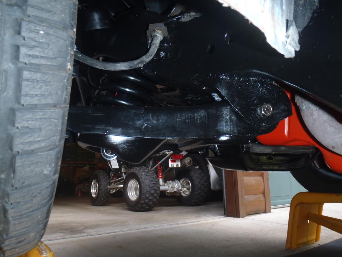

Without a lift, the only way I could get close to normal weight and height on the front suspension while I torqued the lower control arm bolts in place on the frame was to put the front wheels of the car up on ramps (see photos below)  Even so, it was a challenge to tighten those bolts while laying on my back and trying to read my torque wrench.  But, if you don't do that, your front suspension will be improperly pre-loaded and biased to sit too high.  I suspect driving it that way will also severely stress and possibly damage your new lower control arm bushings because the rubber bushing centers weren't designed for that much torsion.

Kris, I would wait until the fenders and hood are on to torque the lower control arm bolts.  In the meantime, why don't you just loosen them and see if the front end drops any at all?
