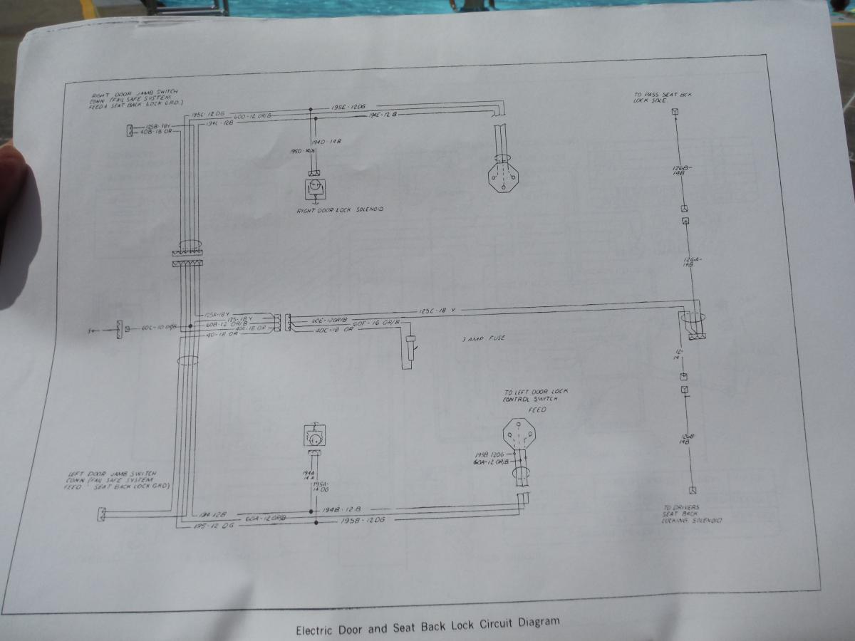

Hi I have a 1972 Monte 402 car
 Can you email me the power window circuit , every time I print its to grey to read. Maybe if you can scan to email it will print clear.
Mike,
I have individual photos of the 14 pages of the 1970 Wiring Diagram that can be edited for brightness and contrast.  I just sent you the page containing the Power Window diagram via email (also shown below).
I am not certain that it is the same diagram for the '72 but I installed a complete power window setup from a '72 into one of my '70s and everything appeared to be the same.  Good luck.

In the eleventh photo we can see the diagram of the electrical routing for the power windows, and in that diagram we can see the window switch supply voltage comes from the 14AWG red wire with white tracer. Do you know where that wire is fed it’s voltage from? I have the manual that these are pictured from and can’t find where this wire is supplied voltage.
I’m trying to clean up some of the wiring in my engine bay and there is a 10 AWG orange wire with a black tracer that taps into the battery positive side of the horn relay then runs to a junction block on the firewall near the emergency brake mounting location, from there it attaches to what’s shown on the electrical diagram as the folding top switch, as my Monte does not have a folding top it attaches to a 1 to 3 splitter under the dash, gets wrapped up in the harness and then there is a 6 pin connector that runs down to the rear windows through the floor. It doesn’t show the orange as supplying the battery voltage to the windows but with this unplugged the windows do not operate.
