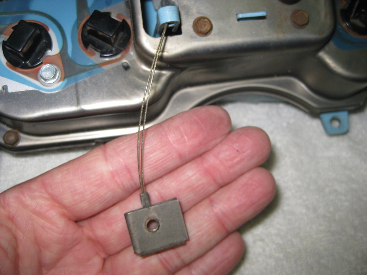

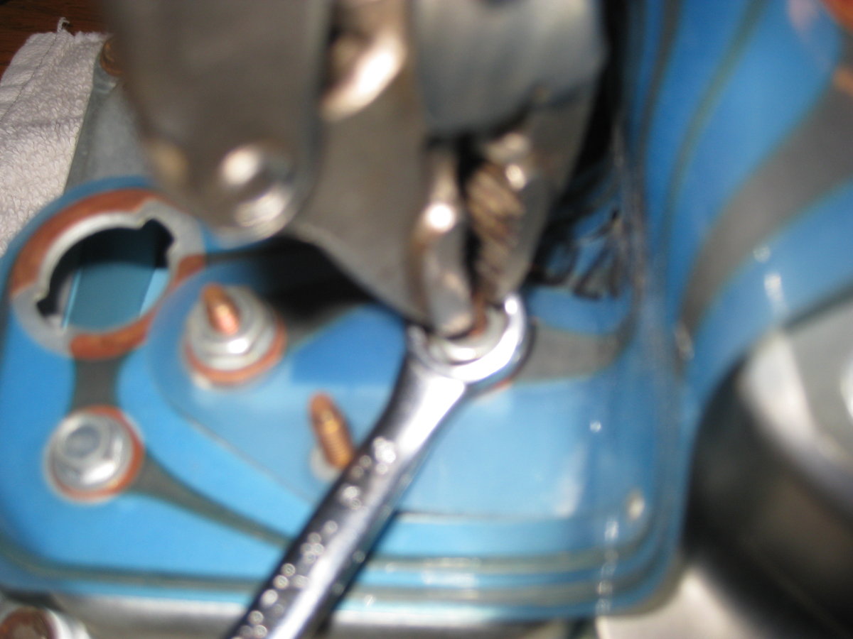

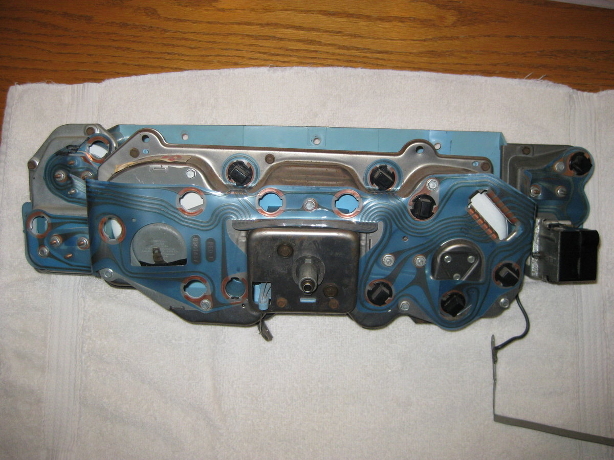

stangeba Posted December 17, 2018 Posted December 17, 2018 (edited) May help some: 1-If you have a column shift, THIS MUST BE REMOVED or you will break it! (If you ever remove the dash) 2- Picture of the back side with gauge package (1971) 3- I believe this is the AMP gauge and the nut was very tight, I used a small locking pliers, to keep the gauge from breaking. Edited December 17, 2018 by stangeba added text Quote
