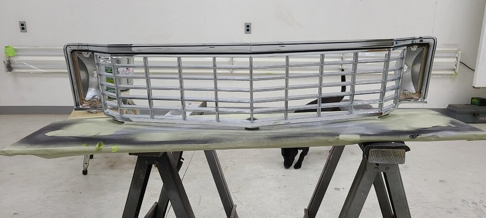

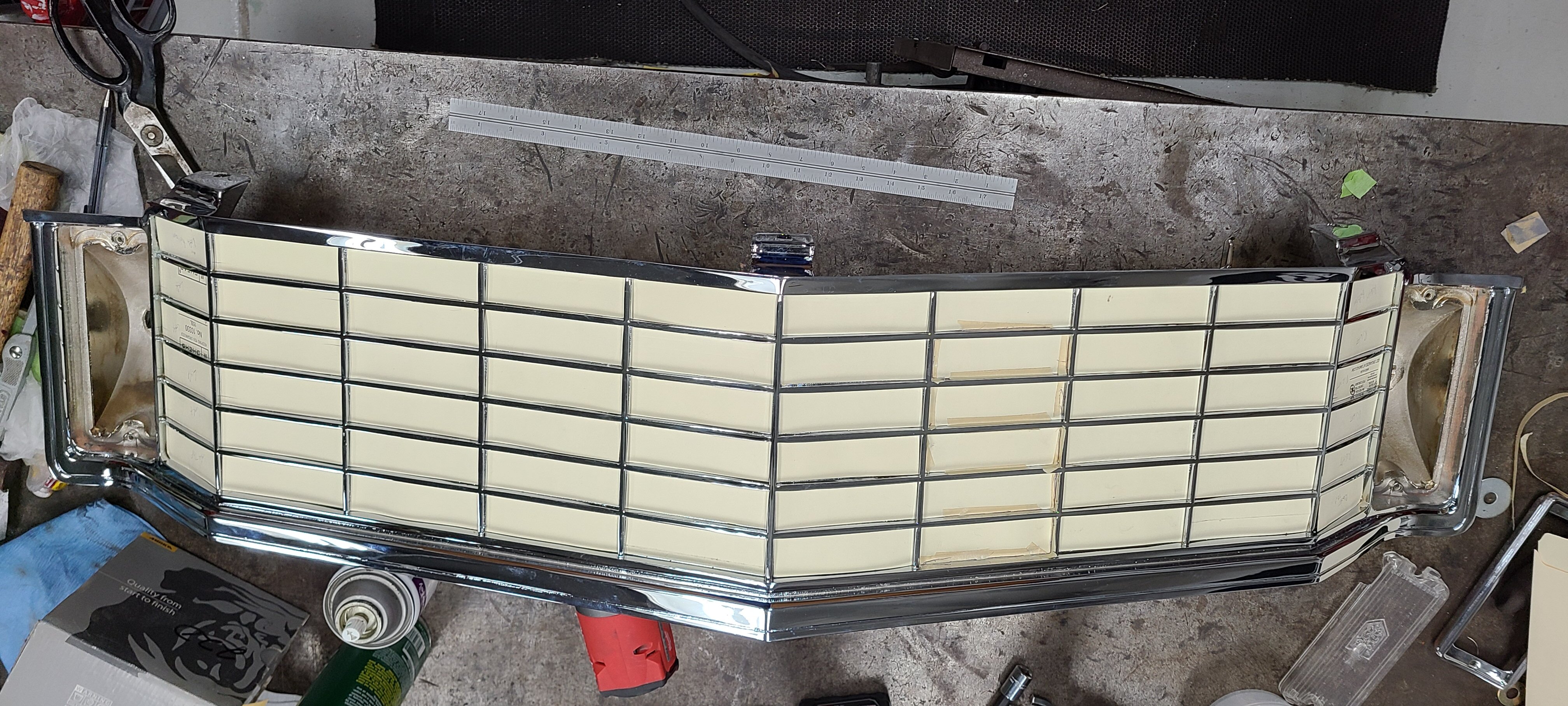

jft69z Posted October 11, 2020 Author Posted October 11, 2020 Still putting things on the car, but haven't lined up the front sheet metal. Got the stereo, sub-woofer & speakers all hooked up. Today's fun was to paint the bullet style passenger mirror & the front grill. The grill took the better part of the day and was, well basically a suck job. First had to fill some of the pits that were still in the inner areas. Then cut out 60 pieces of manila folder to mask the chrome front so I could paint the rest Argent Silver. Also painted the front signal & tail light bezels black where they needed to be done. Been dreading this day, but figured I might as well just do it and be over with it, sort of. Turns out the grill I got from Jared a few months ago is actually in quite better shape, so it's at the chrome shop right now. I'll use this grill for now, but will turn it into a spare if something gets damaged on the better one down the road. This means I'll get to do this whole job again when the other one gets done in about 6 weeks. Time to buff out the hood and start lining up the front metal, bumpers, etc. next. 3 Quote
Dtret Posted October 11, 2020 Posted October 11, 2020 Wow the patience you must have. I would have paint everywhere and spent 3 days doing that and probably still launched it in the yard and ran over it with my tractor. And then have to fix the tractor. Well done 1 1 Quote
jft69z Posted October 11, 2020 Author Posted October 11, 2020 25 minutes ago, Dtret said: Wow the patience you must have. I would have paint everywhere and spent 3 days doing that and probably still launched it in the yard and ran over it with my tractor. And then have to fix the tractor. Well done I learned a long time ago not to throw things, that just doubled the work, Lol. It certainly sucked though, and left me with a stiff neck this morning from all the sanding and masking those holes at odd positions. Quote

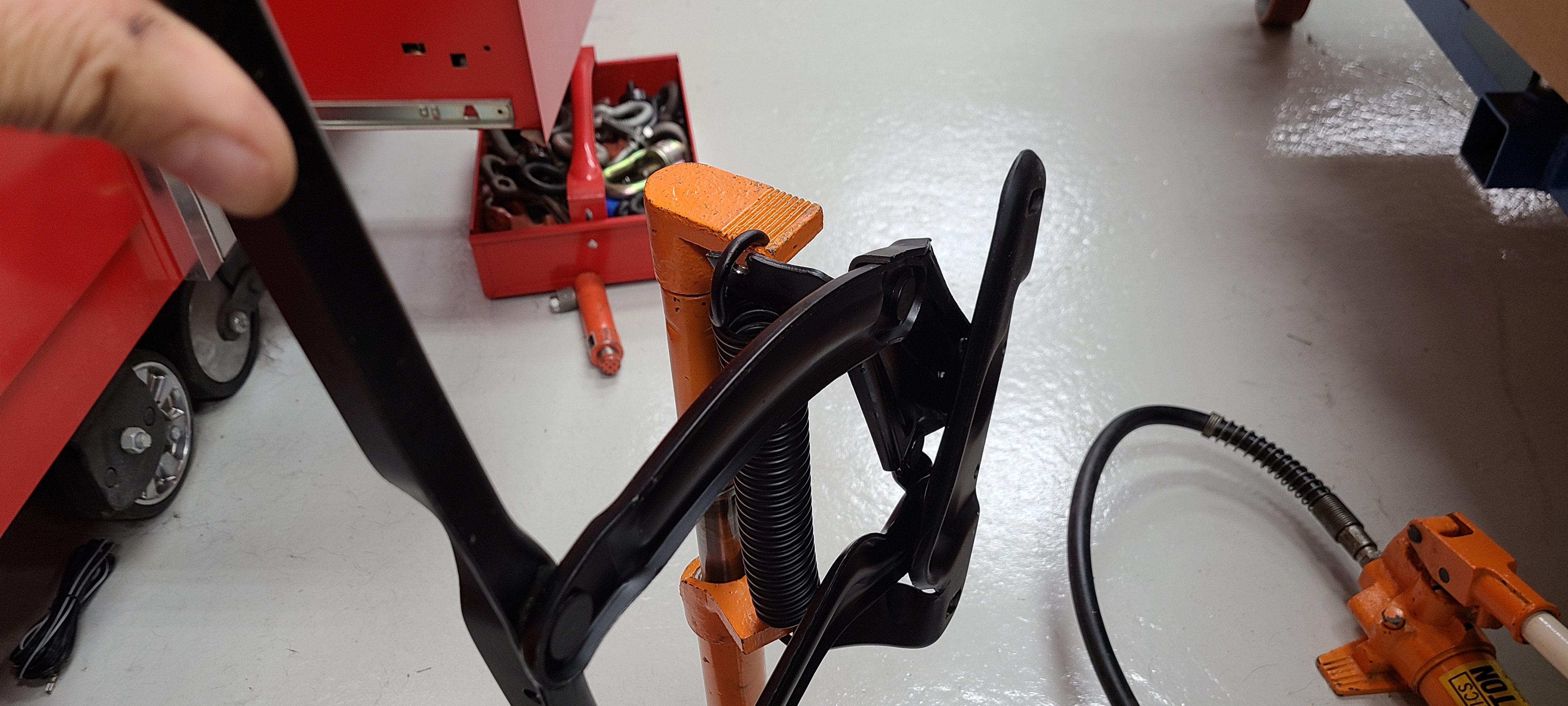

jft69z Posted October 14, 2020 Author Posted October 14, 2020 Got most of the interior bolted down. Left the door panels and dash pad off for now in case the windows/doors need any more adjustments after putting the hood on, or any more little things under the dash. Fenders are lined up enough to get the hood placed, just waiting for some help to move it around. Also put some lower trim on last night, trying to make sure it will line up the entire length of the car. Also used the porta-power to put the springs on the hinges. Easy money, no drama. 2 Quote

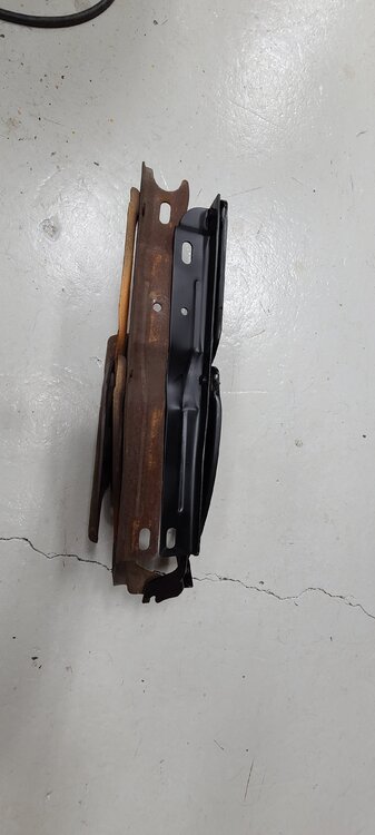

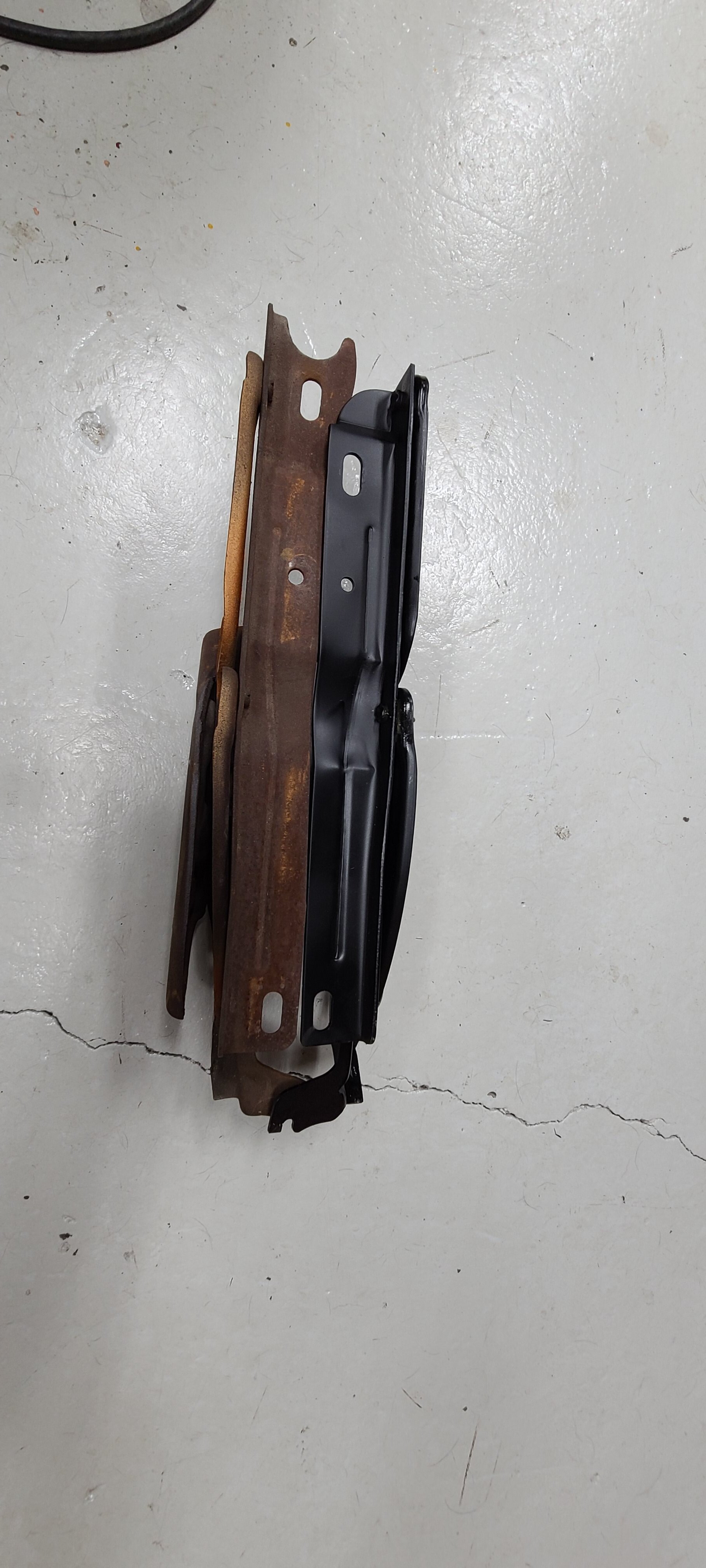

jft69z Posted October 15, 2020 Author Posted October 15, 2020 So, true to form....tried putting the hood on today & it won't bolt up to the Ames hood hinges. Square peg/round hole as far as the hood bolt slots. Got a call into them, they're checking to see if the wrong ones maybe got shipped. Looking at online pics of it though, may not work. My buddy says, "surprised You didn't find that earlier, you check everything". Told him I didn't think I needed to in this case. Another kick in the sack. Knew I shouldn't have said anything yesterday about the hood being no big deal.... Quote
Dtret Posted October 15, 2020 Posted October 15, 2020 1 hour ago, jft69z said: So, true to form....tried putting the hood on today & it won't bolt up to the Ames hood hinges. Square peg/round hole as far as the hood bolt slots. Got a call into them, they're checking to see if the wrong ones maybe got shipped. Looking at online pics of it though, may not work. My buddy says, "surprised You didn't find that earlier, you check everything". Told him I didn't think I needed to in this case. Another kick in the sack. Knew I shouldn't have said anything yesterday about the hood being no big deal.... Ouch. Mine is coming Quote
jft69z Posted October 15, 2020 Author Posted October 15, 2020 30 minutes ago, Dtret said: Ouch. Mine is coming Hopefully not, nobody can have as much bad luck as I've had on this project. I must have been a much bigger a**hole in my prior life than even now, for the bad karma to keep biting me, lol Quote
DragCat Posted October 15, 2020 Posted October 15, 2020 Damn dude, will it ever end ? 😲Now this Karma cloud gives me another reason NOT to park next to you, and do me a favor loose my number 🤣 Quote
jft69z Posted October 15, 2020 Author Posted October 15, 2020 24 minutes ago, DragCat said: Damn dude, will it ever end ? 😲Now this Karma cloud gives me another reason NOT to park next to you, and do me a favor loose my number 🤣 Sure, kick me while I'm down Mark, lol. Chances are, if you parked next to me, my car would spontaneously combust and burn them both down at this rate anyways. I ordered a set of AMD (my favorite place..remember the bumper debacle?) hinges from Summit, hopefully they'll be here in a day or so. Really a kick in the butt though as I needed the hood on to line everything else up. After that, it was a spin around the block to see if it drives ok. No doubt a drunk driver would smash into me as I turn the corner though, so at least I'm putting off the inevitable for a few more days, hahaha. Quote

jft69z Posted October 17, 2020 Author Posted October 17, 2020 Thanks Dennis! I used the AMD hinges. Not quite as nice as the Ames ones, but then again, these fit a Monte. Still had the bend them a bit, not exactly perfect out of the box, but they work fine. Actually, that's the dog who ate a throw rug in the house yesterday, still a little annoyed about that, but love her just the same. I'll keep an eye out, Thanks! Quote
