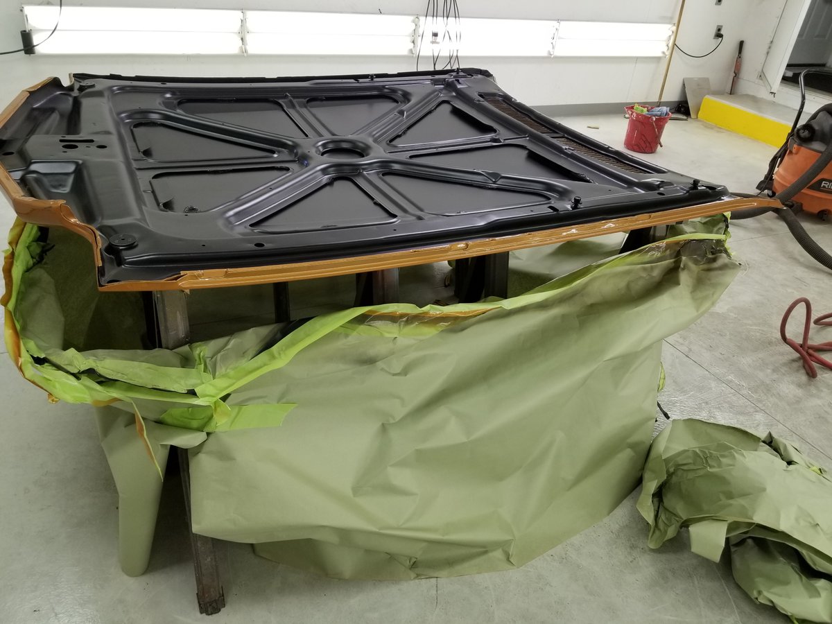

jft69z Posted September 30, 2019 Author Posted September 30, 2019 Spent a good part of the day cleaning up the back side of the hood & turning it black. Couple more hours with the sandblast cabinet cleaning stuff for tomorrows festivities. 1 Quote
cny first gen 71 Posted September 30, 2019 Posted September 30, 2019 That came out nice, what did you use on it? 1 Quote
Rob Peters Posted September 30, 2019 Posted September 30, 2019 Joe, You are doing beautiful work on your car. I can't imaging a much more difficult thing to work on than the underside of a hood. There are so many nooks and crannies that you could cut your fingers on and the vents toward the back of the hood are a real pain. You are putting so much detail in the underside of something that won't get a lot of attention but if you don't do it the detail on the rest of the car would draw attention to what you don't. I do hope you will consider bringing it to Carlisle for the 2020 Eastern Meet and the celebration of 50th anniversary of Monte Carlo. We would love to see the amazing work you are doing now. What an opportunity for you to show it off in the presence of over 50 other First Gen Monte Carlo's in one place. rob 1 Quote
jft69z Posted September 30, 2019 Author Posted September 30, 2019 Thanks guys, appreciate the kind words! Steve, for the black, I initially was going to use DuPont Centari with hardener & flattener. Used it in the past with good results, but my paint jobber told me a lot of his customers were using a product named 'Hot Rod Black' from Distinctive Image (DI-HRB). Mixes 4:1 with activator & it's a urethane. Checked it out in person at another buddies collision/restoration shop and liked it so I bought a gallon. Goes on like butter, dries nice & seems durable so far. I masked it off the very next day to shoot some color on the body and no imprints or pulling away from the tape. Yeah Rob, that back side of the hood was a mess. Leather gloves are the trick to keep from getting all cut up, lol. I plan to put the hood insulation on which will hide most of the work anyways, but if I don't at least it will look presentable. If I didn't do it all, I would know what was under there & it would bug me. Like putting lipstick on a pig.... It's not a show car, or a 100% original restoration, but I just couldn't live with the whole underside/frame/engine compartment the way it was. I knew I was doing all this before I bought the car though, so it wasn't a surprise. Years ago I had my Camaro for 2 whole hours, then backed it in the garage and started unbolting it. My next dilemma is what color to paint the front bumper filler panel. I know it's supposed to be argent silver, but am steering towards body color. I did a quick search here & it seems near even between argent, body color & a few blacked out as well. Thoughts? Quote

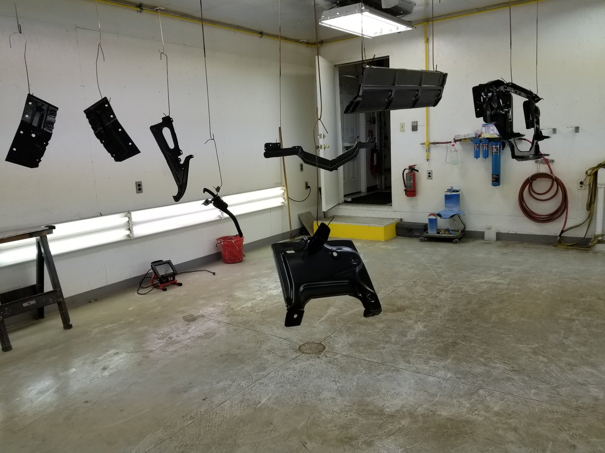

jft69z Posted September 30, 2019 Author Posted September 30, 2019 More parts to turn black after a little dinner... 1 Quote
jft69z Posted October 1, 2019 Author Posted October 1, 2019 Semi-shiny and black. Almost ready to go back to work to relax after the last couple of 80+ hour weeks. Wanted to get the frame & suspension broke down and painted but all this other stuff needed done eventually, so that's how it played out. Probably move some cars around tomorrow and start to clean up the pig pen of a shop and then start on the frame. 2 Quote

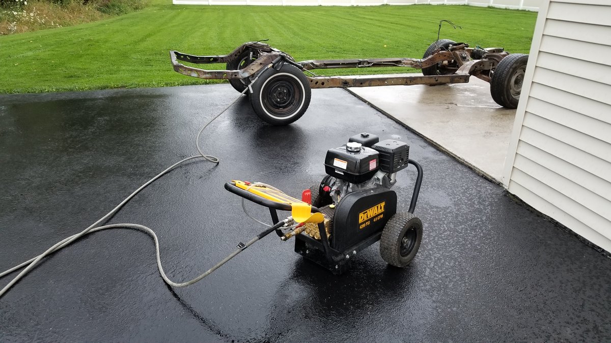

jft69z Posted October 1, 2019 Author Posted October 1, 2019 Sandblasted & turned more parts black today & got the front bumper filler plate in silver. Nothing screams fun like pressure washing the frame in the rain. Wanted to get some cars moved around and get the frame inside before the rain came, but didn't happen. Looks like it may be out there for awhile, supposed to rain solid for a couple more days. Quote

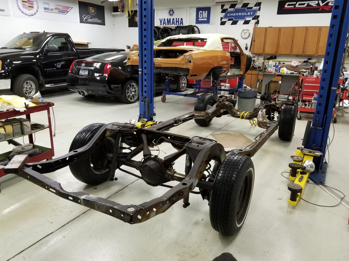

jft69z Posted October 2, 2019 Author Posted October 2, 2019 Rain stopped for 4 minutes, put everything back where it belongs....sort of.... Quote

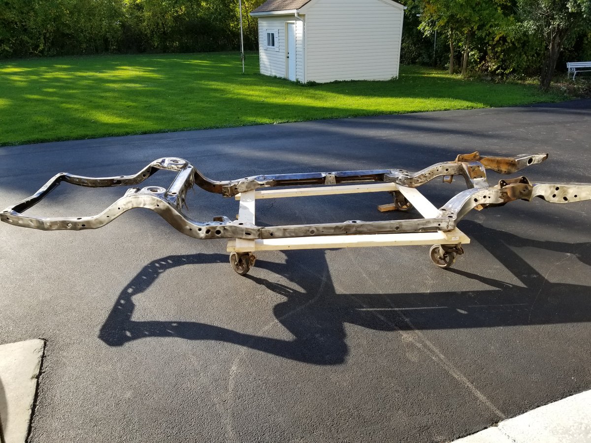

jft69z Posted October 8, 2019 Author Posted October 8, 2019 Off work this morning from the night shifts & back tomorrow days for awhile. Had a little time to break the frame down though. There's a picture to show how not to lower your car....with a torch to the front springs. Another with the "rolling chassis". 1 Quote
Rob Peters Posted October 9, 2019 Posted October 9, 2019 Were you trying to cut the springs? You succeeded in warping them. The spring compressor is truly a life saver on removing those front springs. Even with a spring compressor it scares me a little. Keep up the good work, I can almost see it in black paint already. Keep the pictures coming. rob Quote
